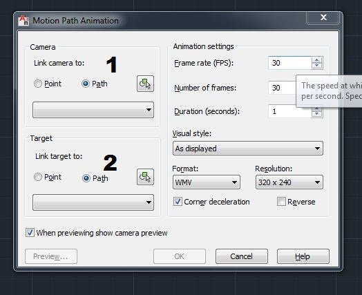

    after finished your design . write command ANIPATH in command bar.after open the command u can see new window like this on your screen .in part 1 u most select 1 point or make line in your skim because camera watch line to make film( make camera shot ) .then in part 2 u most make big line or ... to make camera movement line then press ok to make film or 3d from skim.
