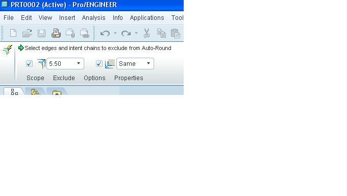

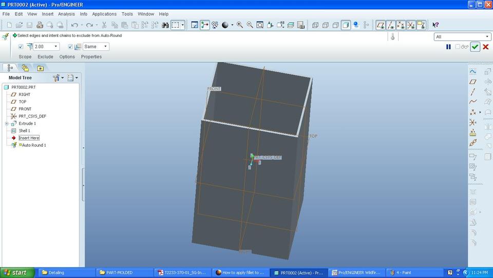

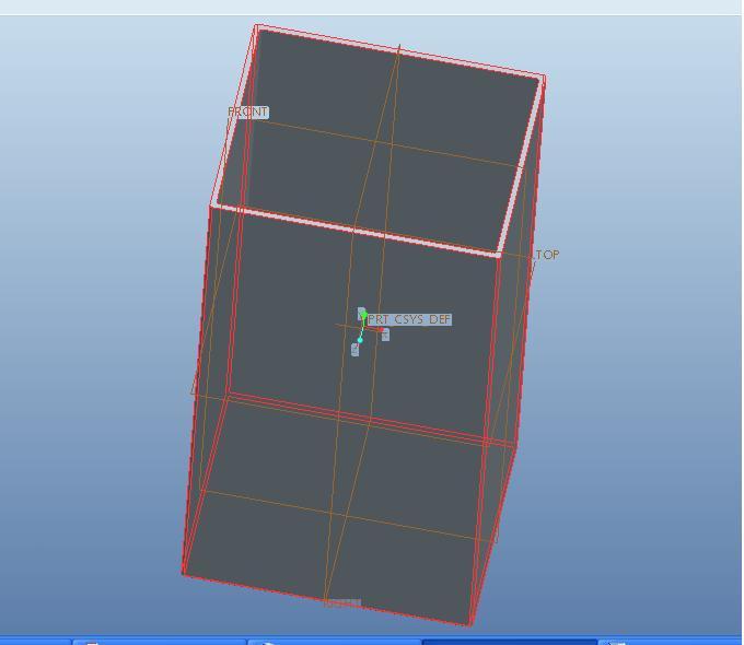

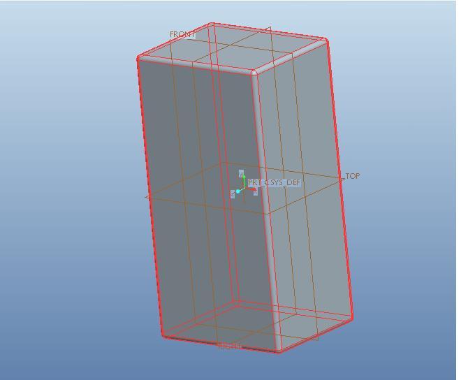

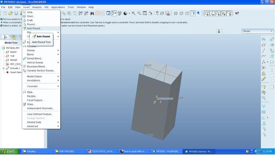

    Nice tutorial; but I would prefer to use "Auto Round" command from Insert tab, s it is useful for complicated structures as well.
  • Saurabh MIshra
    Saurabh MIshra 8 months ago
    GREAT MAN........PLZ TRY THIS ON THE SAME MODEL AS Venkatasubramanian HAS MADE
    MAKE THE SAME MODEL AND GO TO INSERT>AUTO ROUND COMMAND GIVE THE RADIUS U REQUIRE, AND THE CLICK THE OK BUTTON ALL EDGES WILL BE ROUND AS PER YOUR RADIUS.
    AND IF ITS SHELL OBJECT THEN THE SAME COMMAND THERE IS USED SAME OPTION AS IN IMAGES IT IS SHOWN.....
