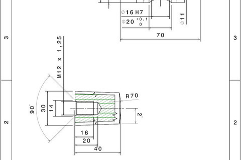

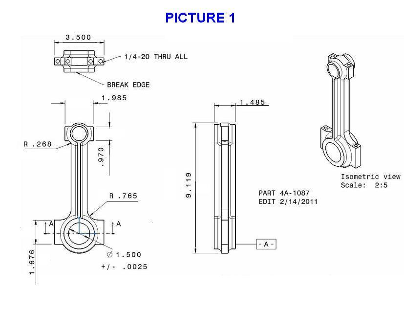

Please tell me how to change the dimensioning system on CATIA
from along the direction system(medium.jpg) to unidirectional system(connecting rod.jpg)

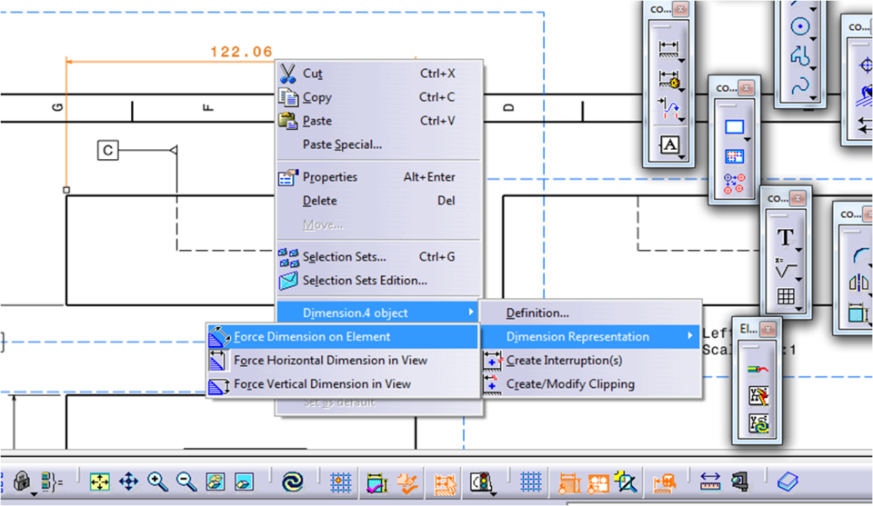

    I am not able to understand Ur Question completely. But still I think this might be the solution. Am not sure.
    Select the Dimension -> Right Click ->Dimension.Object -> Dimension Representation here U will see few option. Try vertical,Horizontal or Aligned.
    If it's not what U were looking for, then Please elaborate ur Question.

    as you see in the images i have added below

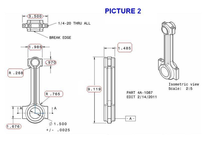

    In picture 1, the dimensions are aligned to the direction of dimension (Aligned Dimension system)
    In picture 2, the dimensions are on a same direction of dimension
    (Unidirectional Dimension system)
    how to get the dimensions like on the picture 2 whereas i getting the dimensions as in Picture 1 (by default)

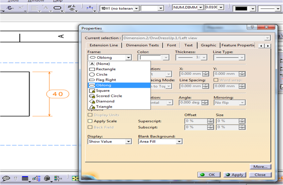

    I have attached two images which will explain what u wanted.
    Select the Dimension -> Right Click -> Properties -> Value Tab -> Set Orientation To Perpendicular as shown in image.
    But i don't know how to break the Dim line to set the value in middle. I will try to know the answer and will inform U.
