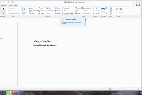

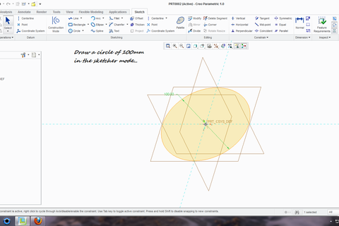

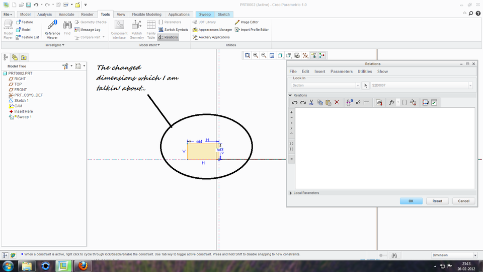

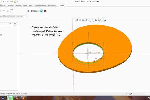

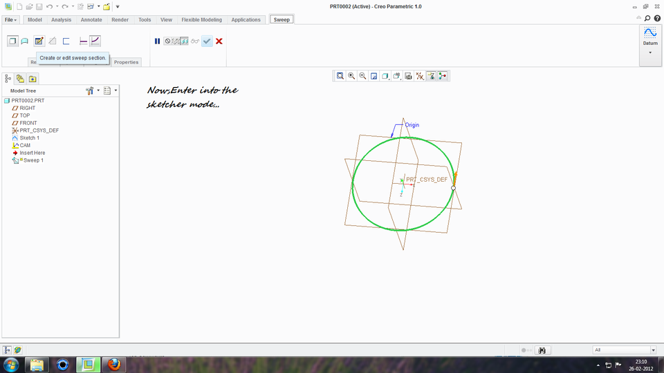

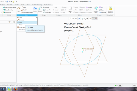

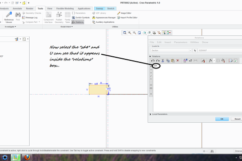

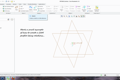

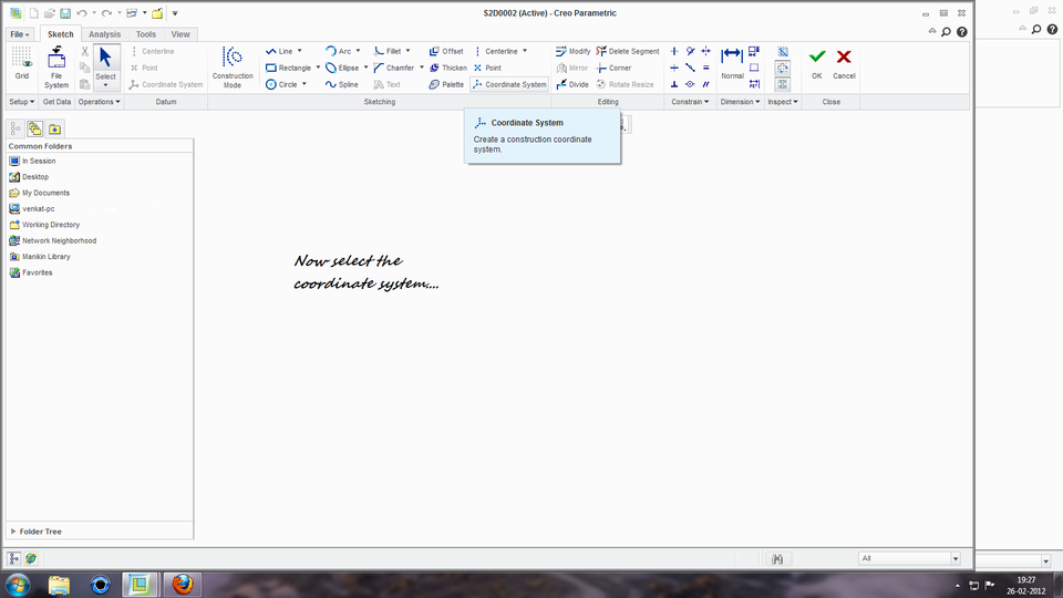

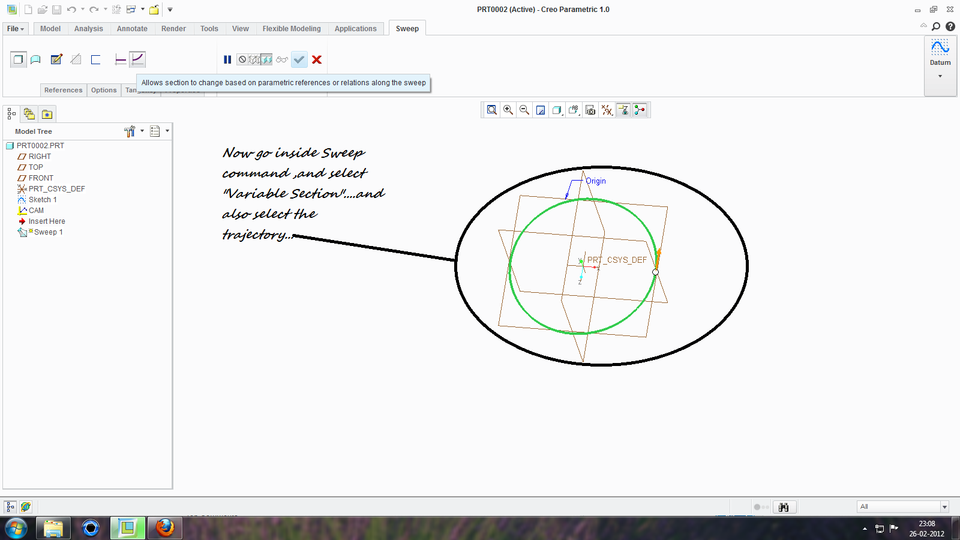

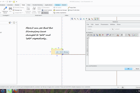

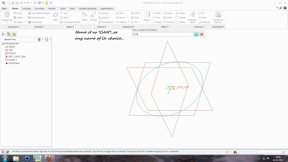

Here's the steps on how to create a simple cam profile using relations in proEngineer
3 answers
  • Venkatasubramanian
    Venkatasubramanian almost 3 years ago

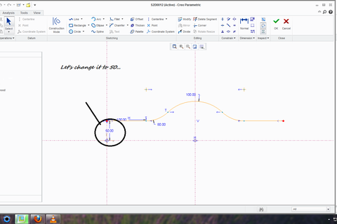

    Here's the answer...
    p.s.In the step-14 I 'd have changed the dimension to 50mm...so please implement it in the 6-th step also...instead of 40mm ,change it to 50mm
    1. Step 1
      Step-1
      Medium
    2. Step 2
      Step-2
      Medium
    3. Step 3
      Step-3
      Medium
    4. Step 4
      Step-4
      Medium
    5. Step 5
      Step-5
      Medium
    6. Step 6
      Step-6
      Medium
    7. Step 7
      Step-7
      Medium
    8. Step 8
      Step-8
      Medium
    9. Step 9
      Step-9
      Medium
    10. Step 10
      Step-10
      Medium
    11. Step 11
      Step-11
      Medium
    12. Step 12
      Step-12
      Medium
    13. Step 13
      Step-13
      Medium
    14. Step 14
      Step-14
      Medium
    15. Step 15
      Step-15
      Medium
    16. Step 16
      Step-16
      Medium
  • e19
    e19 over 2 years ago
    tracing point in mechanism when all other motions are defined except for the shape of the cam,is right way to make cam
    after defining motion of cam shaft,follower,rocker arm,valve,cam profile can be traced easily.
