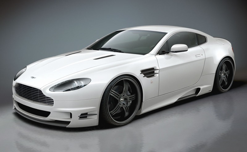

how to create car surface based on aston martin V8 by using ProE 5
By jenisker on 03 Feb 18:12 4 answers 1227 views 7 comments
want to create car surface of V8
Added images

    use style > Trace sketch > insert front, top, right view of a car you want (usual .jpg etc format).
    trace sketch is great if you have blueprints.
    surface design is hard in any software but if you willing to give some time i.m sure you will achieve your goal
  • Venkatasubramanian
    Venkatasubramanian over 1 year ago
    Better U do it CATIA or solidworks ..buddy..'cos Surfacing n proE 'd take helluva lot of time..and It's quite cumbersome.;/
  • Abhijeet Kumbhar
    Abhijeet Kumbhar over 1 year ago
    @^ actually... surfacing in proE is very diff. instead of do it in CATIA..
  • Sabitha Anisetti
    Sabitha Anisetti about 1 year ago
    Depends on how much of an understanding you have with ISDX tool in proe; free curves, tangencies and how to acheive the continuity. If you have played around ISDX then let me know, it'll be easier to walk you through. Also, which version of Proe do you have?
