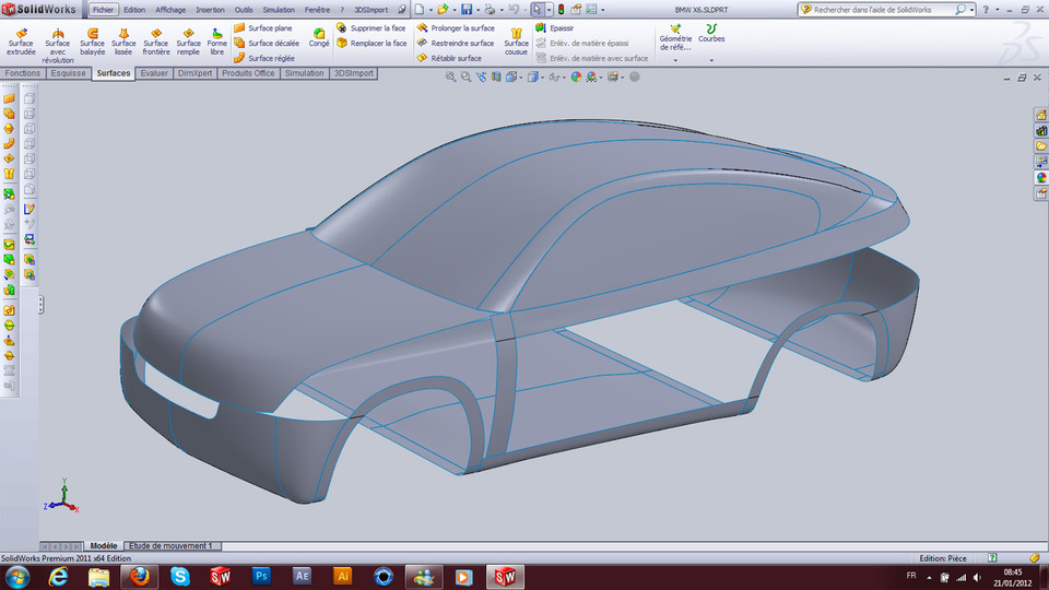

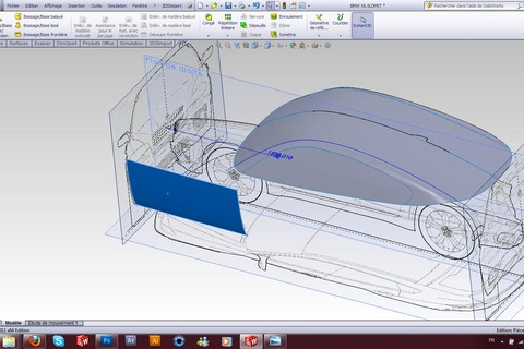

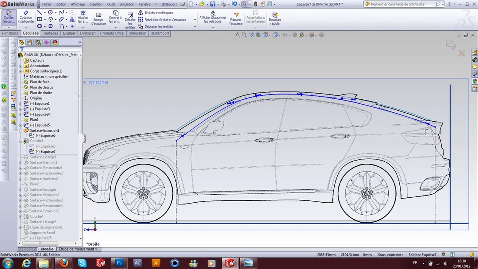

    you will see some of the advanced method for creating surfaces of a car BMW X6

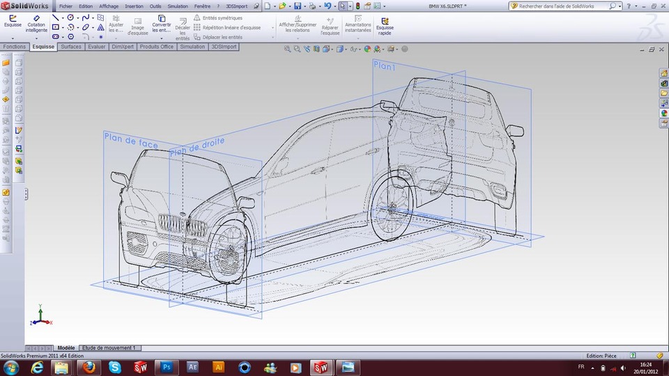

    1. Step 1

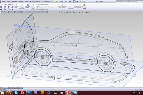

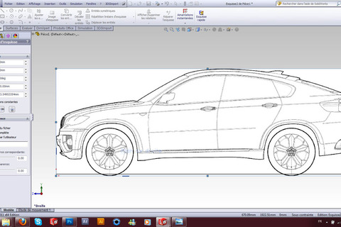

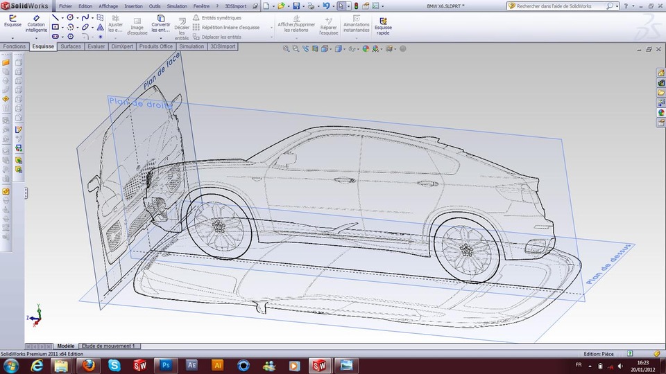

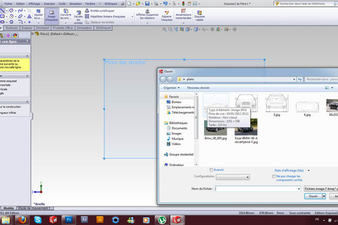

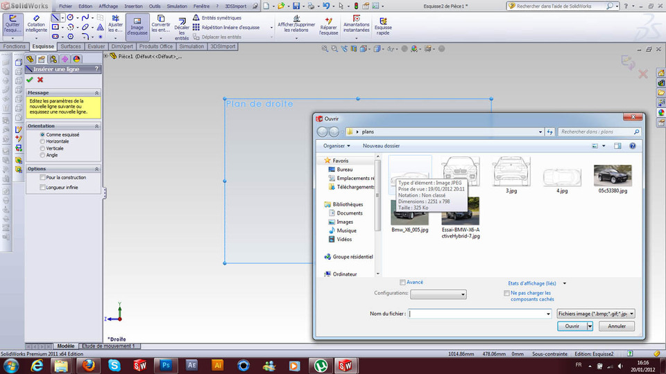

      1 - open a new file and choose the right plan and click on sketch image
      Medium
    2. Step 2

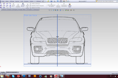

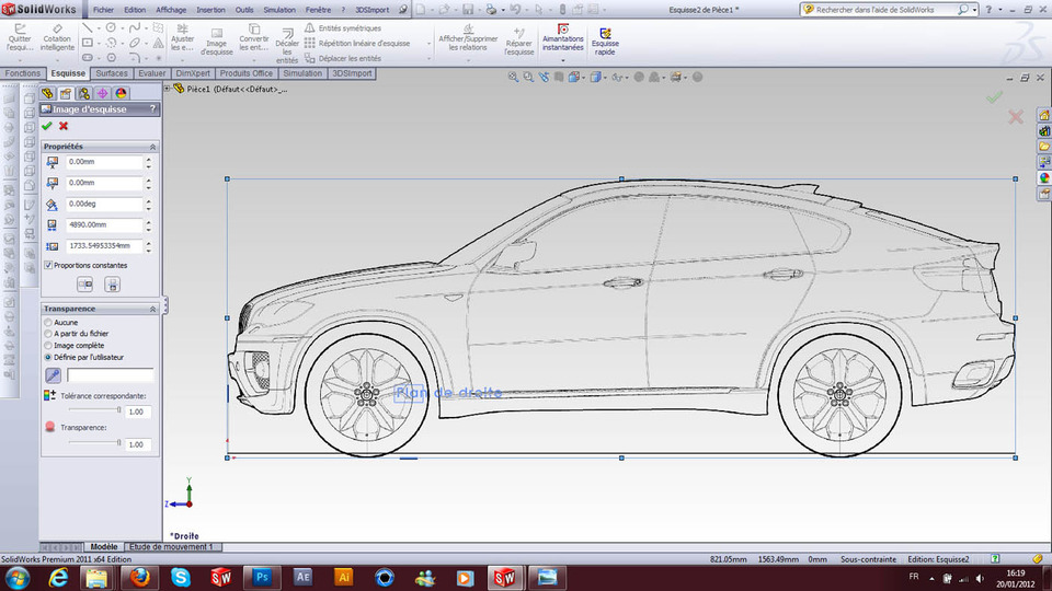

      2 - but we must prepare images before, we choose the image
      Medium

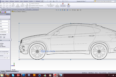

    3. Step 3
      3 - we put on the transparent image by clicking on the color of the image bleached by the pipette is left to bottom
      Medium

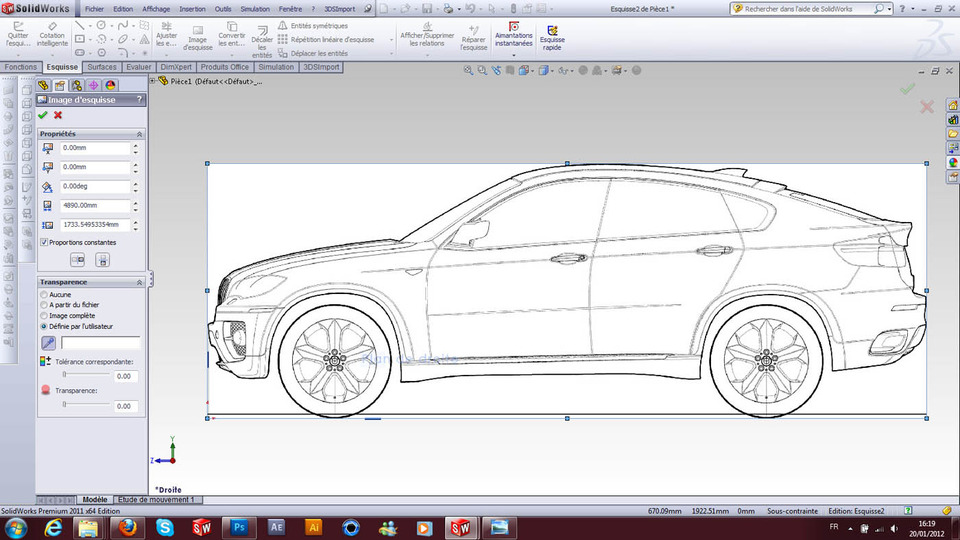

    4. Step 4
      4 - and we do the same steps for other pictures
      Medium
    5. Step 5
      5 - .
      Medium

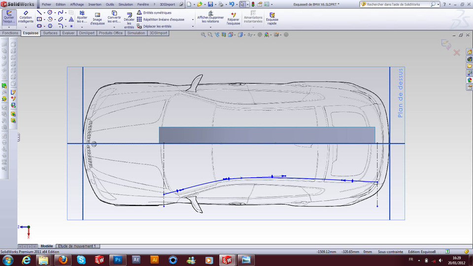

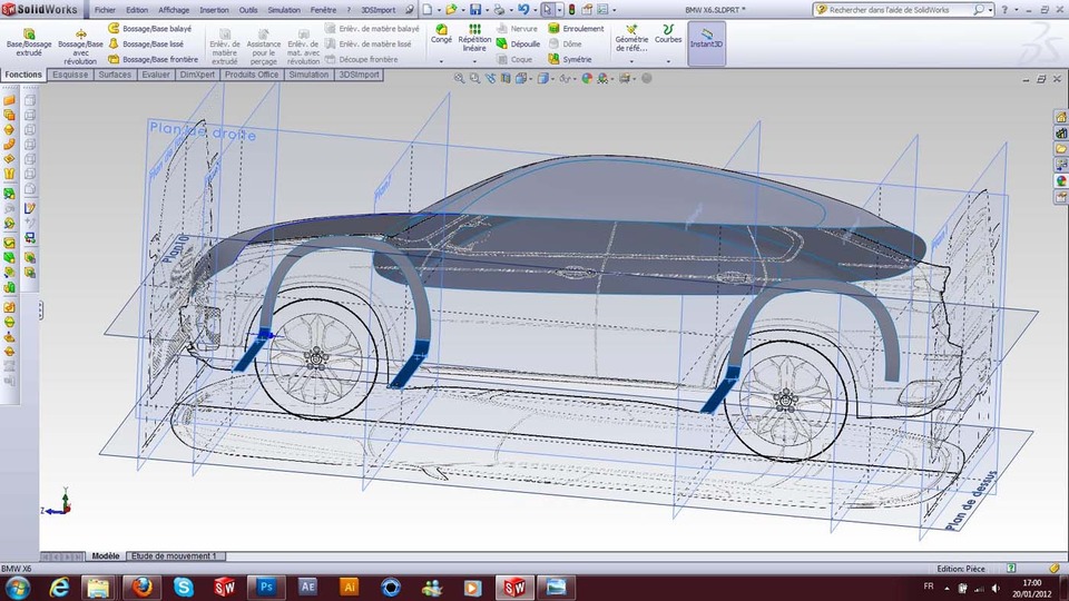

    6. Step 6

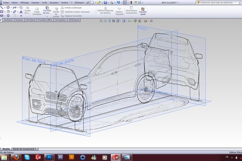

      6 - and to plan the back by creating a parallel range plan to plan ahead
      Medium

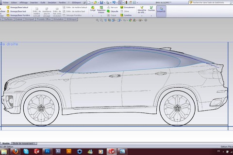

    7. Step 7

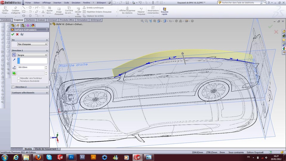

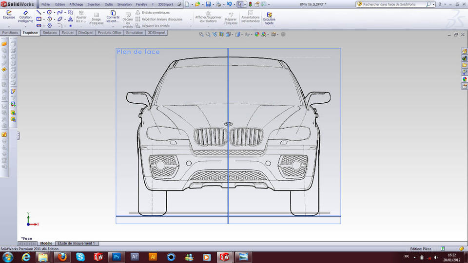

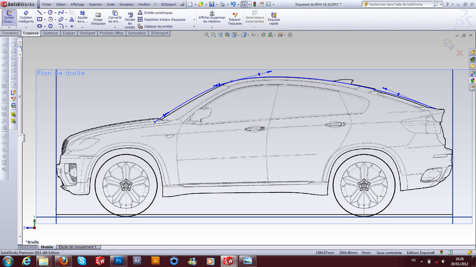

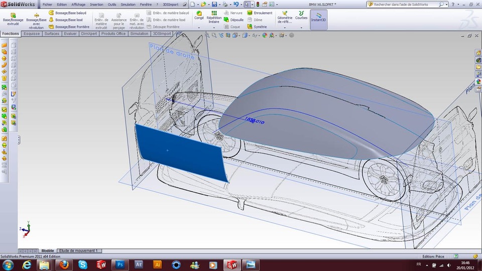

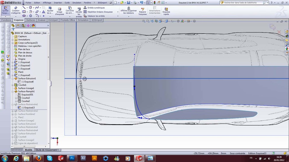

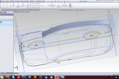

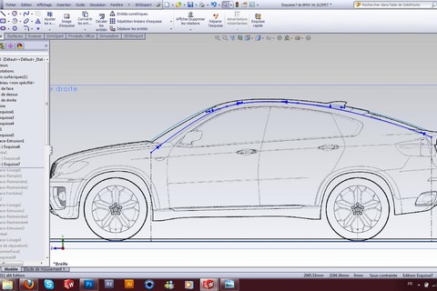

      7 - After I draw a spline on the image to the right plan
      Medium

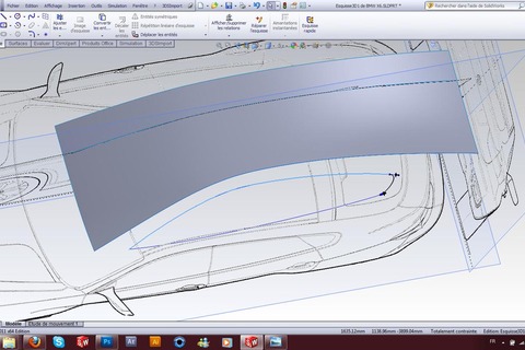

    8. Step 8
      8 - and extruding the spline
      Medium
    9. Step 9

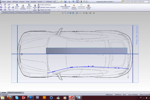

      9 - drawing a sketch on the plane below and we put two lines of construction until the mid plane
      Medium
    10. Step 10
      10 - and the same operation on the right plan
      Medium
    11. Step 11

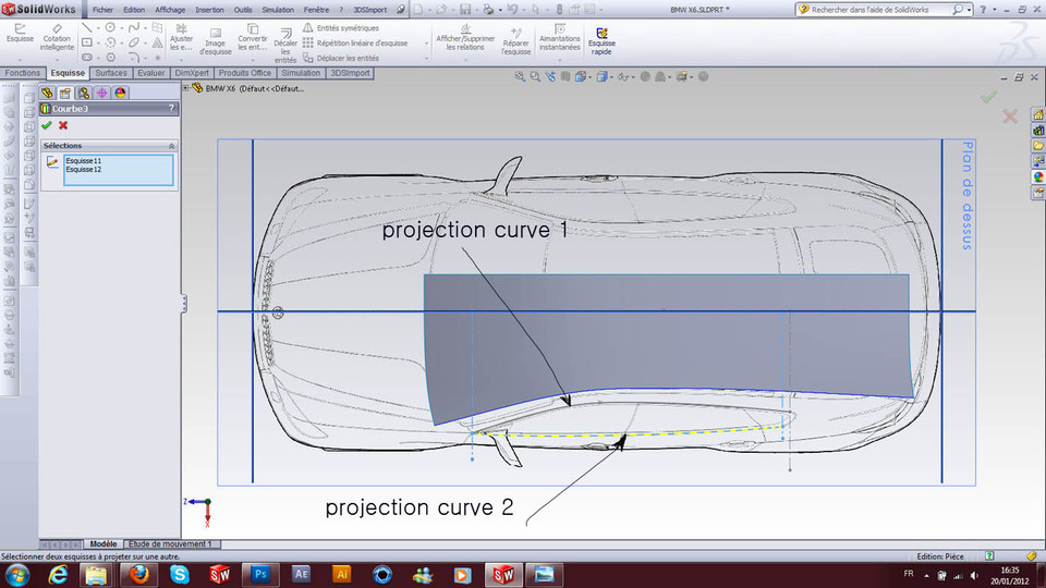

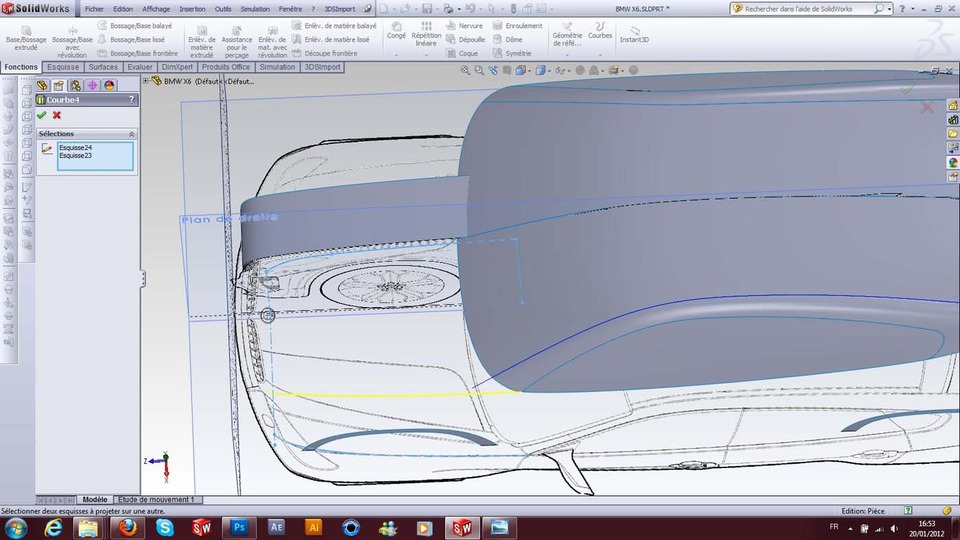

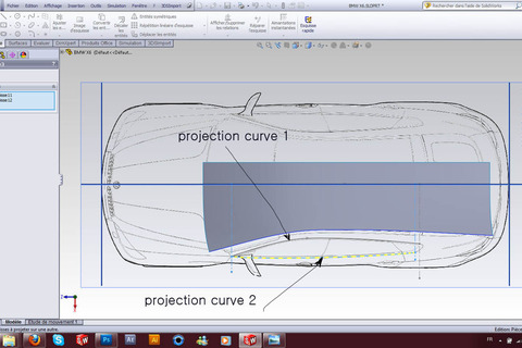

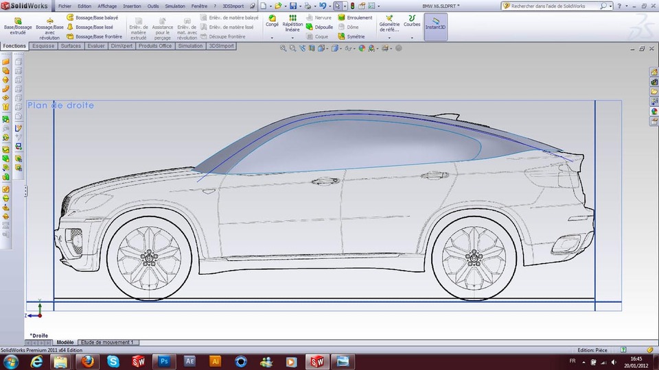

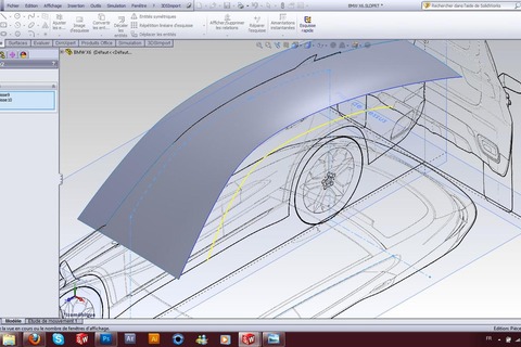

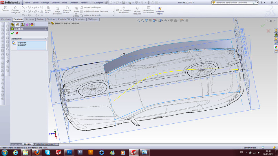

      11 - after we make a projection for the two curves
      Medium
    12. Step 12

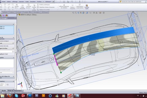

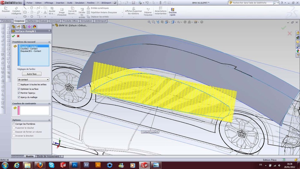

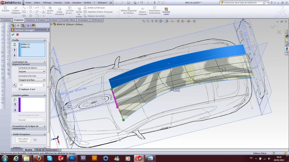

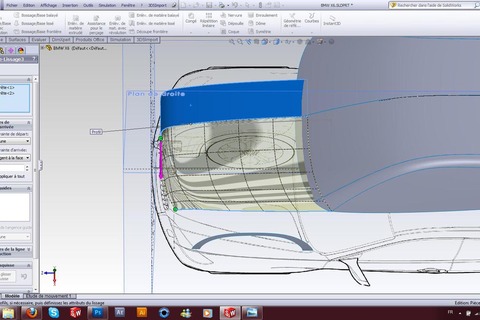

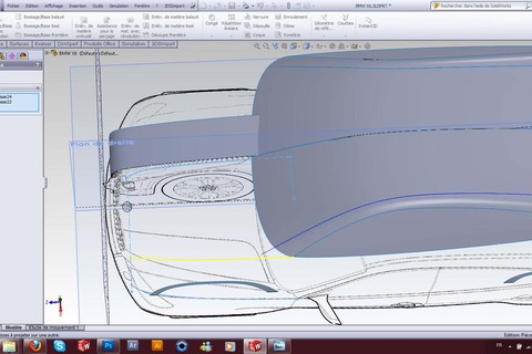

      12 - After you connect the surface created with the projected line
      Medium
    13. Step 13

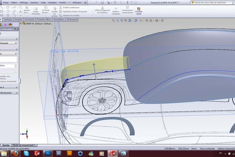

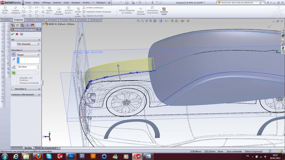

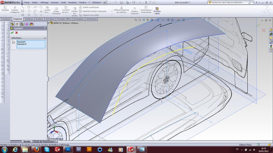

      13 - we create another line near the first projection
      Medium
    14. Step 14
      14 - Another projection curve
      Medium
    15. Step 15

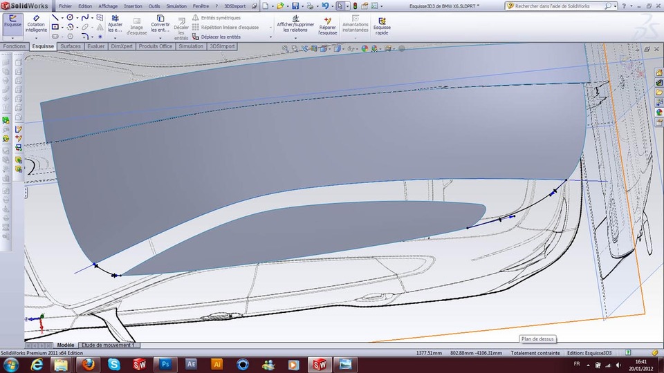

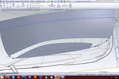

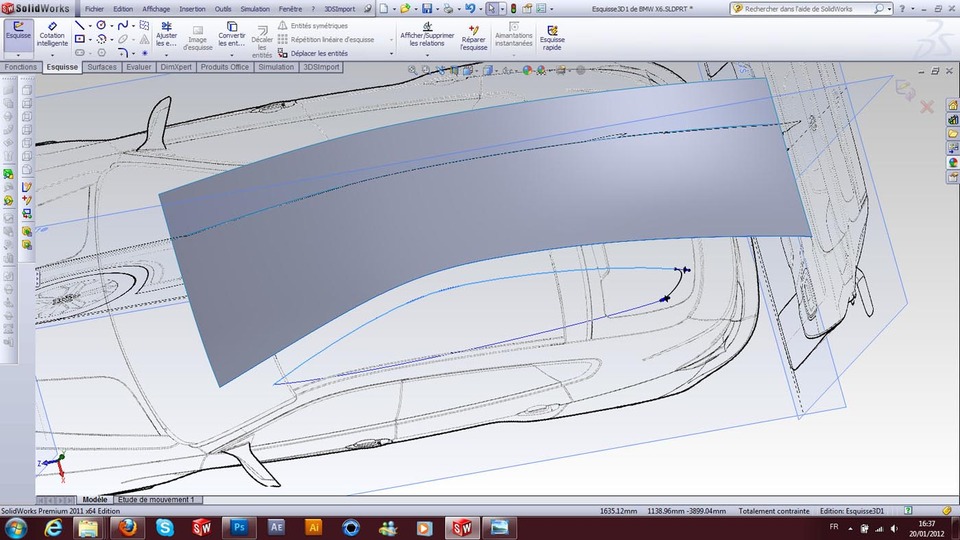

      15 - After you connect the two spline curve by a closed 3D sketch
      Medium
    16. Step 16
      16 - and we perform the sketch
      Medium
    17. Step 17

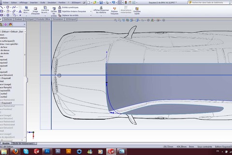

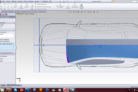

      17 - After we create a sketch on the plane as in the picture below
      Medium

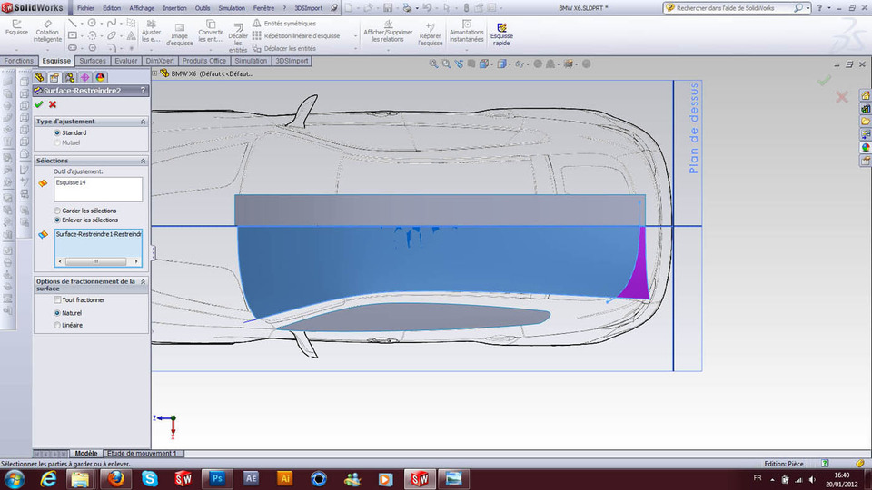

    18. Step 18

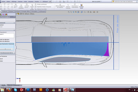

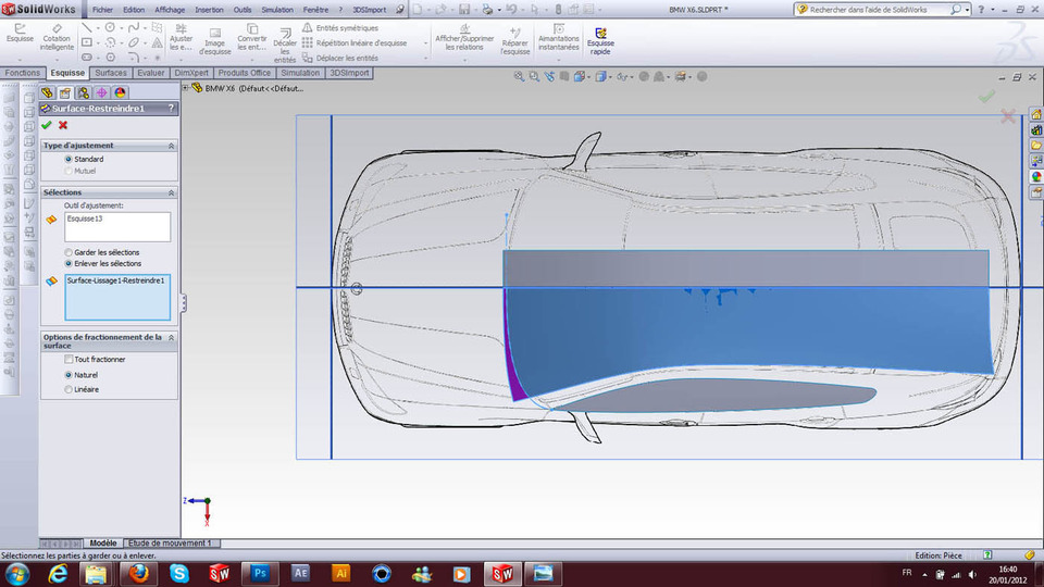

      18 - and we restrict the part we do not need
      Medium

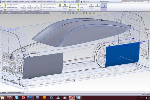

      19 - the same goes for the rear side of
      Medium

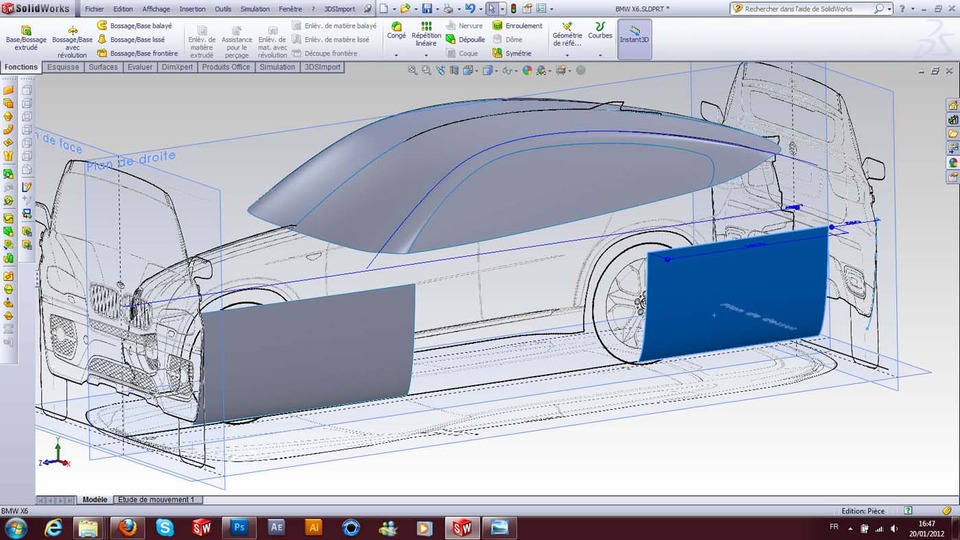

    20. Step 20
      20 - We connect the two surfaces with a 3D spline
      Medium
    21. Step 21

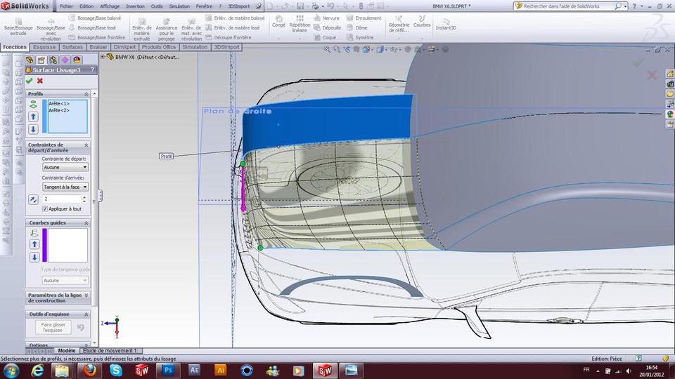

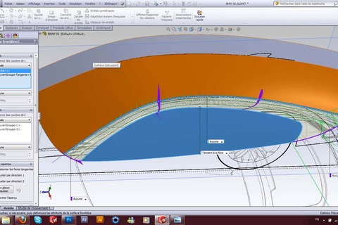

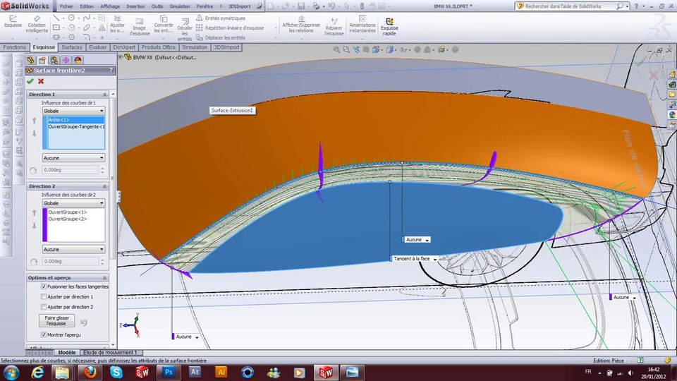

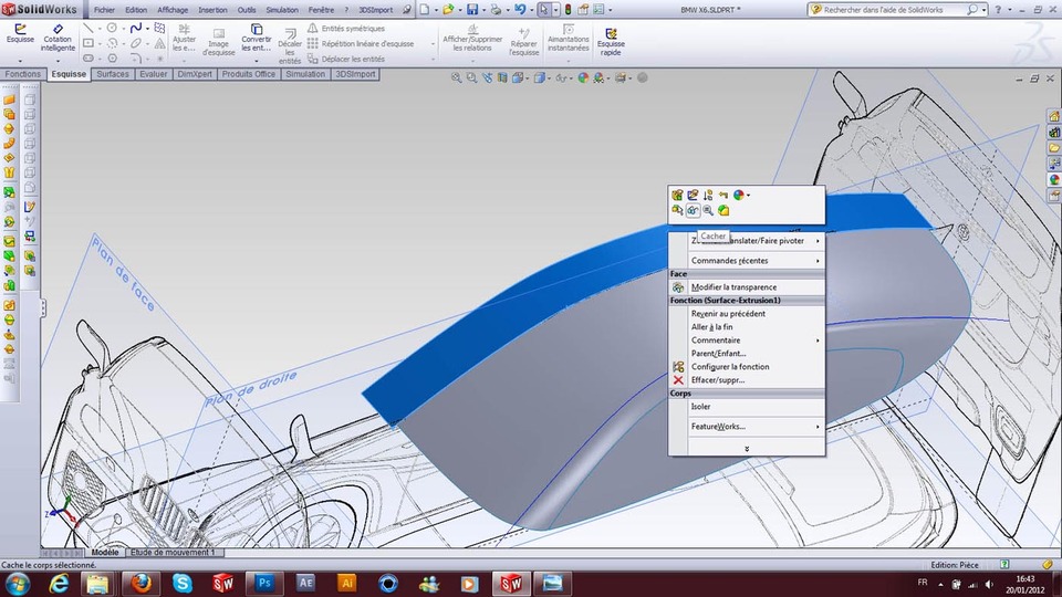

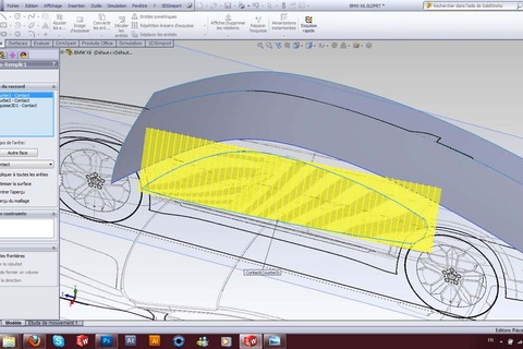

      21 - we create a boundary surface as in the picture
      Medium
    22. Step 22

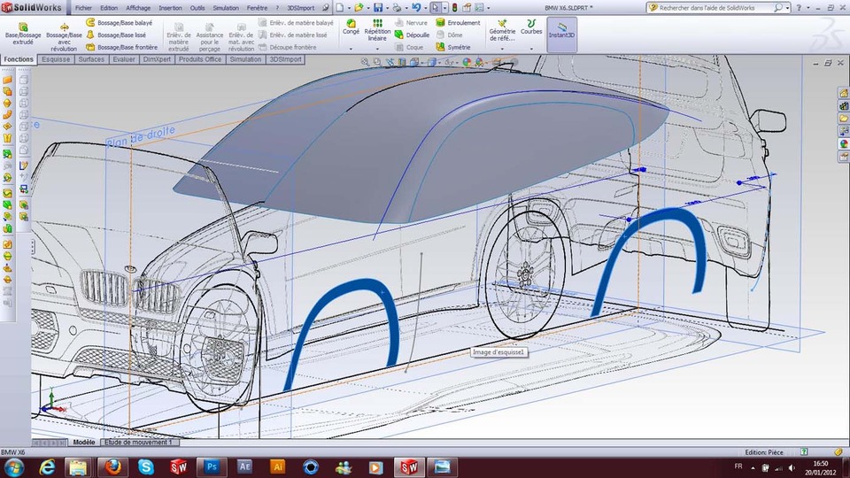

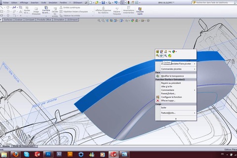

      22 - we hide the first area created
      Medium
    23. Step 23

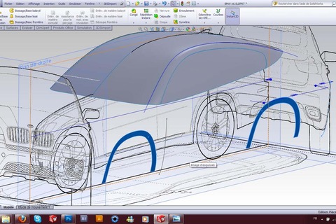

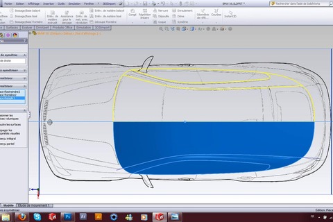

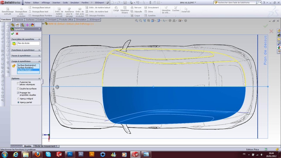

      23 - we can create the symmetry
      Medium
    24. Step 24
      24 - and we note that the surfaces created are well established in terms
      Medium
    25. Step 25

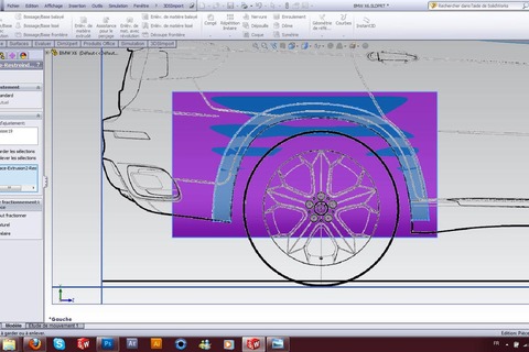

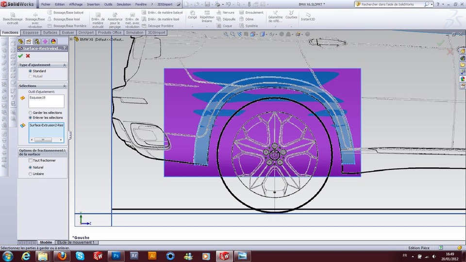

      31 - We connect the surface created with the projected curve
      Medium
    32. Step 32
      32 -
      Medium
    33. Step 33
