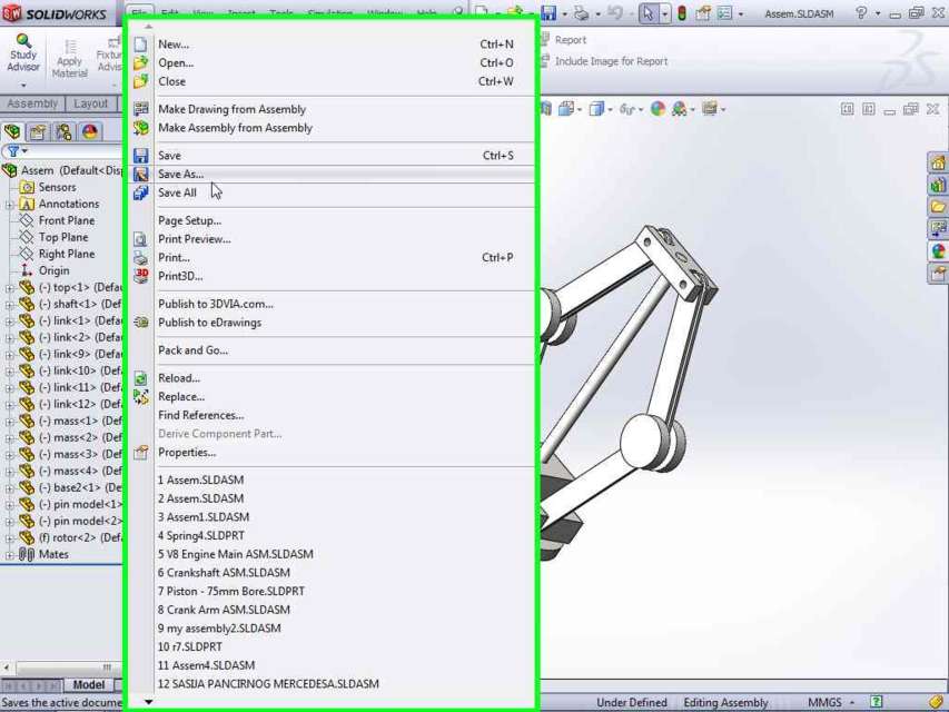

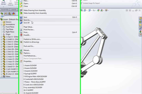

    1. Step 1
      left click on "Save As... (menu item)"
      Medium

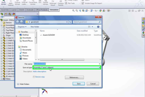

    2. Step 2

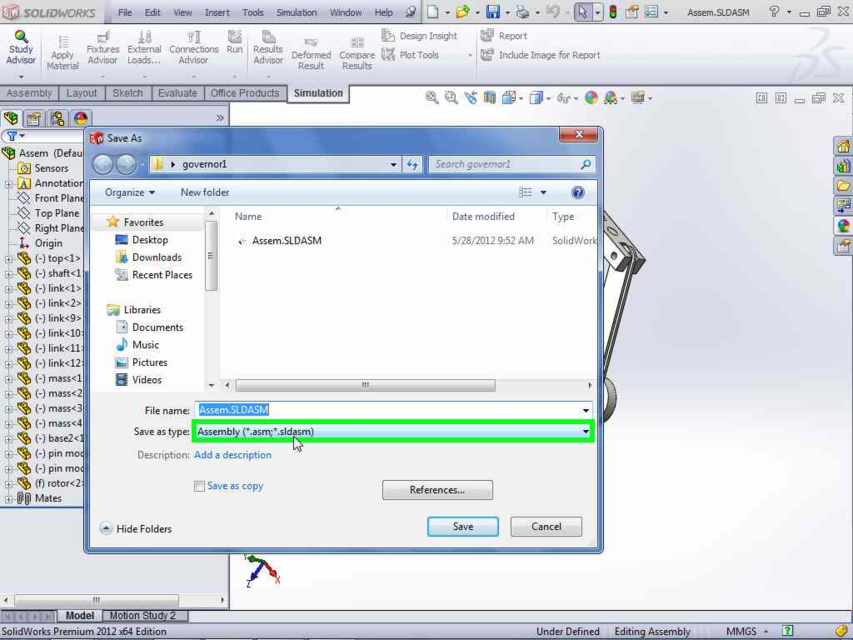

      "Save as type: (combo box)" in "Save As"
      Medium

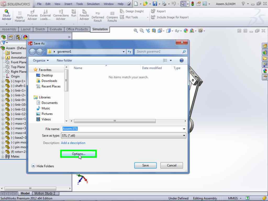

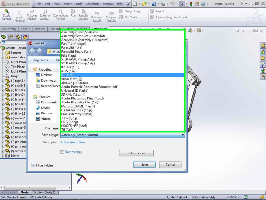

    3. Step 3
      left click on "STL (*.stl) (list item)"
      Medium
    4. Step 4
      left click on "Option (Push botton)"
      Medium

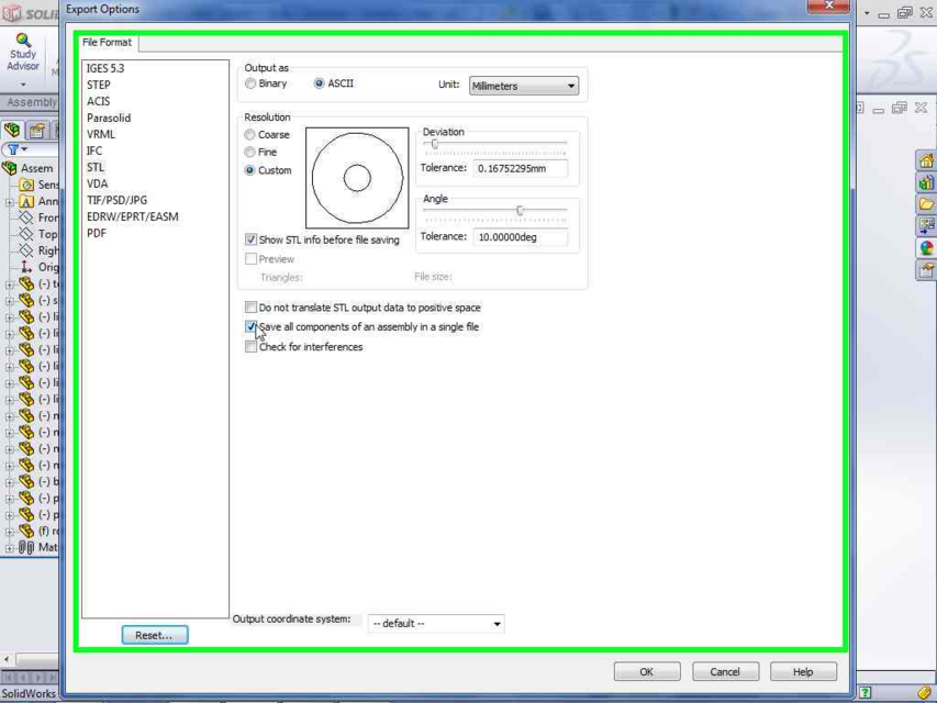

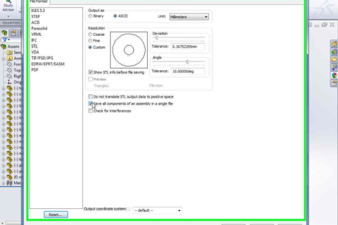

    5. Step 5
      left double click on "Save all components of an assembly in a single file (check box)" in "Export Options"
      Medium

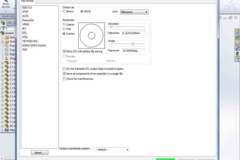

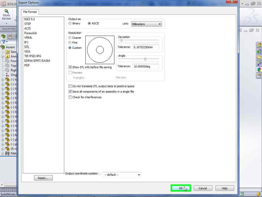

    6. Step 6
      left click on "OK"
      Medium

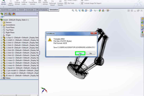

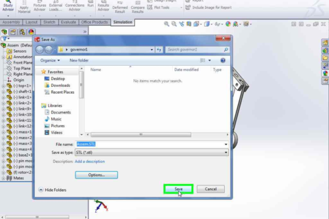

    7. Step 7
      left click on "Save (push button)" in "Save As"
      Medium
    8. Step 8
      left click on "Yes (push button)" in "SolidWorks"
      Medium
