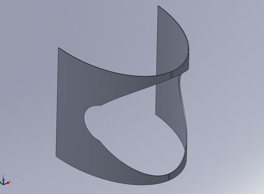

How to flatten this part into sheet metal in Solidworks?
By Mihkel on 16 Dec 19:37 6 answers 1414 views 4 comments
I need to make a flat path from this curved shape.
Can anyone give a helping hand?

    Well, in SW the file you attached is completely useless as far as editing goes. Ok. Here's an example how to create it and the result.
    Hope this helps.

    Here is a way to do this, using elliptical sketch. It's just roughed out.
    Cheers.

    You can't make a sheet-metal part from oval sketch. It has to be a straight line or a circle - only then you can make it in sheet metal and flatten it.
    At least I didn't find any other way.

    Try with the attached file (part) SW2010 and try replicating the steps, let me know if you understand the procedure. There are other ways as well, this was the simpler way to explain.
    PS. For laser cutting, you will need to do an additional drawing and an additional cut that goes through the radial section under 90 degrees or to do the drawing on the unfolded sheet. Depends on what you want or need.

    Brian has the correst solution for sheetmetal
    Using sheetmetal loft and normal cuts
    This part will flatten
    When doing loft increase # of bend lines for better display
    Good solution Brian
