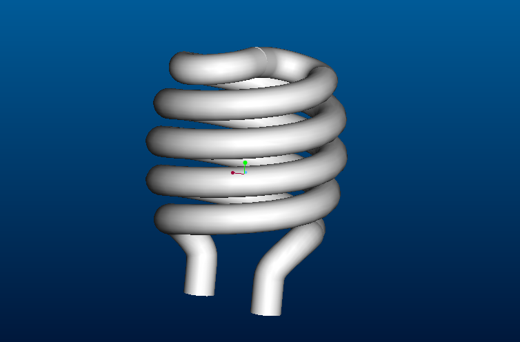

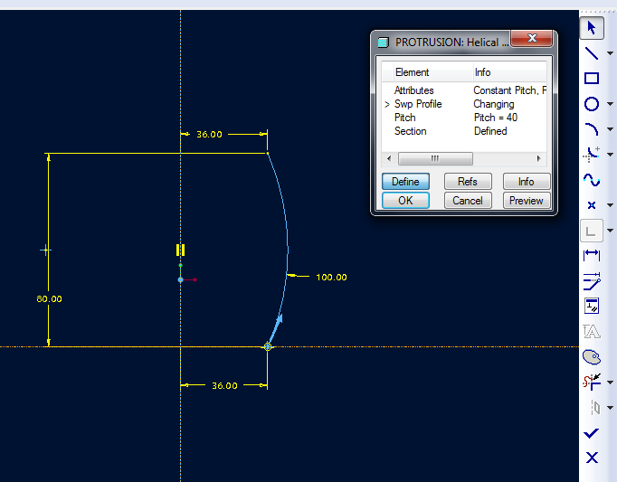

    I try to create the bulb, not so difficult but need to prepare project curve for top and bottom spiral.
    For the middle just use helical sweep.
    After create half spiral, than copy and rotate. Done
    Added images
    Square

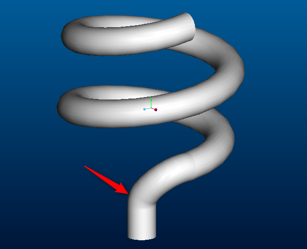

    First step, create helical sweep with trajectory (see the picture), pitch 4, and sketch diameter 17 cyrcle.
    Added images

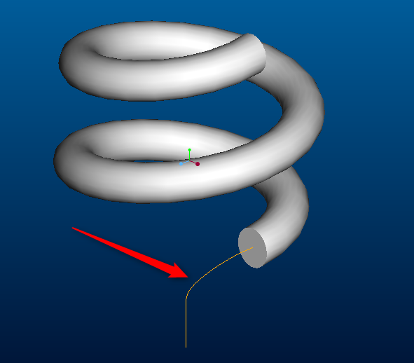

    Step two, create projected curve from view and side view
    Added images

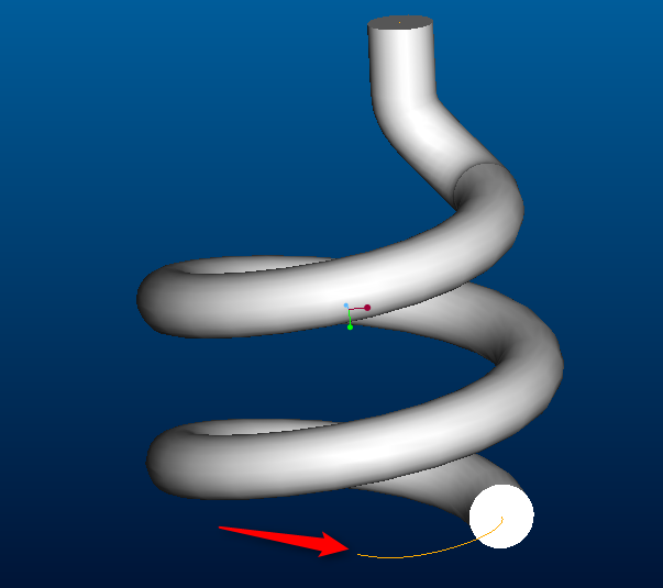

    Step three, create sweep with the projected curve for trajectory and use diameter spiral to make sketch
    Added images

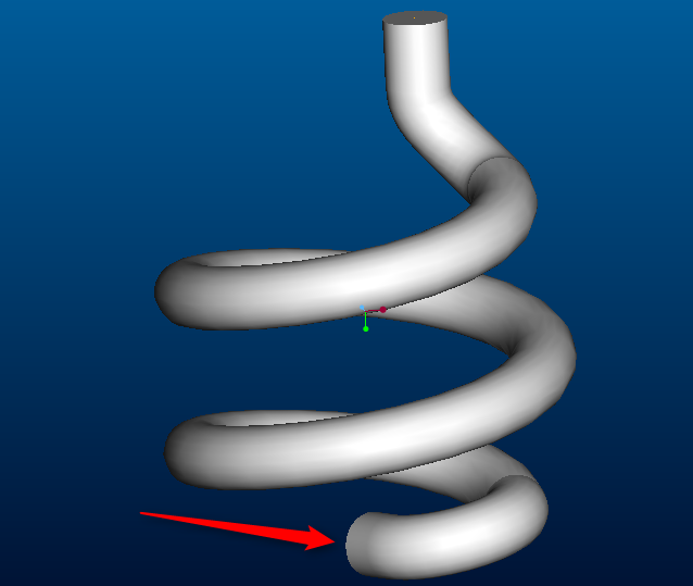

    Step four, similar with step three but for the top side
    Added images
