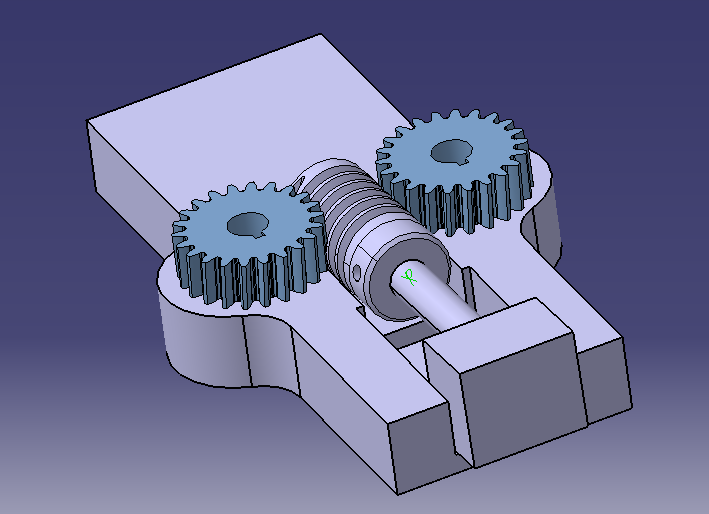

How to make a connection with two worm gears on Catia v5 Taoufik 21 Jun, 2012 07:43 PM I want to simulate this mechanism ensures that the two gears rotate depending on the worm Capture11.PNG 1 Answer G15 Answered on 21 Jun, 2012 08:41 PM First Set a gear junktion between the worm and the First gear (ratio 1:30 number of the teeth) then a gear junction between the both gears (Ratio 1:1) Look for the Rotation diection. Best regards PS I hate the autocorrect of my iPad
