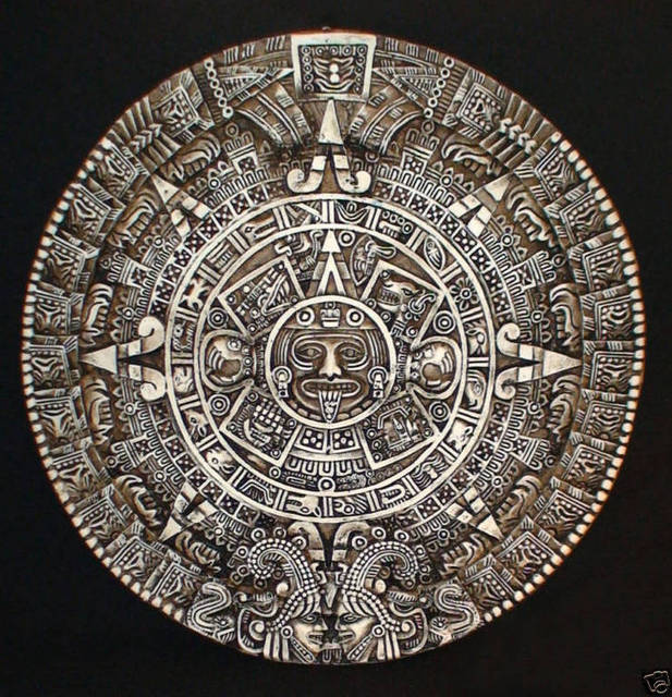

How to make this thing?
By Anshul Jain on 04 Mar 09:26 6 answers 427 views 0 comments
Its a mayan calender.
Added images

    Actually i mean for 3d model, any ways thanks for the help because i was looking for a 3d print also.
  • John Sahov
    John Sahov over 1 year ago
    after creating model can save at Step format or other. in other program I don't know.
  • Robert Guyser
    Robert Guyser over 1 year ago
    This cries out for 3D scanning or use of 'topographic\level based image to 3D conversion' by way of specialized software. David 3D will be the absolute least expensive option utilizing '3d scanning', and there are numerous software packages that may make something somewhat sensible out of that design.
    Personally, for quality, you would get the best result by actually tracing the design with the CAD\3D drawing tools and modeling it out.. Of course, this wont get imperfections, which in a game or movie might be achieved via texture maps and bump maps and alpha maps and so on, but for 3D printing it must be 'in the model'.
    Consider looking into Blender or zBrush for programs that can modify a [perfect' 3D model from a CAD or 3D design program
