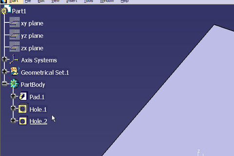

    small tutorial

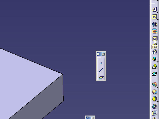

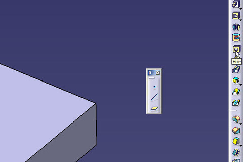

    1. Step 1

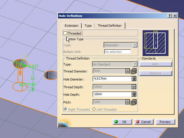

      use hole command in part design
      Medium

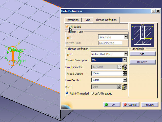

    2. Step 2
      make a hole with thread, every standard is predefined
      Medium
    3. Step 3

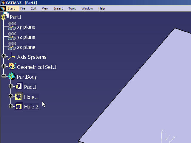

      compare! hole with NO thread.
      Medium
    4. Step 4
      you can see the difference HERE
      hole.1 thread
      hole.2 no thread
      Medium

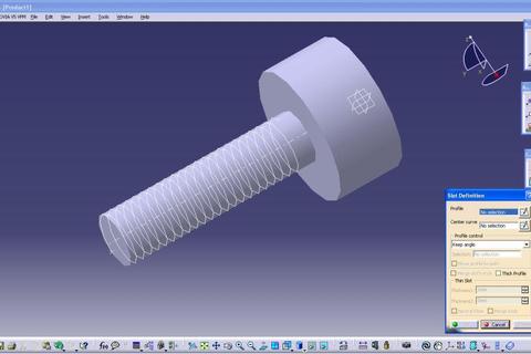

  • rakesh
    rakesh about 1 year ago

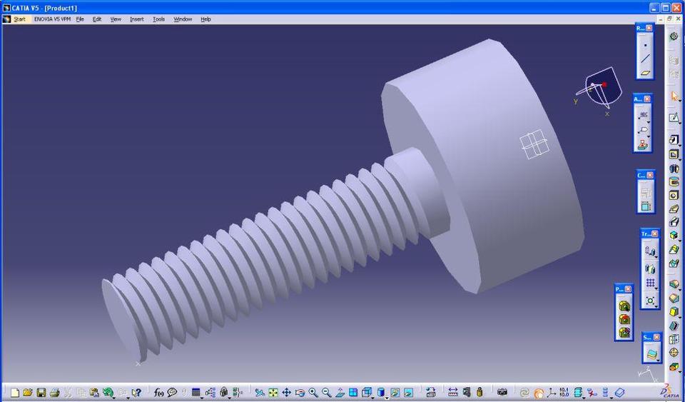

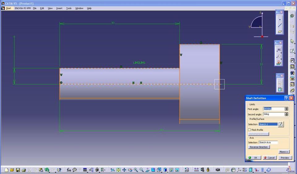

    Here is steps to create M8 shaft.

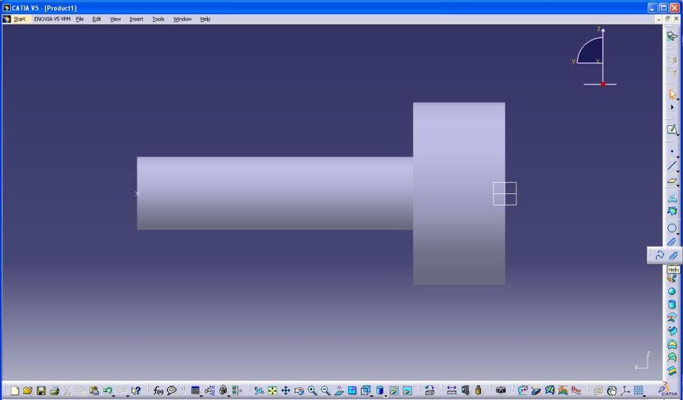

    1. Step 1
      Create a shaft definition as shown
      Medium
    2. Step 2

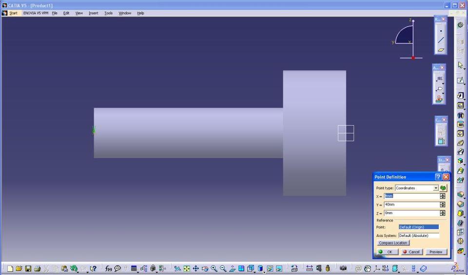

      Create a Point definition as shown
      Medium

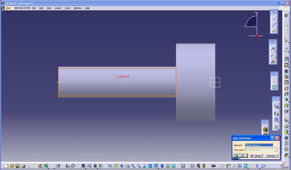

    3. Step 3

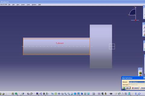

      Create a Axis definition as shown
      Medium

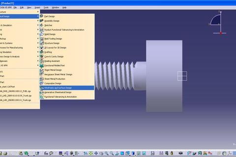

    4. Step 4

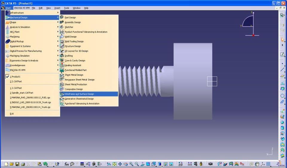

      Go to Wire frame & Surface design
      Medium

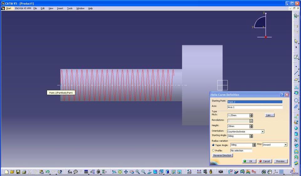

    5. Step 5
      Create Helical curve.
      Medium
    6. Step 6
      Create a Helix curve definition as shown
      Medium
    7. Step 7
      Switch back to Part design.
      Medium

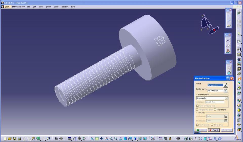

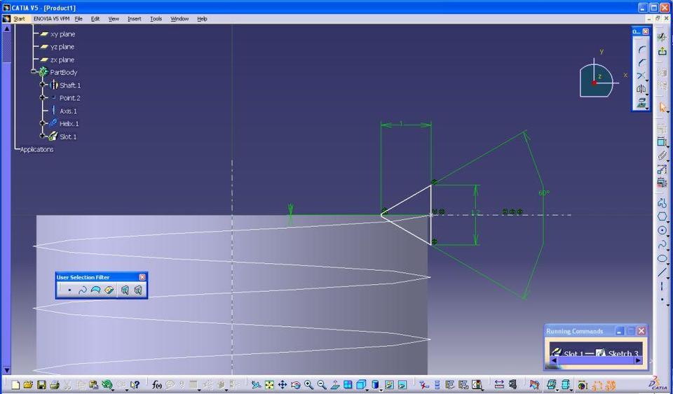

    8. Step 8
      Create a slot definition and sketch profile.
      Medium
    9. Step 9
      Sketch as shown
      Medium
    10. Step 10
      Select helix as center curve.
      In profile control, check pulling direction & select axis.

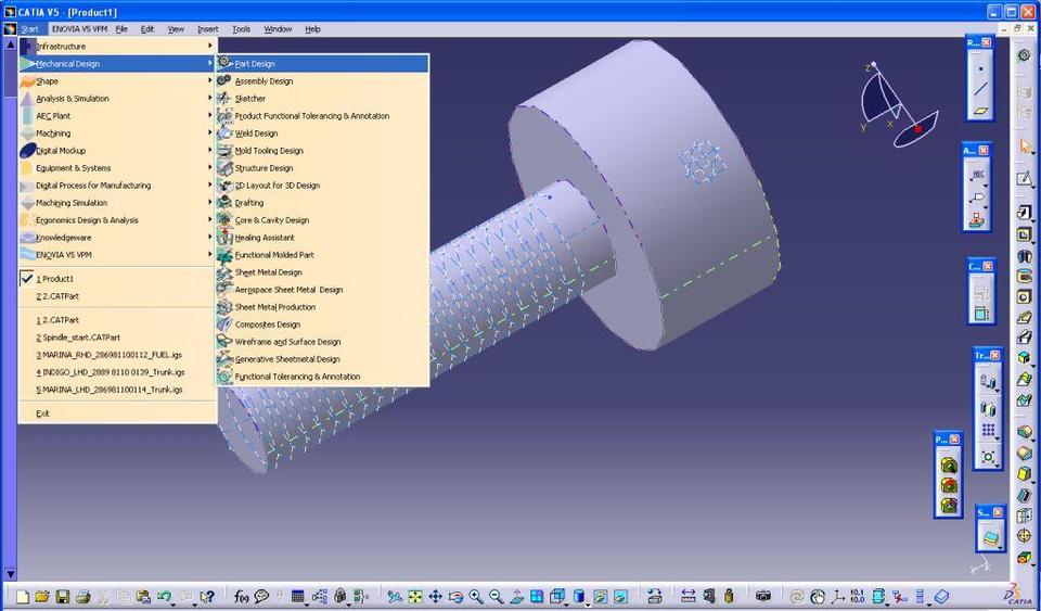

      Medium
    11. Step 11
      Finish the part to match the illustration shown.
      Medium
