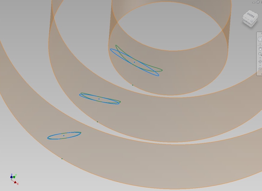

Good day,
I have a problem with modeling (Loft) blade when I using 3D sketch (green one in screenshot). I receive a message about that Inventor can't do that.
If I use regular (2D sketch), everything is good... But I need 3D. It is possible to do that?

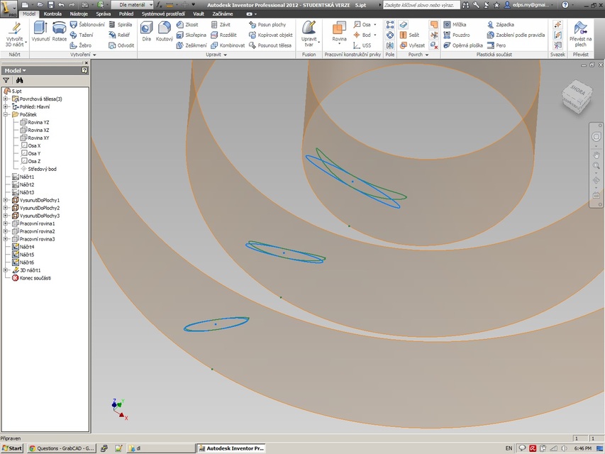

    I have noticed that when I make a loft from section in turn (of sketch):
    2D -> 3D
    or
    2D -> 2D -> 3D
    Then it works.
    But when i did it like
    2D - 3D - 2D
    or
    3D - 2D
    It doesn't work.
    I mean, 3D must be only one, and it have to be last section.
    What do you think about it? This should be obtained. Once, my teacher showed how to do it.

    Try adding a rail in
