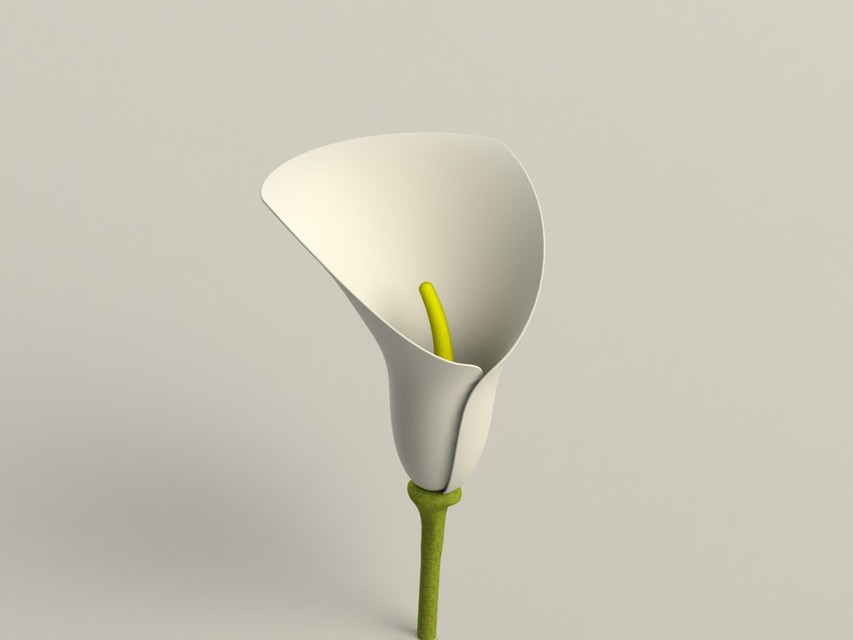

    I gave it go and here is what I came up with. I hope you like it.
    Calla Lily
    *** Note *** I am running Windows and SolidWorks on a mac and don't know how to take a screen shot. I attempted to make a video to show how I made the flower but the video does not show the feature tree or my mouse where I was trying to point to things. I hope between the video and these steps you can get an idea of how I made this flower.
    Calla_Flower.avi, 16.4 MB
    Download
    1. Step 1
      Petals
      -I opened up a new sketch and place the picture of the flower in the back ground.
      Medium
    2. Step 2
      -then I traced a profile on one side of the petal with the spline tool.
    3. Step 3
      -I did an offset entities and then closed the ends with short line segments.
    4. Step 4
      -in a new sketch I made a spiral to the shape of the petals.
    5. Step 5
      -pierce the two sketches together and do a sweep.
    6. Step 6
      -I then made a plane that bisected where the petals overlap and drew a profile of an arc. This was used to cut away the petals to give the flower the proper shape.
    7. Step 7
      -Added various fillets to shape and cleanup the petals
    8. Step 8
      Pistol
      -sketch of a circle at base of petal
    9. Step 9
      -sketch of smaller circle where top of pistol should end
    10. Step 10
      -profile sketch between two circles
    11. Step 11
      -loft using the above three sketches.
    12. Step 12
      -The top face of pistol cleaned up with a fillet
    13. Step 13
      Stem
      -Made a circle below the petal and pistol and did a simple extrude boss down for the strait part of the stem
    14. Step 14
      -Made a circle at the base of the petal and stem (that would merge all the bodies)
    15. Step 15
      -created four guide curves from the circle to the top of the extruded boss and made a loft.
    16. Step 16
      -cleaned up steam with fillets
    17. Step 17
      enjoy

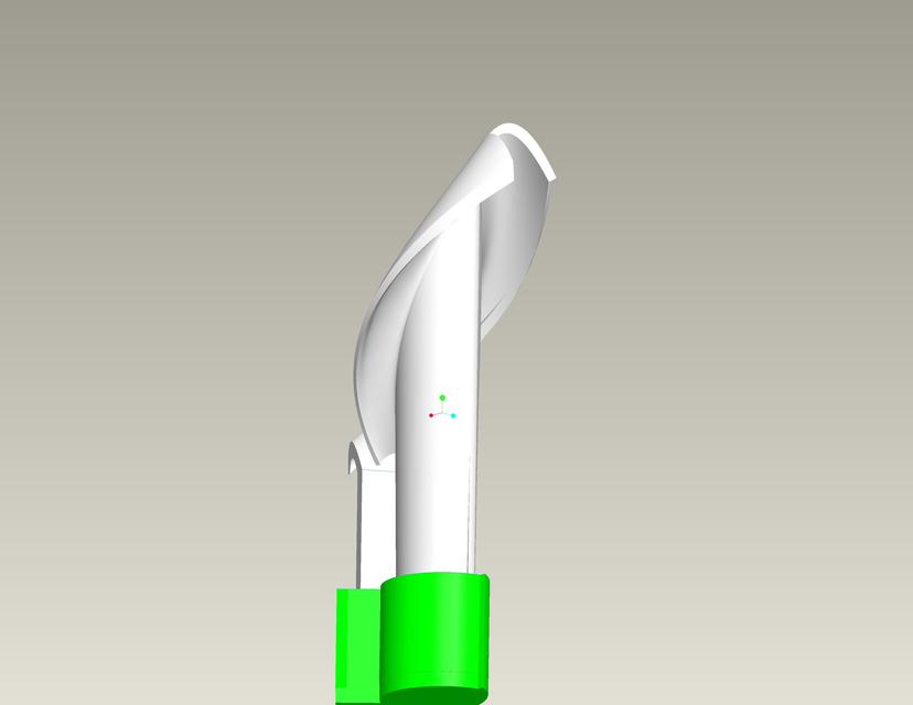

    actually i made a calla flower using pro-E .You can do it by using a simple swept blend command by defining the trajectory as well as the changing cross section at regular intervals. here is a model that i made
    Added images
    Square
    calalilly.igs, 561 KB
    Download
  • Tomica Vukovic
    Tomica Vukovic 10 months ago
    Very beautiful flower. If you use a transparency to model it will be better view to all part of Calla flower.
