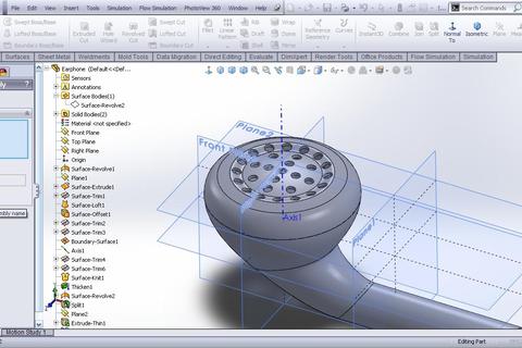

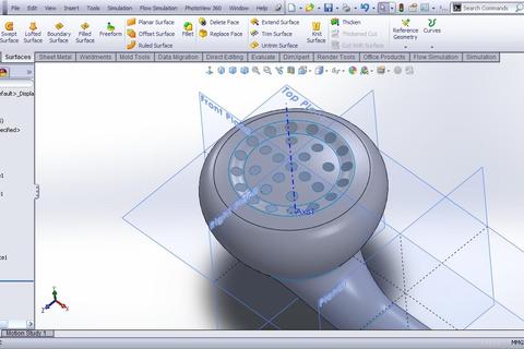

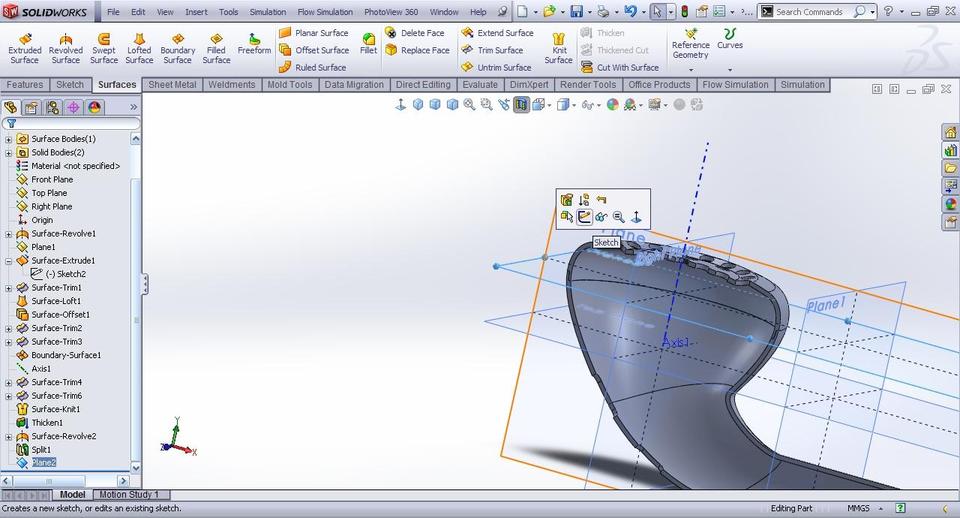

    This tutorial illustrates how to model an earphone using surfacing methods. Since a lot of persons doesn't know about surfacing model therefore i tried to perform every function step by step. If you have any problem struggling with that even after my efforts, just let me know. I will help you as much as I can.

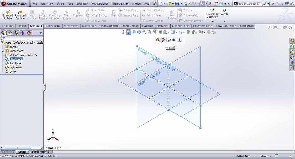

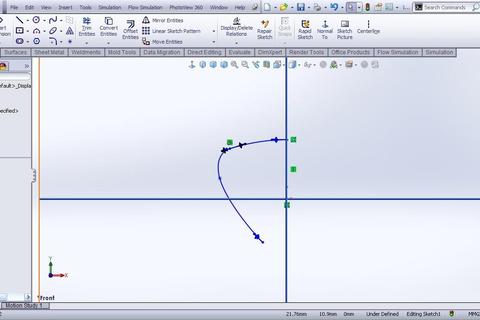

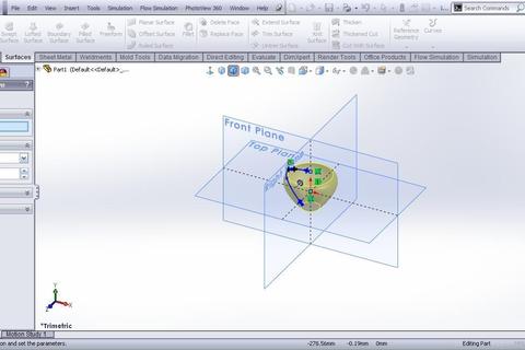

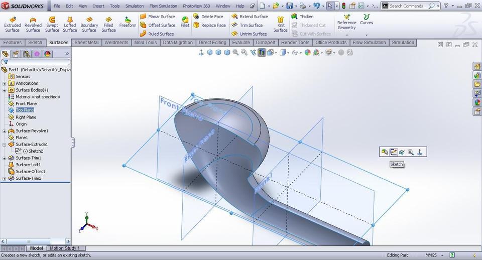

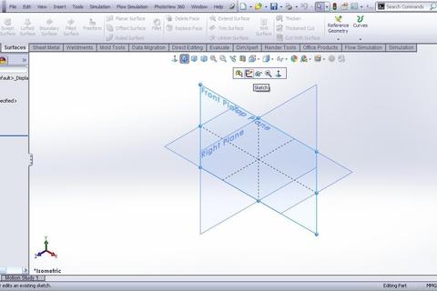

    1. Step 1

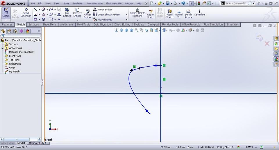

      Start Solidworks in Part mode. Select front plane and then sketch.
      Medium
    2. Step 2
      Draw entity using splines like this one. For this sketch i have used two spline and a centre line along right plane. The two splines are having tangent relation.
      Medium

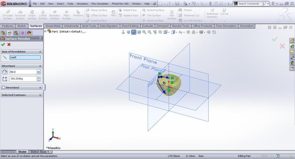

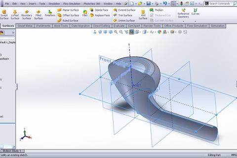

    3. Step 3
      Now select revolve surface under surfaces tab. Revolve the profile along the centre line.
      Medium

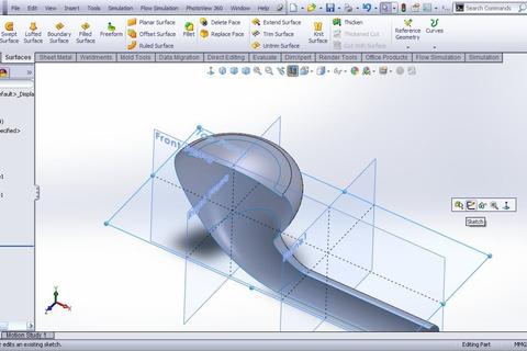

    4. Step 4

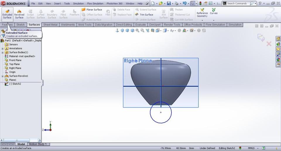

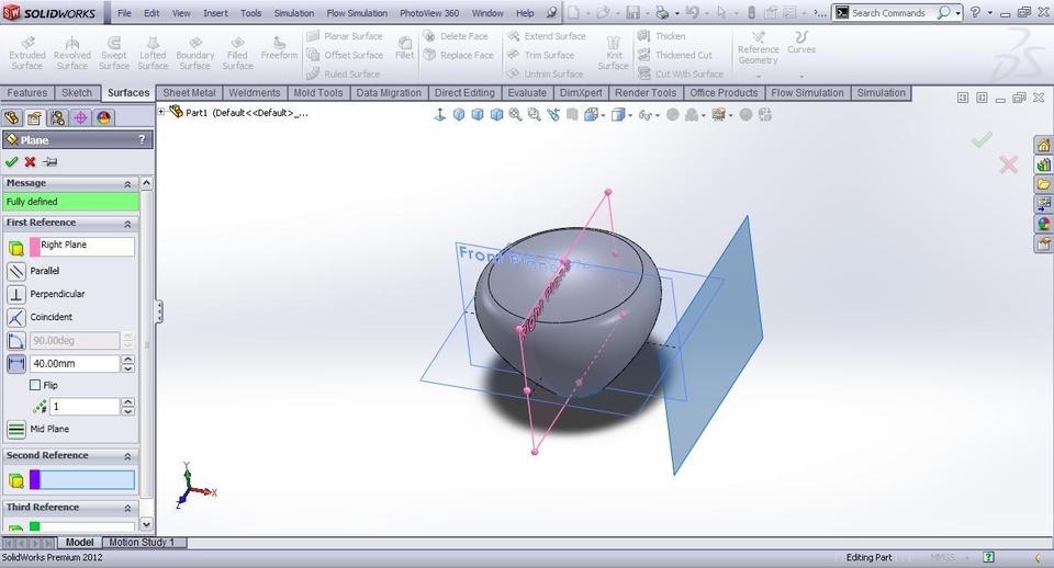

      Under surfaces tab select Reference geometry >> plane. Now select Right plane as the first reference and offset it by considerable distance.
      Medium

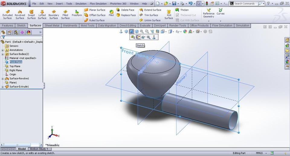

    5. Step 5

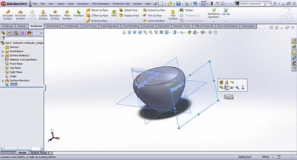

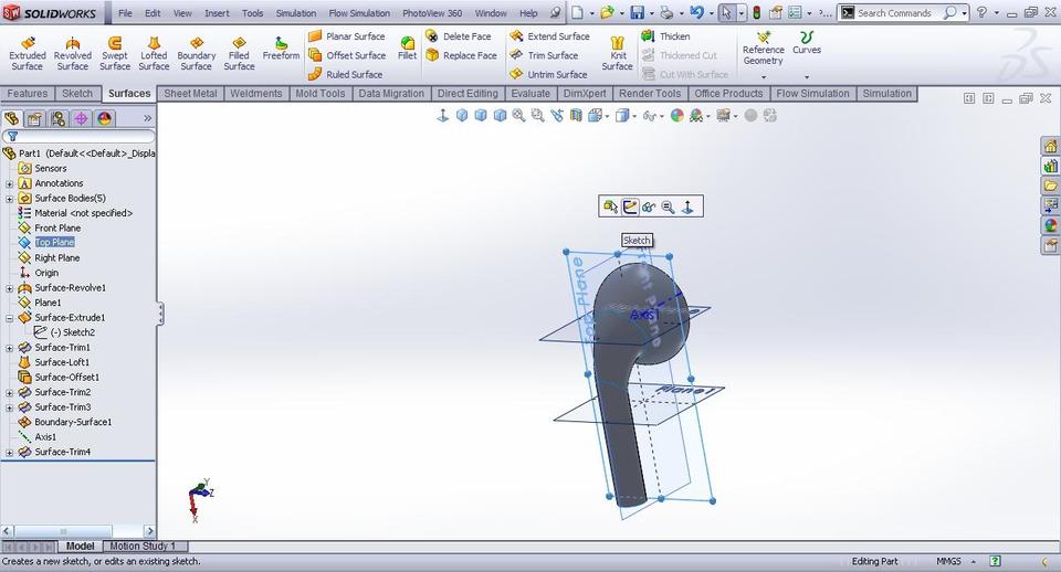

      Now select plane1 and then sketch.
      Medium
    6. Step 6
      Draw a circle like this one.
      Medium

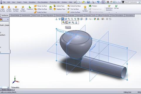

    7. Step 7

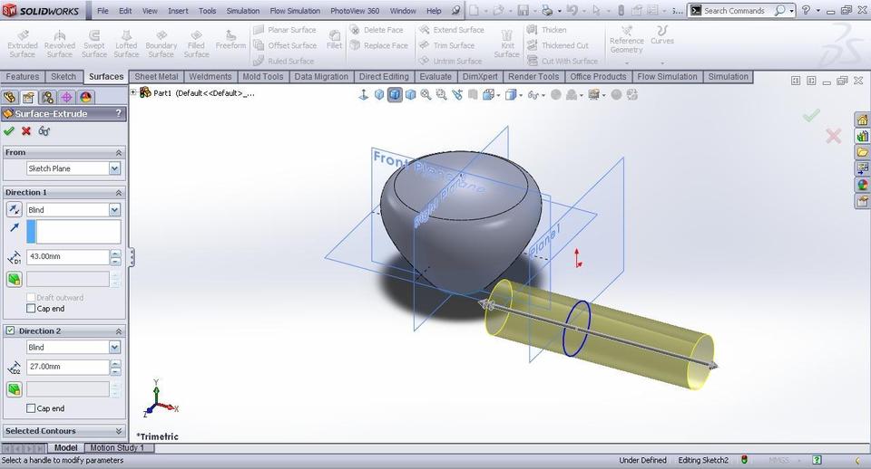

      Under sufaces tab click Extruded surface.
      Medium
    8. Step 8
      Extrude it in both direction with a considerable distance.
      Medium
    9. Step 9

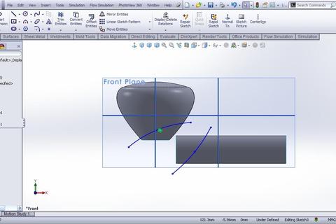

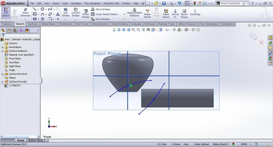

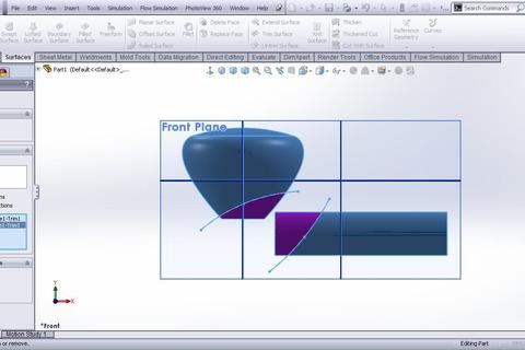

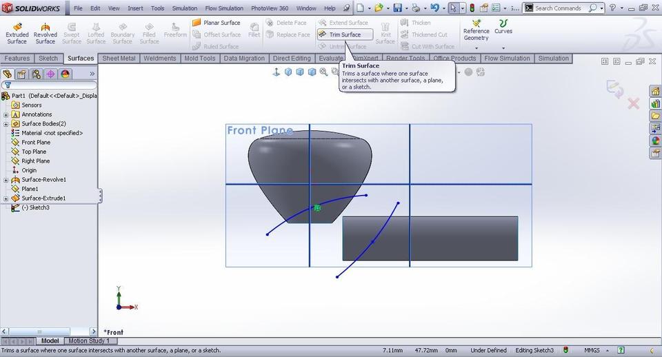

      Now select front plane and then sketch.
      Medium
    10. Step 10
      Draw two spline cutting the surfaces.
      Medium

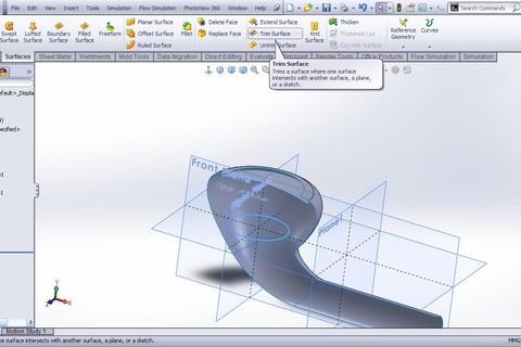

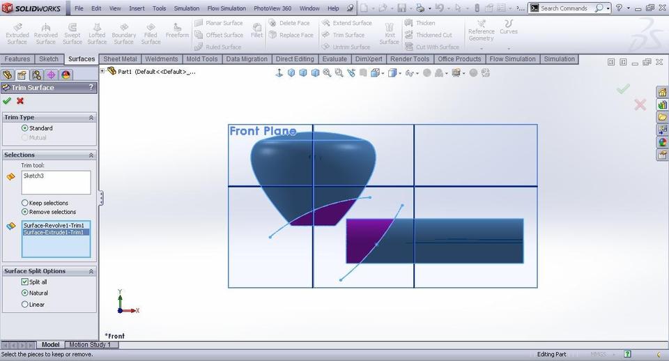

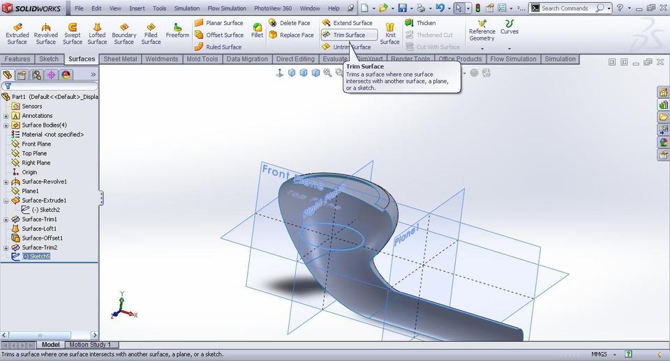

    11. Step 11
      Under surfaces tab select trim surfaces.
      Medium
    12. Step 12
      Select the surfaces under the splines and remove them.
      Medium

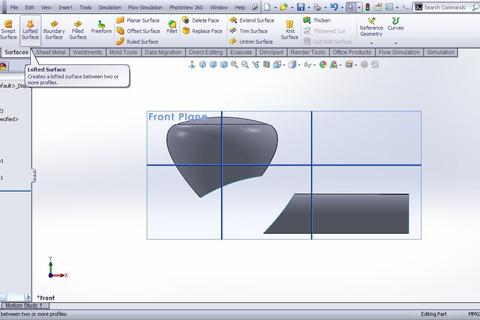

    13. Step 13

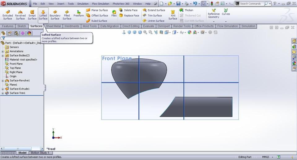

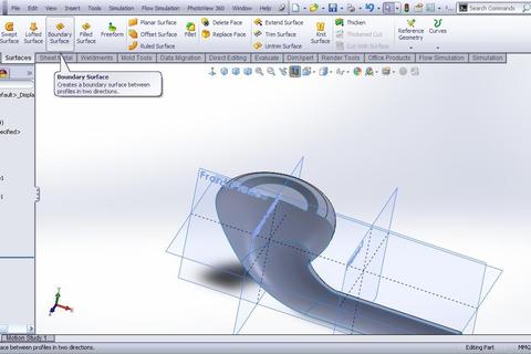

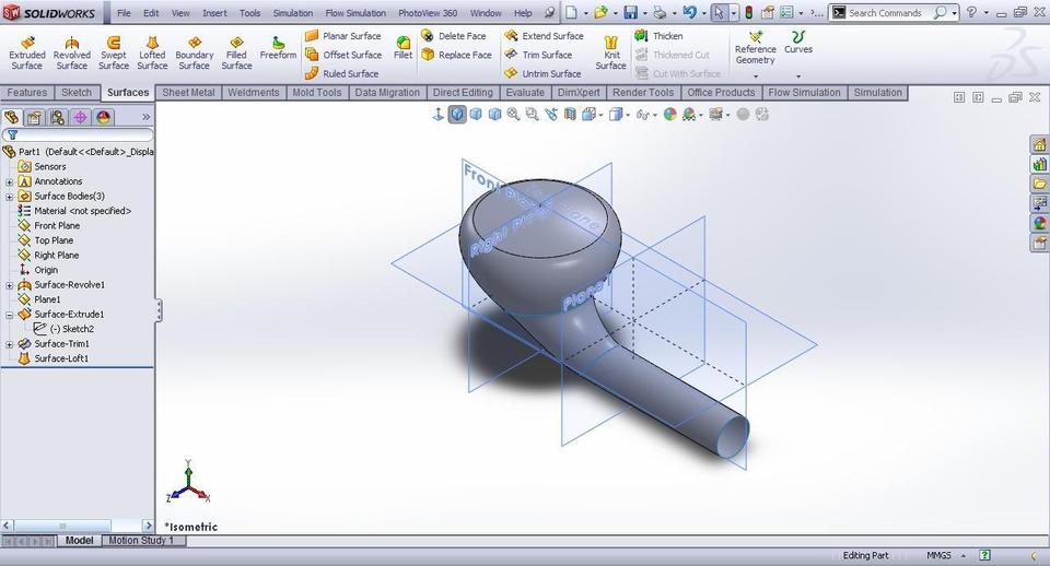

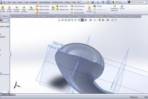

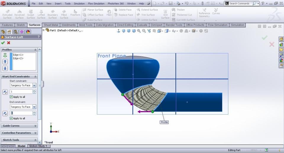

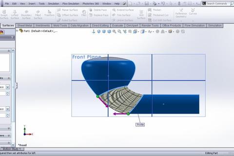

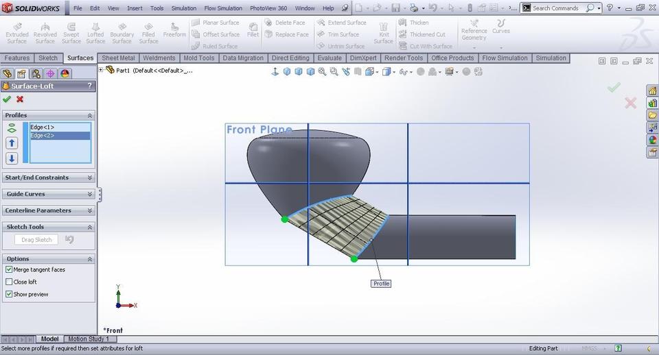

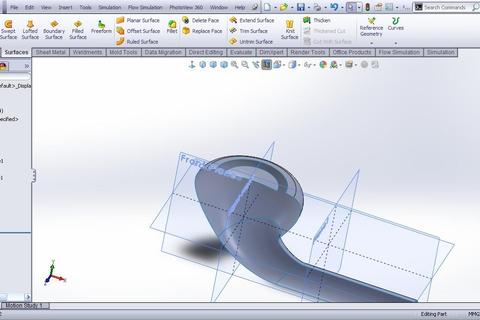

      Under surfaces tab select lofted surface.
      Medium
    14. Step 14
      Select both edges.
      Medium
    15. Step 15
      Under Start/End constraints change start and end constraint to tangency to face. Click OK.
      Medium
    16. Step 16

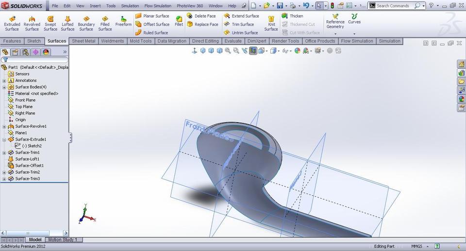

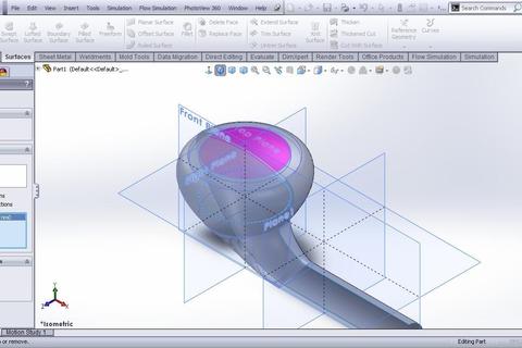

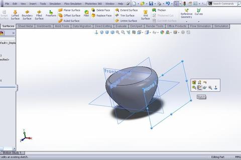

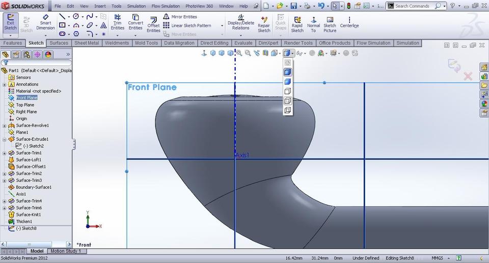

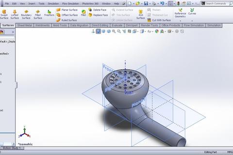

      We have basic shape of the earphone. I have decreased the radius of the extruded surface Because it was a little larger.
      Medium

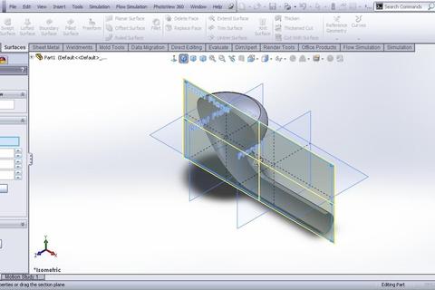

    17. Step 17

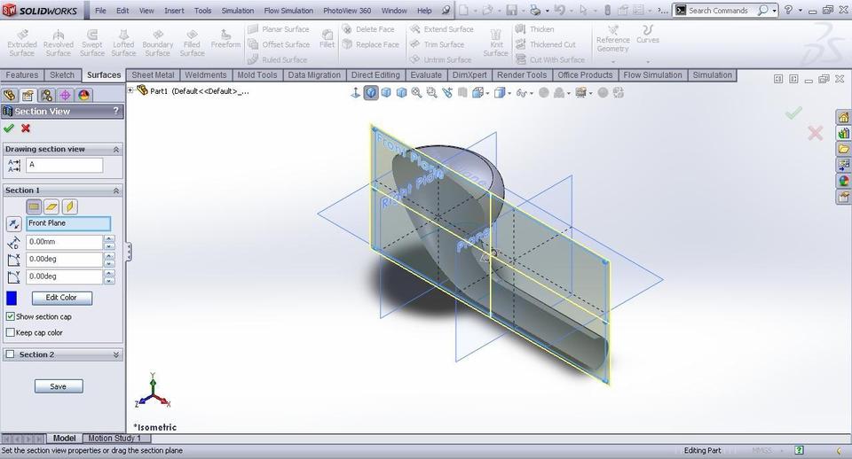

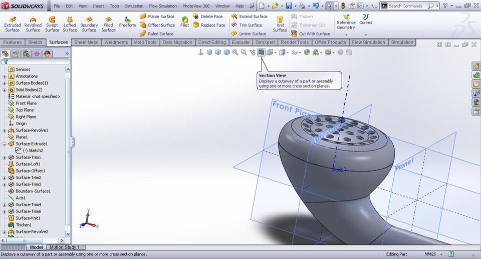

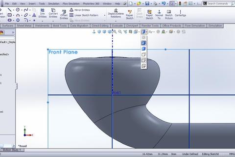

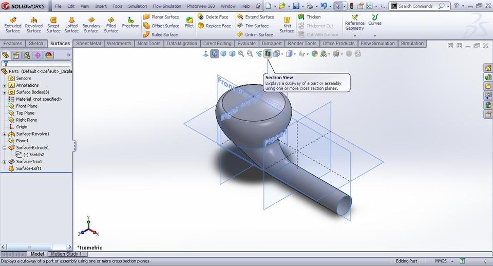

      Select section view in standard views.
      Medium
    18. Step 18
      Select front plane for section and click OK.
      Medium

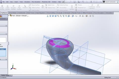

    19. Step 19

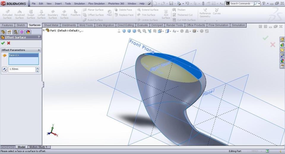

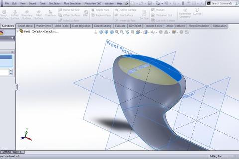

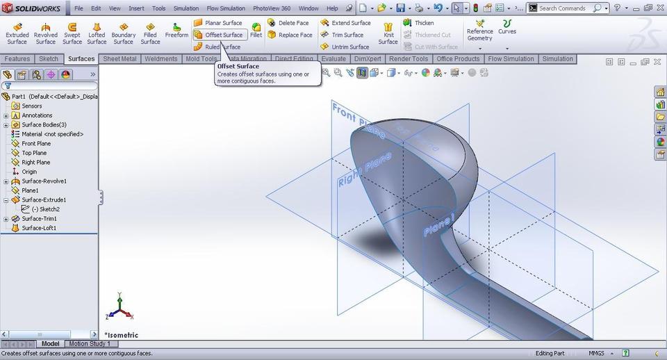

      Under surfaces tab select offset surface.
      Medium
    20. Step 20
      Select the top face and change the distance to minimum i.e. about 1.5mm in my case.
      Medium
    21. Step 21

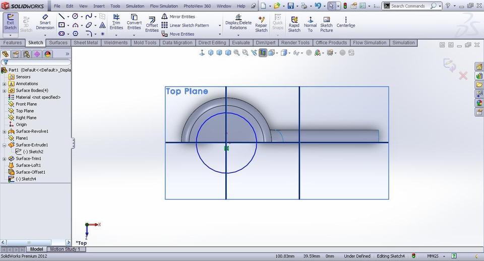

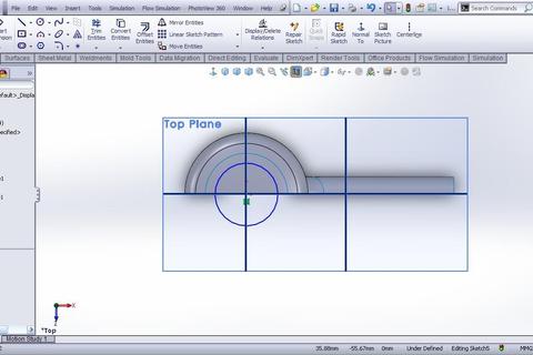

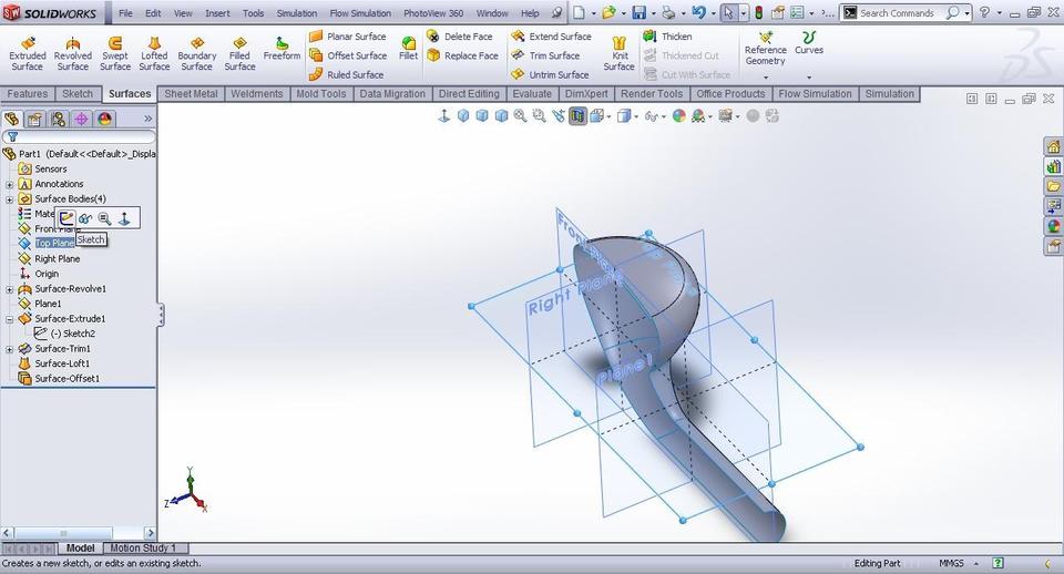

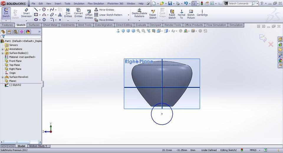

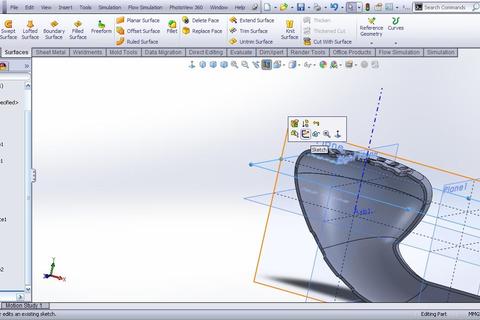

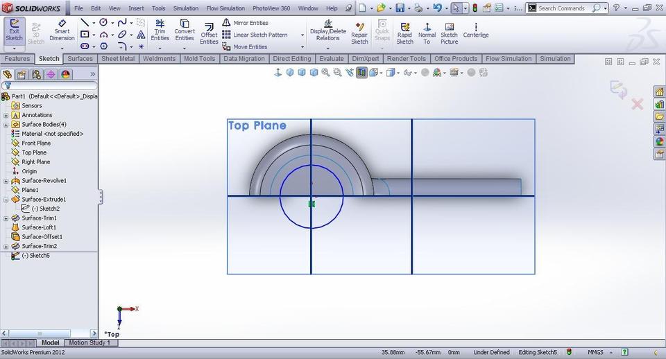

      Now select Top plane and then sketch.
      Medium
    22. Step 22
      Draw a circle.
      Medium

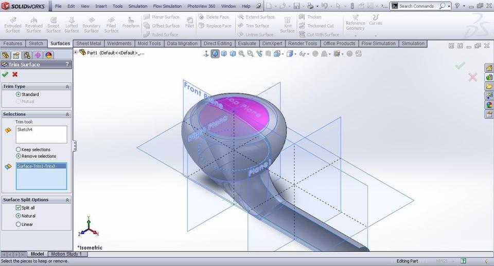

    23. Step 23

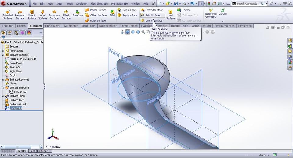

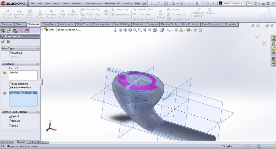

      Medium
    24. Step 24
      Trim the inner portion of the top-most face.
      Medium
    25. Step 25
      Again top plane and then sketch.
      Medium
    26. Step 26
      This time draw a circle considerably smaller than last one.
      Medium
    27. Step 27
      Select trim surface under surfaces tab.
      Medium
    28. Step 28
      Select the outer portion of the offsetted surface.
      Medium
    29. Step 29
      Click OK and the area is trimmed.
      Medium
    30. Step 30

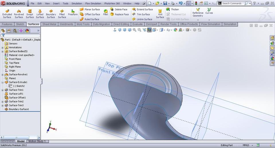

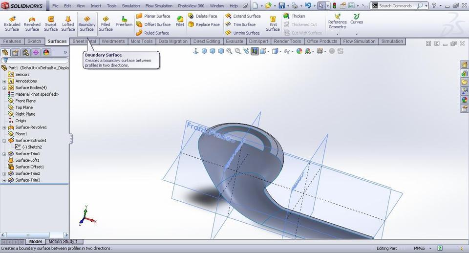

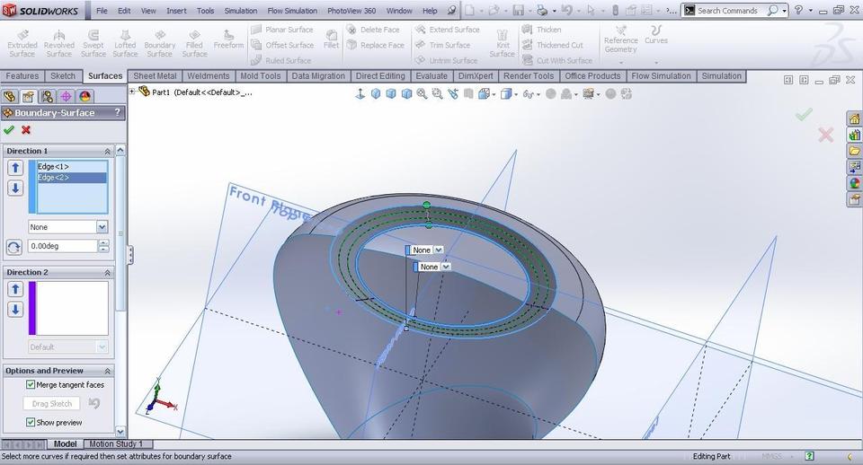

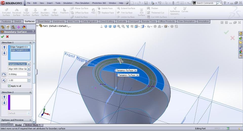

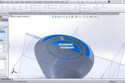

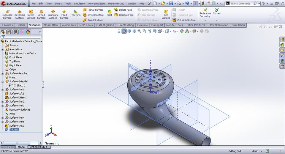

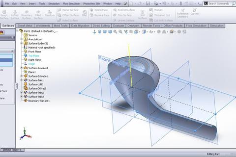

      Under surfaces tab select boundary surface.
      Medium
    31. Step 31
      Select both edges.
      Medium
    32. Step 32
      Select tangency to face for both edges.
      Medium
    33. Step 33
      Click OK.
      Medium

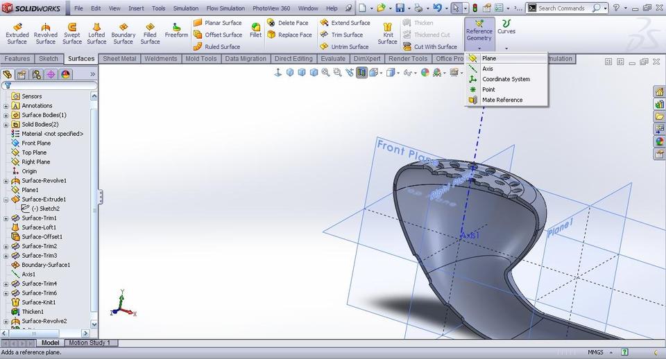

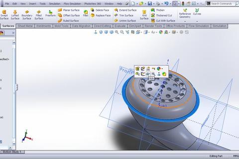

    34. Step 34

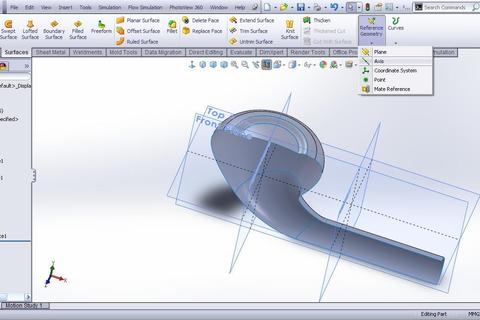

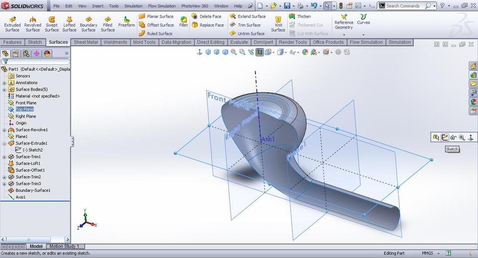

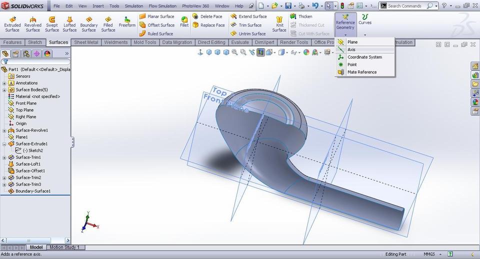

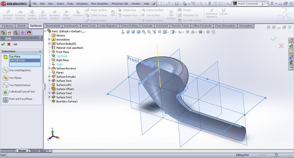

      Now under surfaces or feature tab select reference geometry and then axis.
      Medium
    35. Step 35
      Select top plane and origin. This will create an axis perpendicular to top plane and passing through origin.

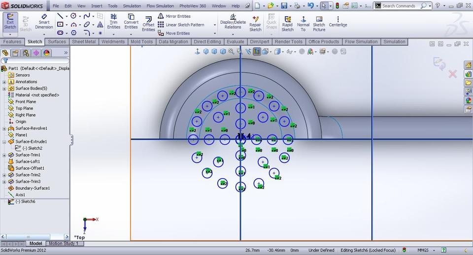

      Medium

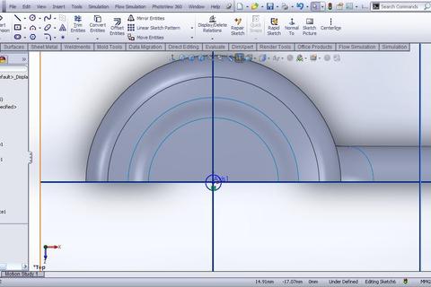

    36. Step 36

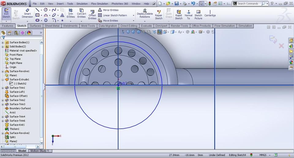

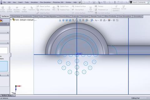

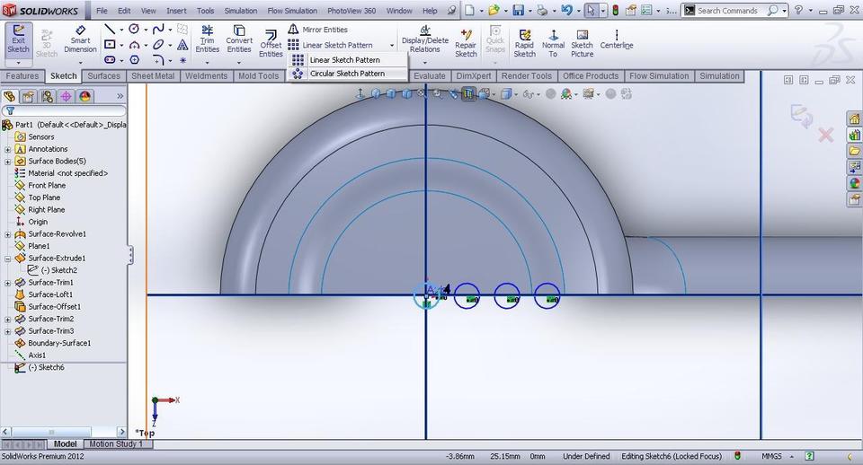

      Now select top plane and then sketch.
      Medium

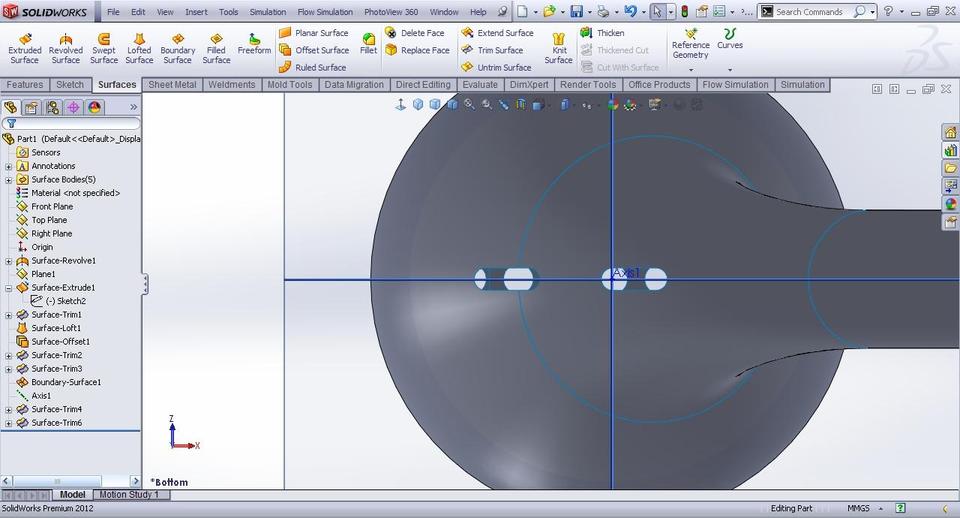

    37. Step 37
      Make a circle for hole.
      Medium

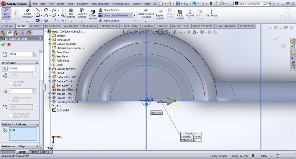

    38. Step 38

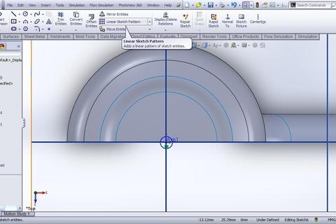

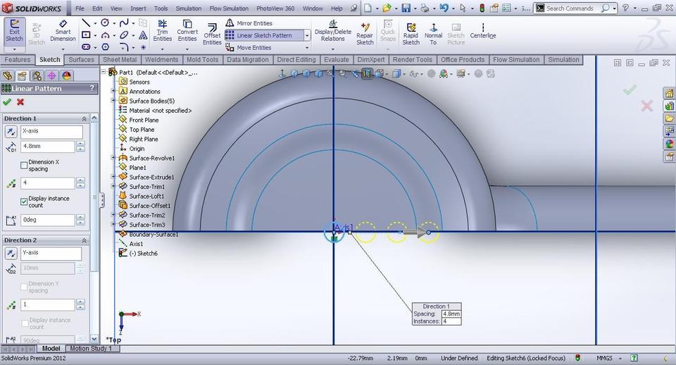

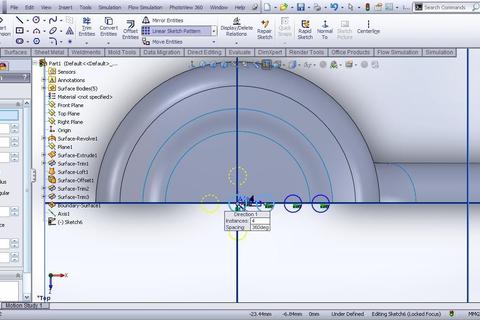

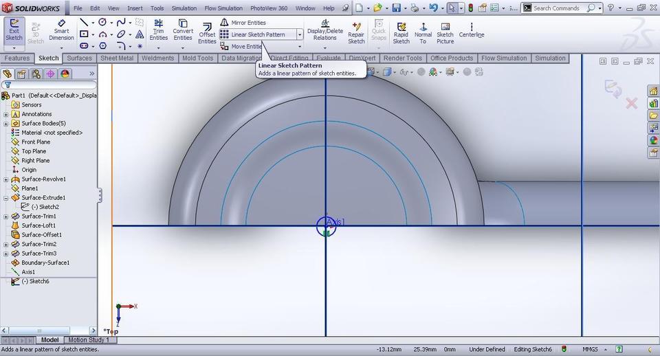

      Now click linear sketch pattern in sketch tab.
      Medium

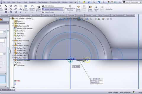

    39. Step 39
      Select the circle to entity to pattern.
      Medium
    40. Step 40
      Adjust the distance and increase the number of instances.
      Medium

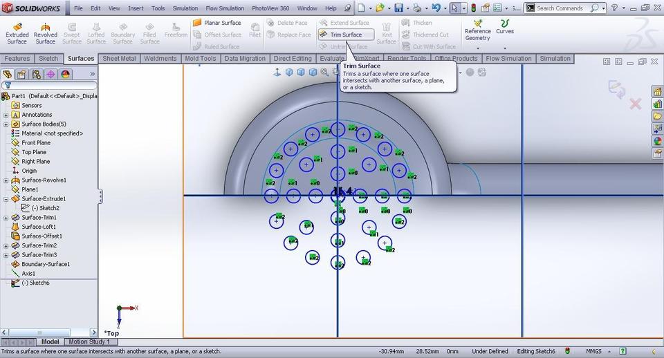

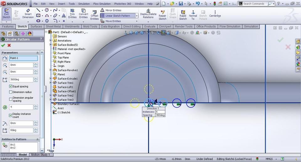

    41. Step 41
      Now select circular sketch pattern.
      Medium
    42. Step 42
      Now select the 2nd circle to pattern.
      Medium

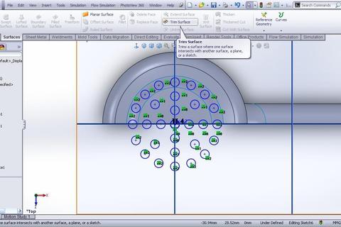

    43. Step 43
      Repeat the same step for other circles increasing the number of instances each time.
      Medium
    44. Step 44

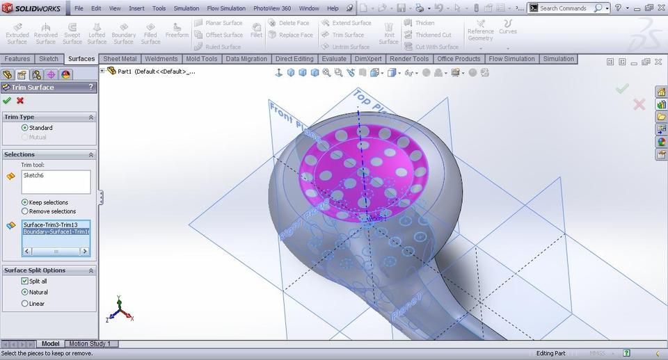

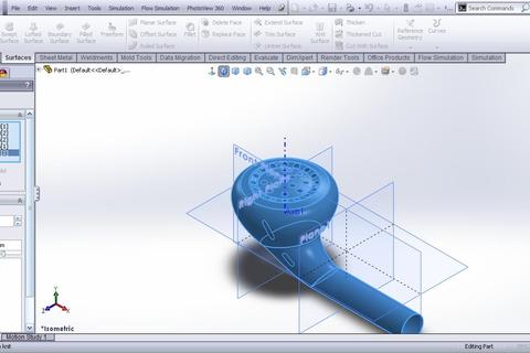

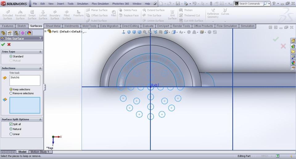

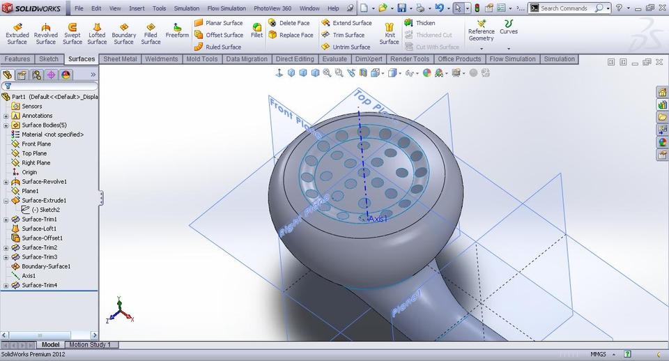

      Under surface tab select trim surface.
      Medium
    45. Step 45
      Now select keep selection.
      Medium
    46. Step 46
      Select the excluded surface of holes.
      Medium
    47. Step 47
      Click OK and the surface is trimmed.
      Medium

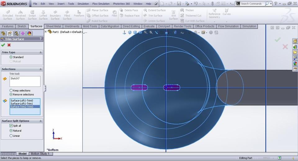

    48. Step 48

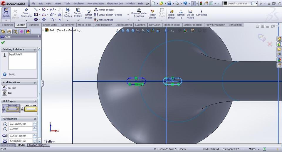

      Medium
    49. Step 49

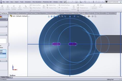

      Use slot tool to make 2 slots.
      Medium
    50. Step 50
      Now select trim surface in surface tab and select remove selection. Select the surface bounded in slots and click OK.
      Medium

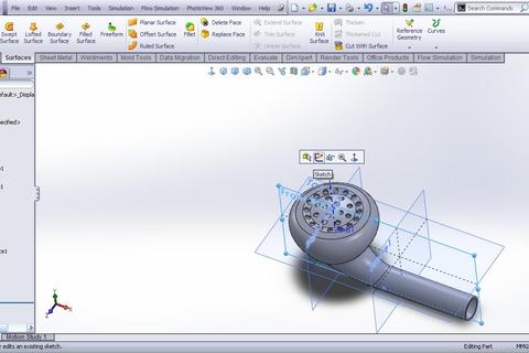

    51. Step 51
      Now we have the space for the air.
      Medium
    52. Step 52

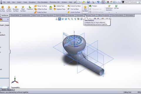

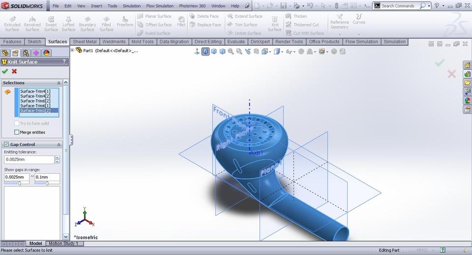

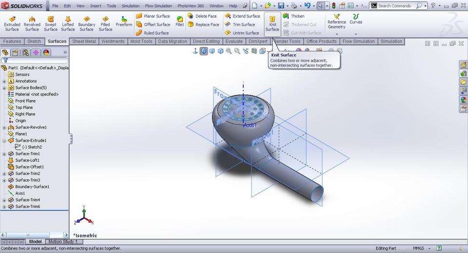

      Select knit surface under surface tab.
      Medium
    53. Step 53
      Select all surfaces one by one and then click OK.
      Medium
    54. Step 54

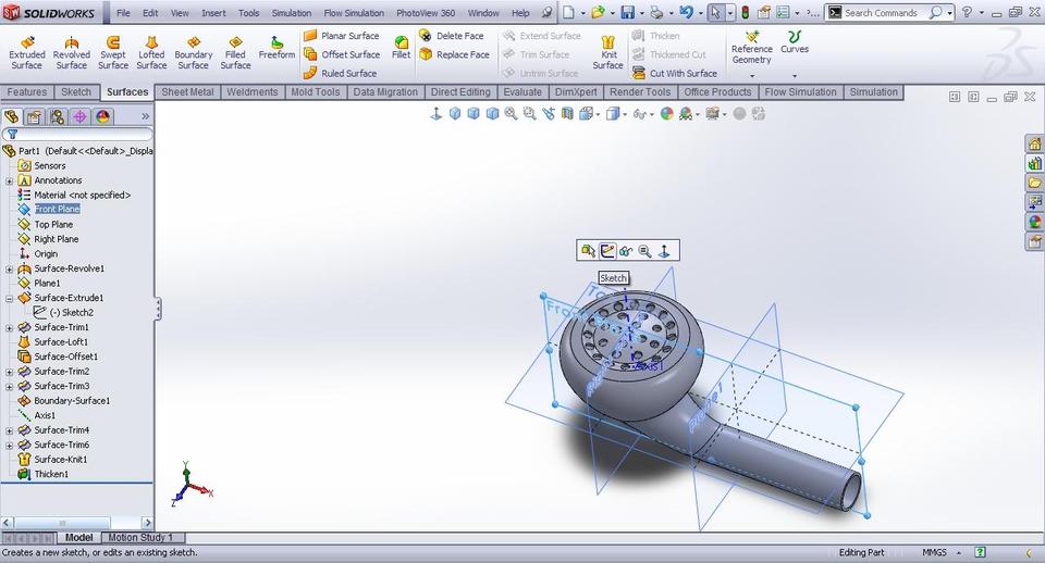

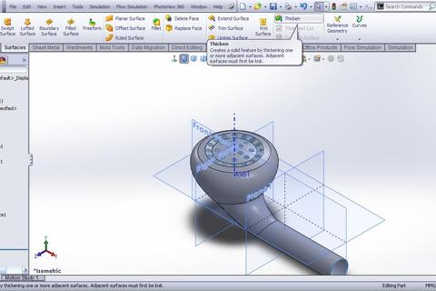

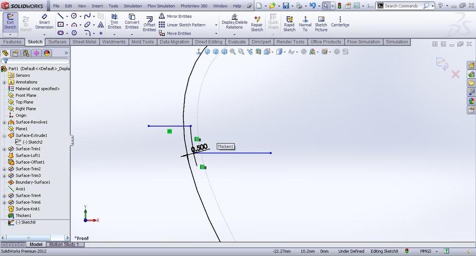

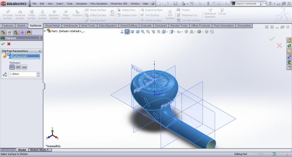

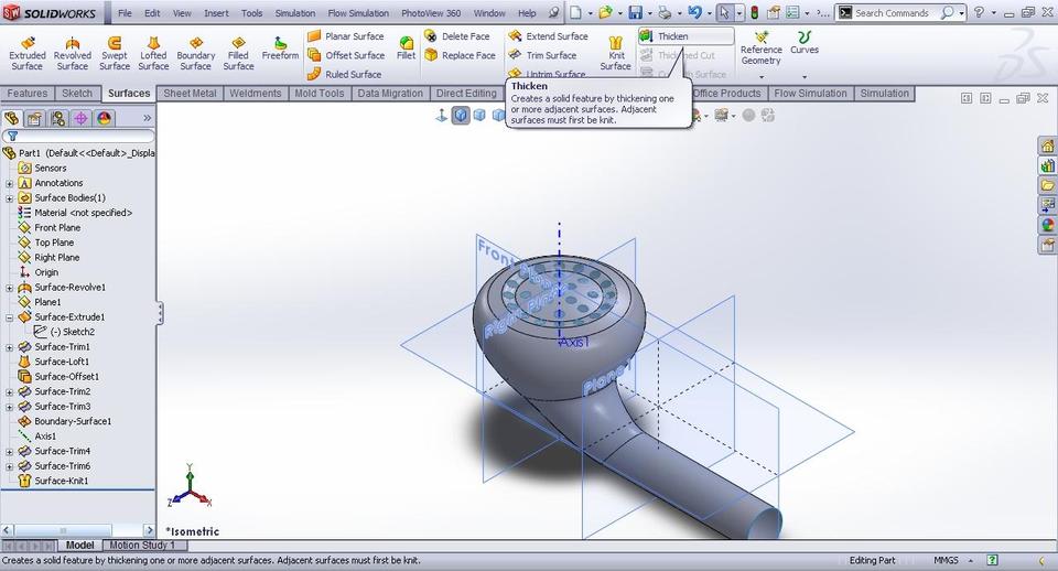

      Under surface tab select thicken.
      Medium
    55. Step 55
      Select the surface. It will select Knit surface feature. Change the thicken distance to 1mm and outside direction. Click OK.
      Medium
    56. Step 56
      Now we have solid body of the earphone. We will now seperate the bodies.
      Medium
    57. Step 57

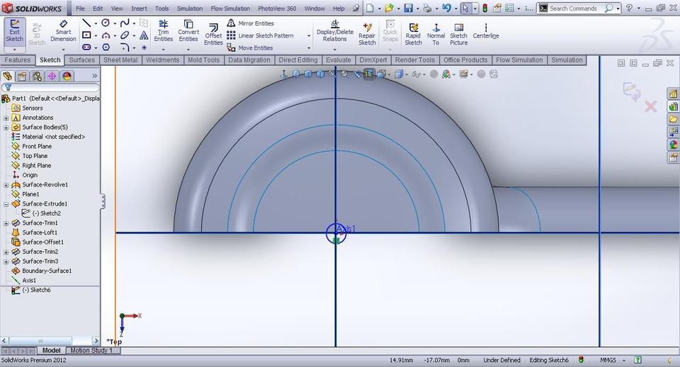

      Select top plane and then sketch.
      Medium
    58. Step 58
      Change view to hidden with shaded line.
      Medium
    59. Step 59
      Offset the edge by 0.50mm and then draw two straight line horizontally. Trim other entities.
      Medium
    60. Step 60

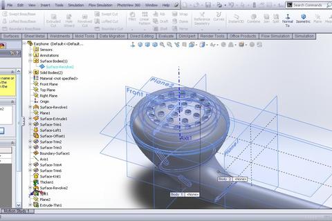

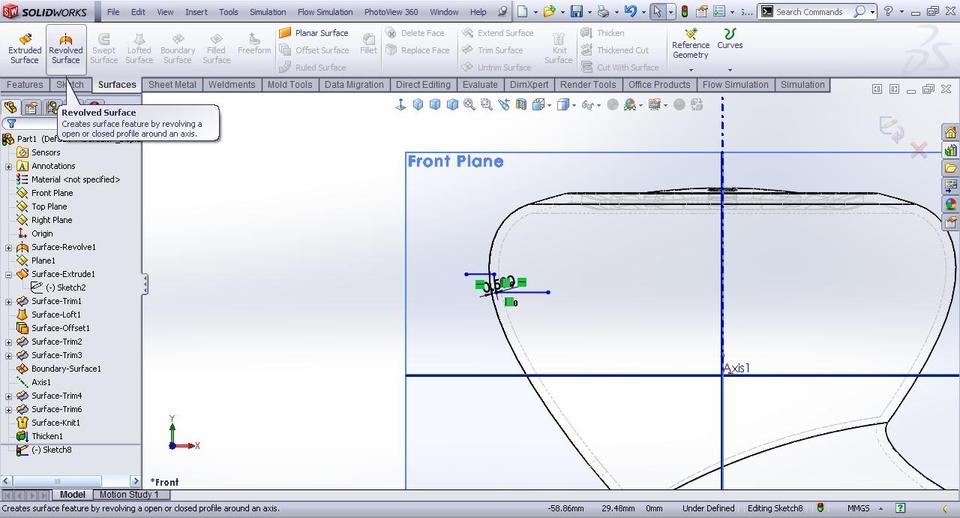

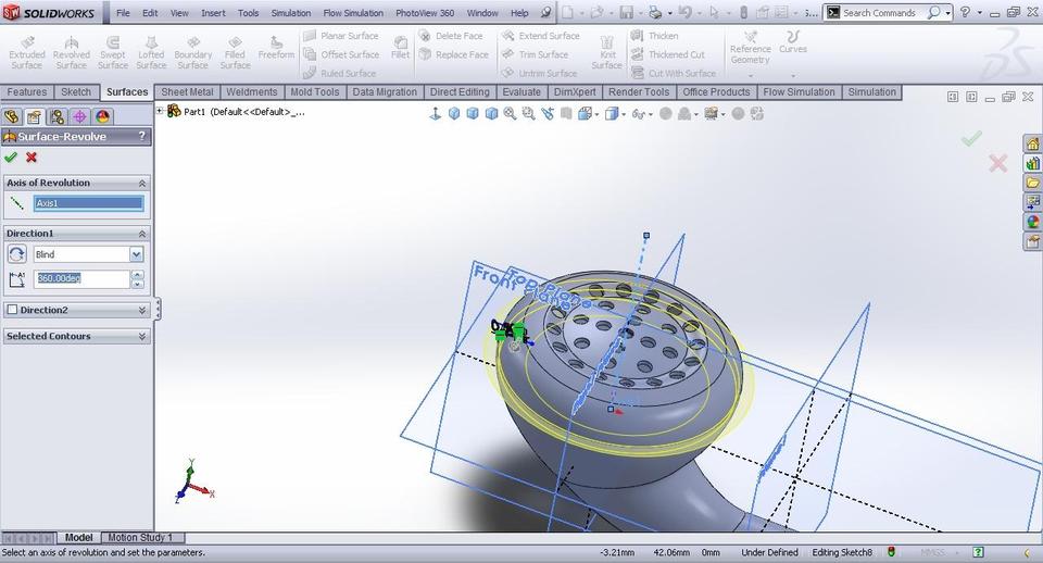

      Select revolved surface in surface tab.
      Medium
    61. Step 61
      Select axis1 and click OK.
      Medium
    62. Step 62

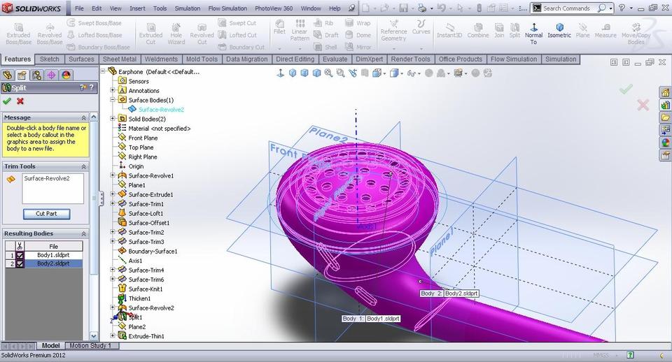

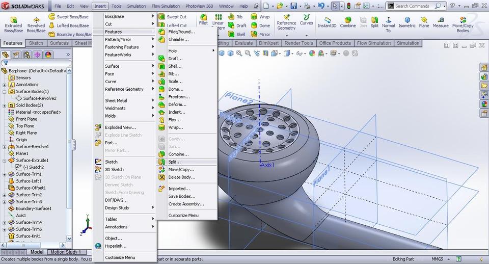

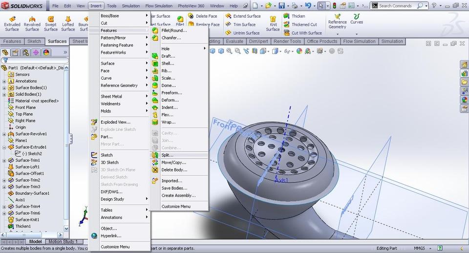

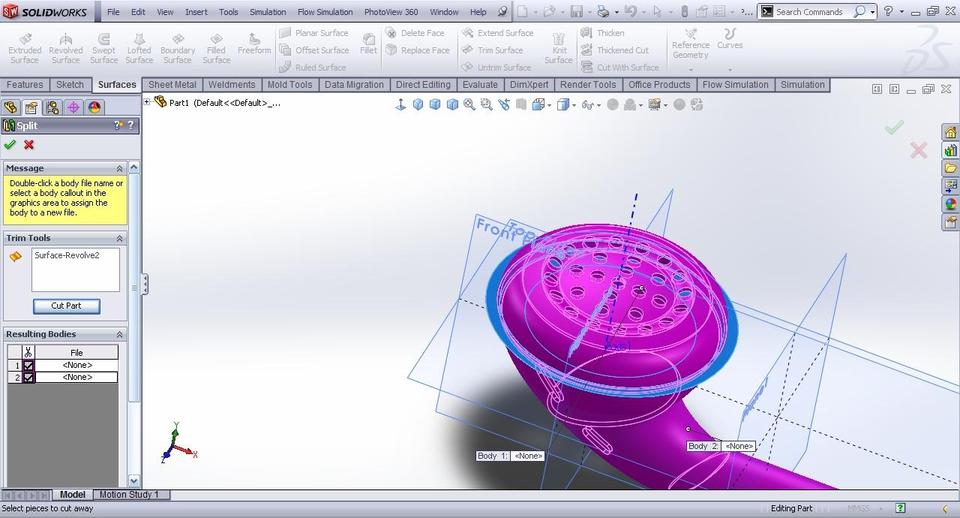

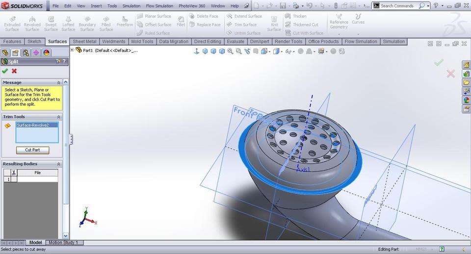

      Go to insert menu then feautres >> split.
      Medium
    63. Step 63
      Select the revolved surface as the trim tool and click cut part.
      Medium
    64. Step 64
      Now check both the bodies and click OK. This feature will generate two split bodies by the revolved surface.
      Medium
    65. Step 65

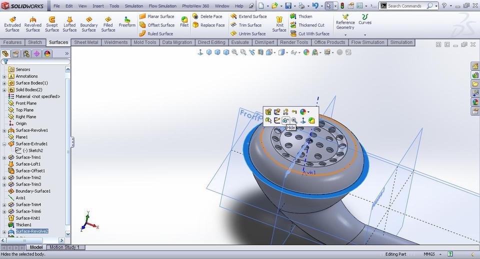

      Now hide the revolved surface.
      Medium
    66. Step 66

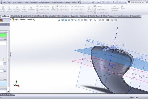

      Again select section view about front plane in standard view toolbar.
      Medium
    67. Step 67

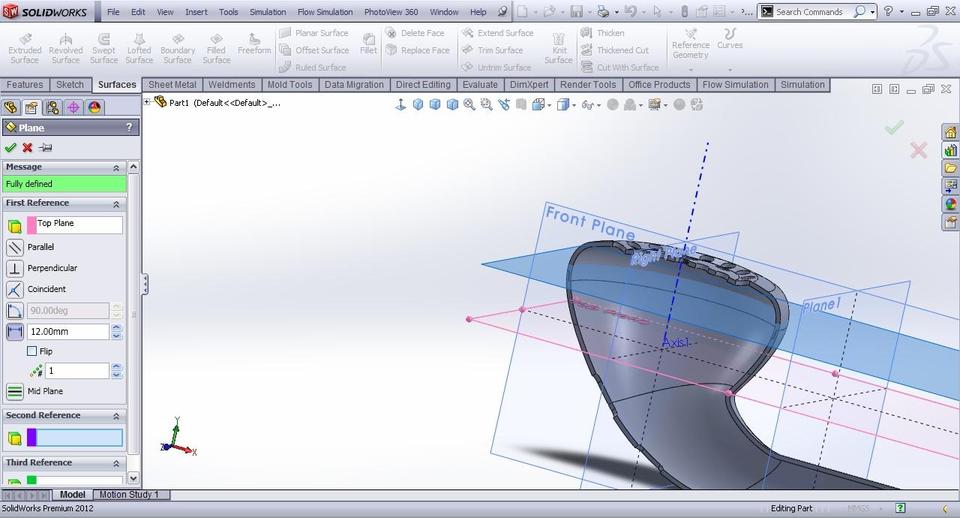

      Select reference geometry and then plane under surface or features tab.
      Medium
    68. Step 68
      Select top plane and then offset it by a distance so that it will lie in the upper body.
      Medium
    69. Step 69

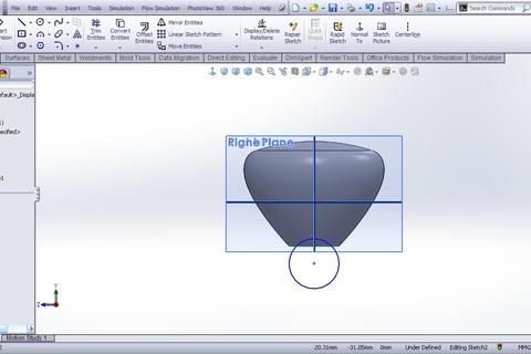

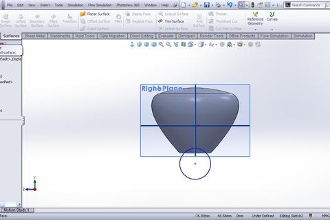

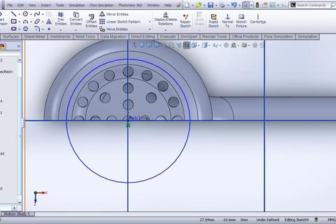

      Select the plane2 and then sketch.
      Medium
    70. Step 70
      Draw a circle larger than the region bounded by the holes.

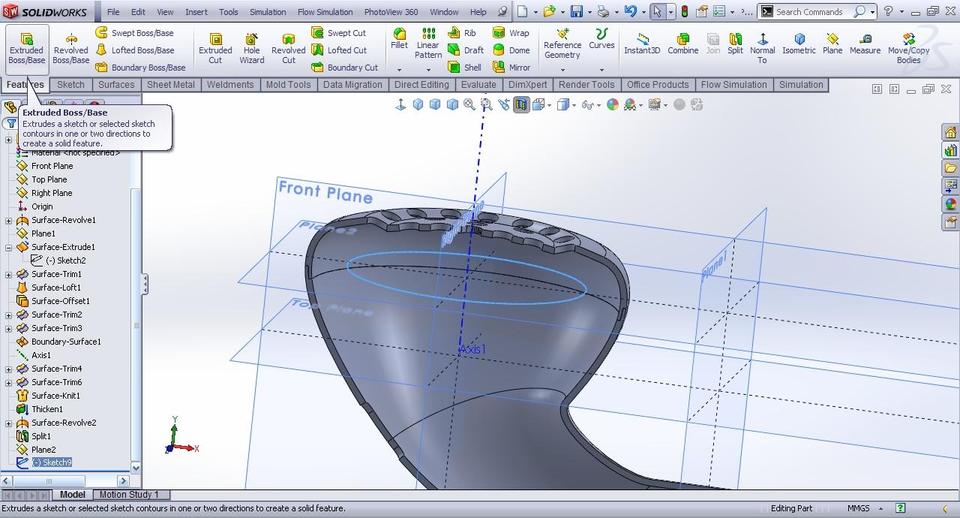

      Medium
    71. Step 71

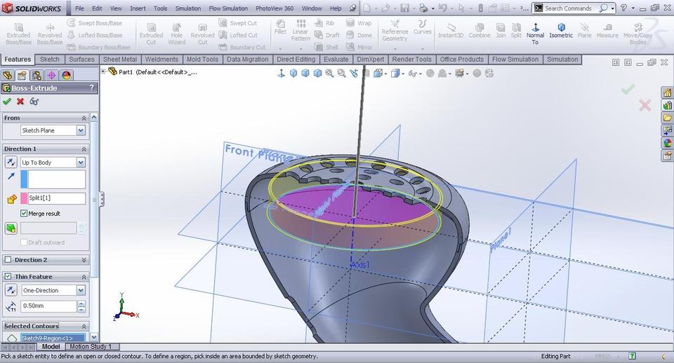

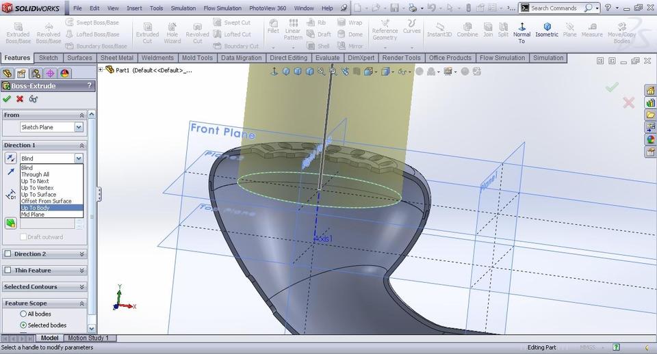

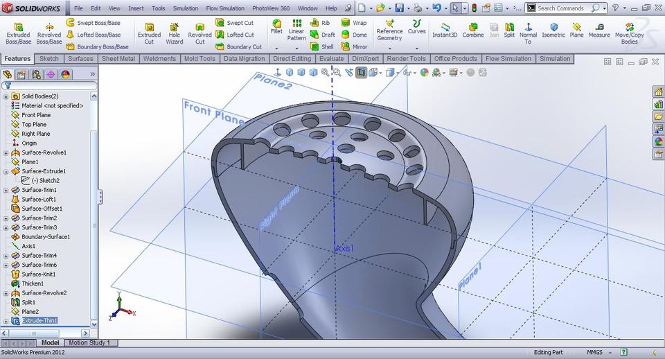

      Under features tab click extruded boss/base feature.
      Medium
    72. Step 72
      Under direction1 select up to body.
      Medium
    73. Step 73
      Select the upper body and enable thin feature by a distance of 0.50mm. Click OK.
      Medium
    74. Step 74

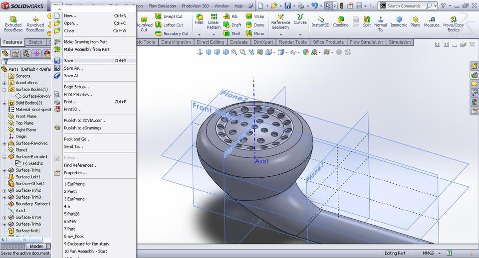

      Now we have the body for the speaker of ear phone.
      Medium
    75. Step 75

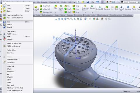

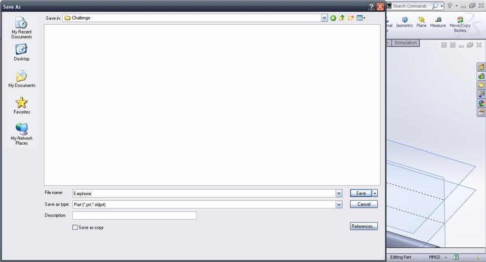

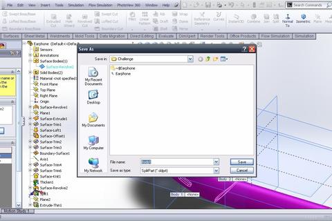

      Now click file save.
      Medium

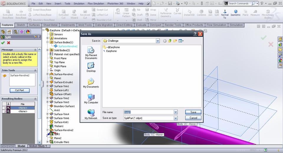

    76. Step 76
      Enter any file name for the part document. I entered earphone for myself.
      Medium

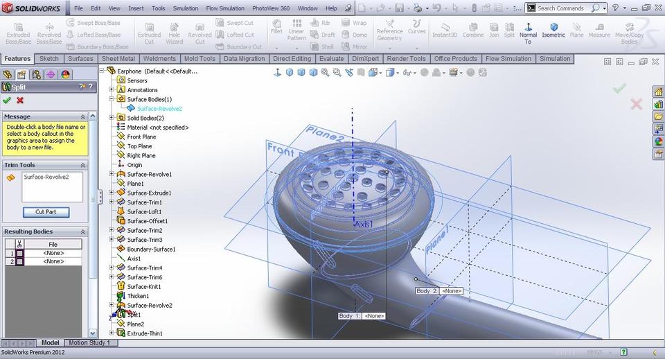

    77. Step 77

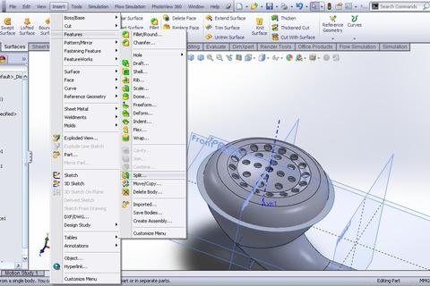

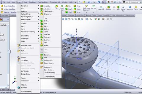

      After saving part click insert>>feature and then split.
      Medium
    78. Step 78
      Again select revolved surface2 from the surface bodies under tree view and click cut part.
      Medium
    79. Step 79
      Double click the cut body1 and save it.
      Medium
    80. Step 80
      Repeat the same step for the other body and click OK.
      Medium
    81. Step 81

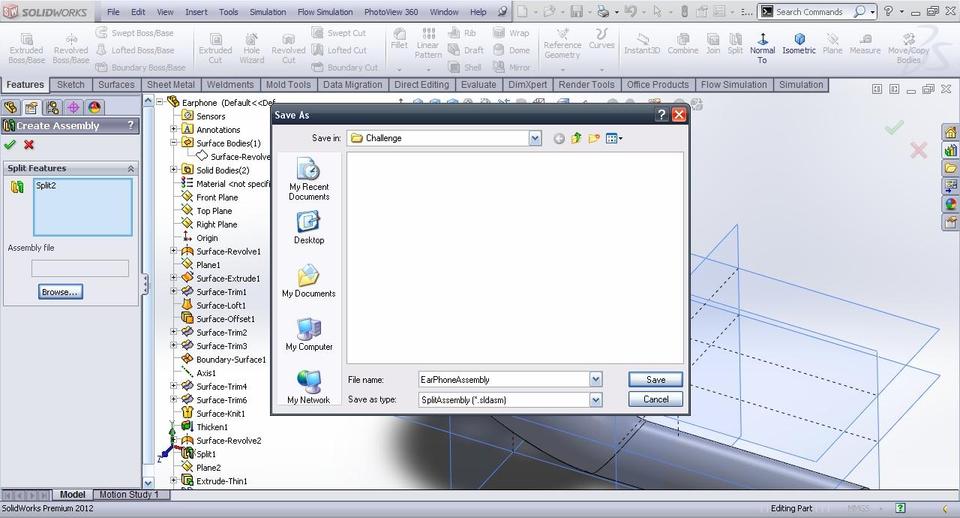

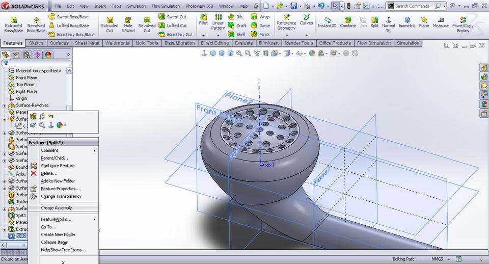

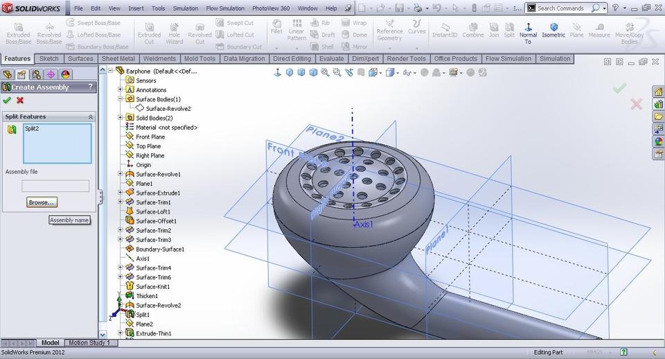

      Now right click the split2 feature and then select create assembly.
      Medium
    82. Step 82

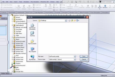

      Click browse.
      Medium
    83. Step 83
      Now save the assembly file for the splitted part document.
      Medium
    84. Step 84

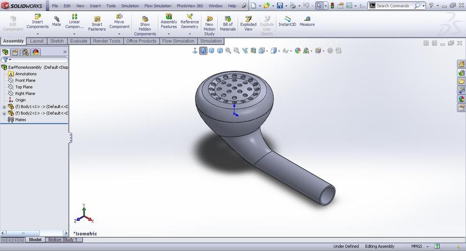

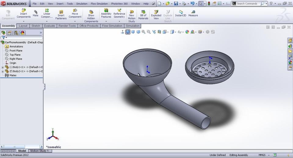

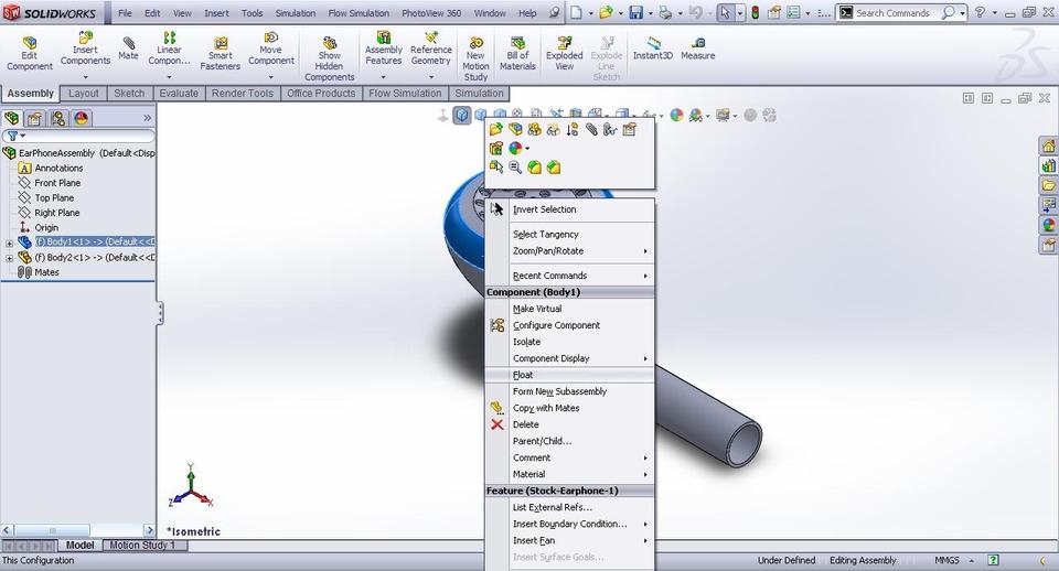

      Now the assembly file will open.
      Medium
    85. Step 85
      Right click the upper body and select float.
      Medium
    86. Step 86
      Move it and then rotate it to have a better view.

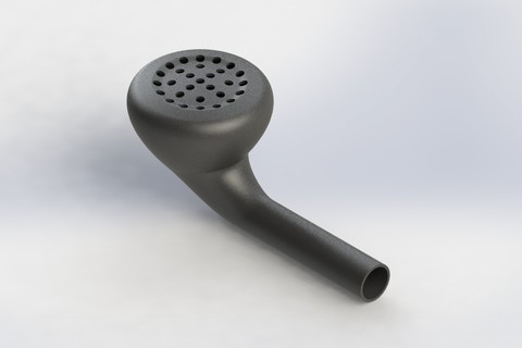

      Medium

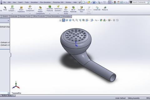

    87. Step 87

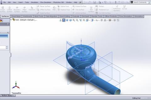

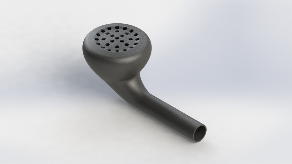

      Here is the rendered image of the earphone. This one is not much better than the last one but you can make one better if done with care.
      Medium
