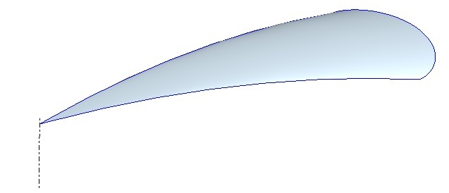

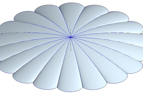

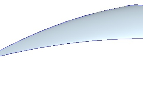

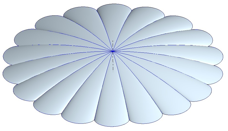

    frei 6 months ago
    To create model glass. However, shape of surfaces this model is not the same how from the WindDancer.
    1. Step 1
      1 Draw sketch two neighboring curves outgoing from the center and sketch third closing curve.
      Medium
    2. Step 2
      2 Make a surface from three curves. Obtain a surface of a disk sector.
      Medium
    3. Step 3
      3 Now you can give a thickness for this sector, and then create array from it. Or you can create a first surface of the disk, and then give a thikness for the disk.
