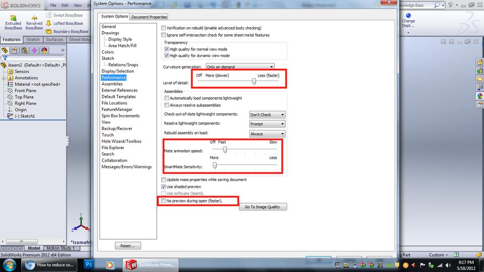

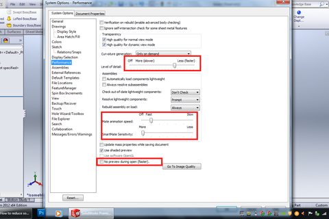

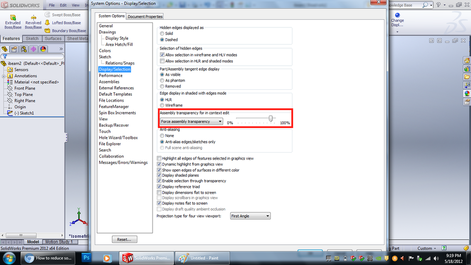

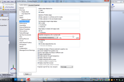

    Try Changing these options (under Tools >> Options)
    1. Step 1
      1
      Medium
    2. Step 2
      2
      Medium

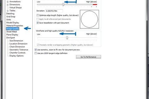

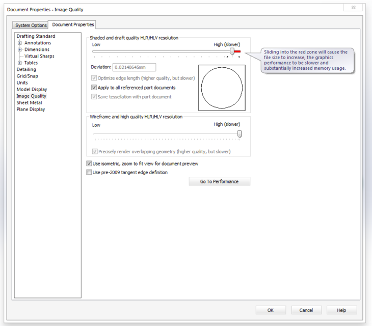

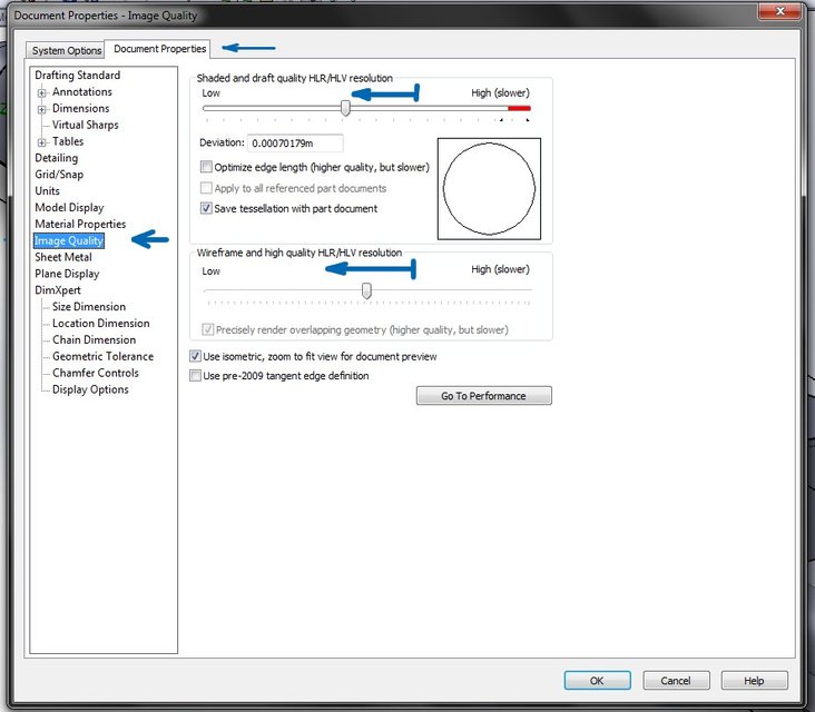

  • J E Paz
    J E Paz 11 months ago
    Suhdir you missed this one =)
    1. Step 1
      the lowest you select the faster your PC will work... I think this one is the one that affects the most to the performance
      What this does is decrease the detail of the curvature
      Medium

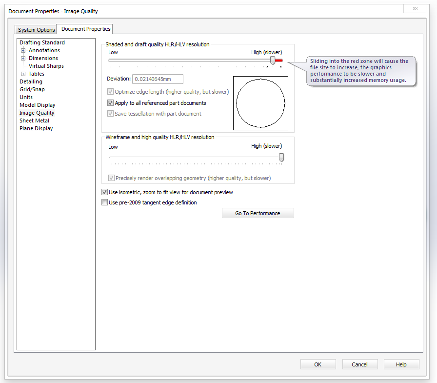

  • Robert Voogt
    Robert Voogt about 1 year ago
    Or, set the "shaded and draft quality HLR/HLV resolution" lower. This will also decrease the file size.
    The "wireframe and high quality HLR/HLV resolution" can also be set lower, but I never experienced more or less lag with this option.
