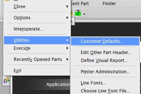

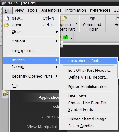

    1. Step 1
      Start NX 7.5 but do not creat a new model. Go to File > Utilities > Customer Defaults
      Medium

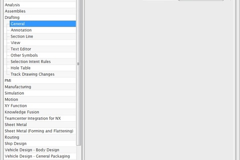

    2. Step 2
      In the Customer Defaults window go to Drafting here you can set all NX 7.5 files to one default setting.
      Medium
