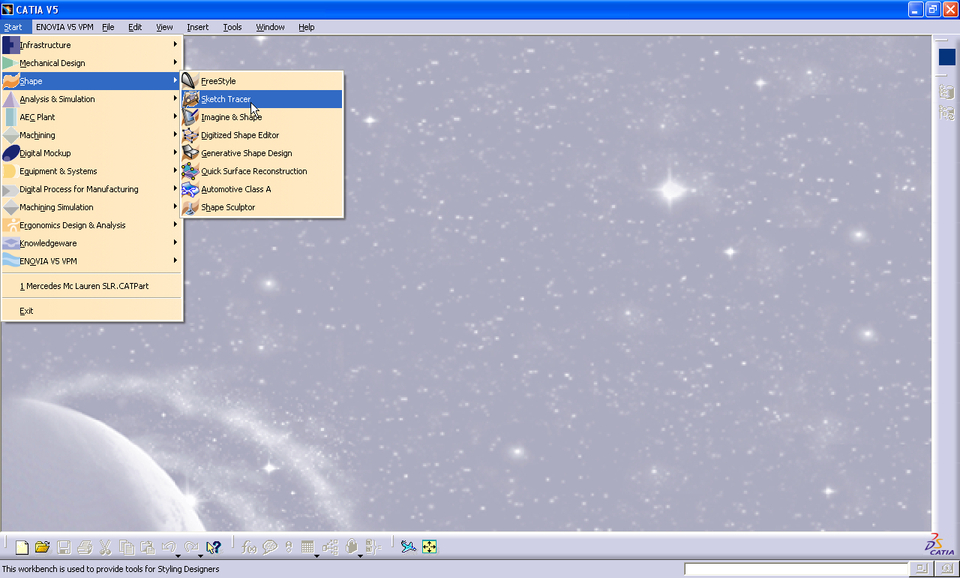

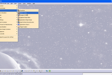

    1. Step 1
      Start-> shape-> sketch tracer
      Medium

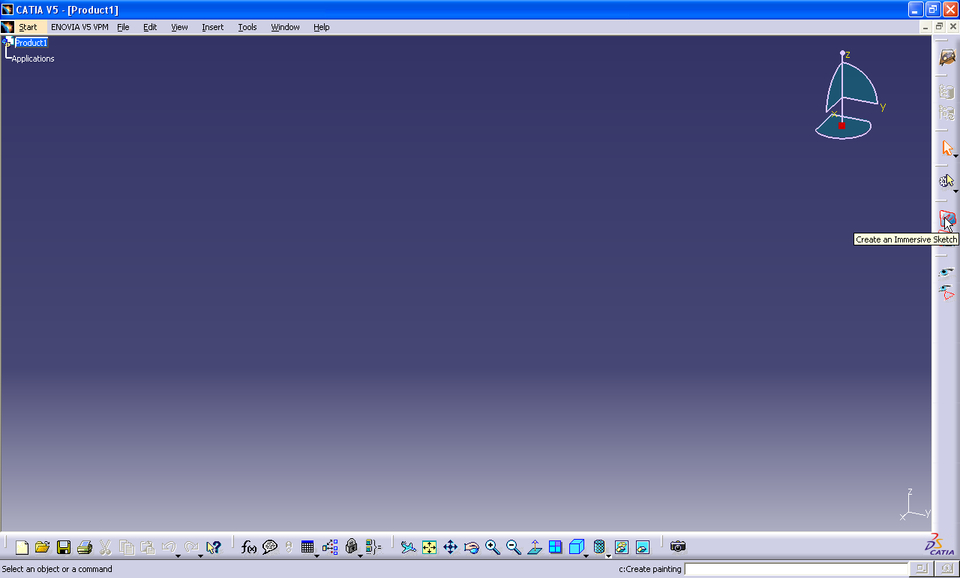

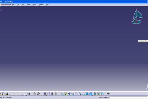

    2. Step 2
      Create an immersive sketch
      Medium

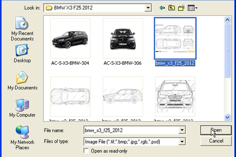

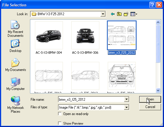

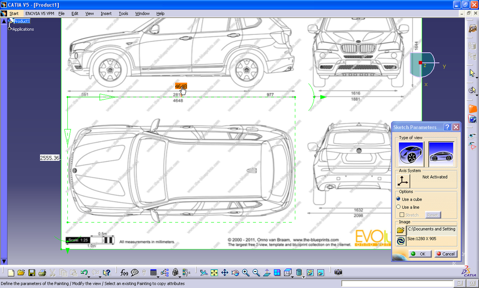

    3. Step 3
      Open the blueprint's jpeg file you want to use
      Medium

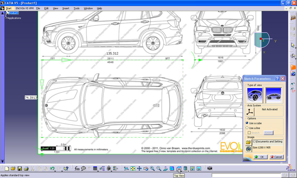

    4. Step 4
      Use the type of view you want from the menu above the status bar.
      Medium

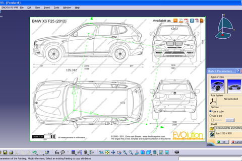

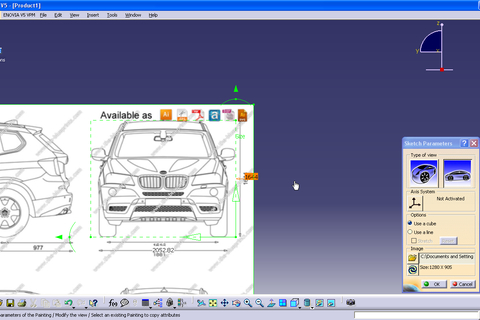

    5. Step 5
      Adjust the size by dragging the points and arrows
      Medium

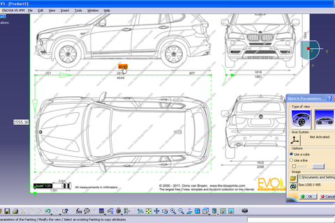

    6. Step 6
      Edit the values accordingly.
      Medium

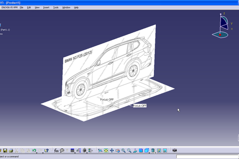

    7. Step 7
      By following a similar process get the other views also.
      Medium

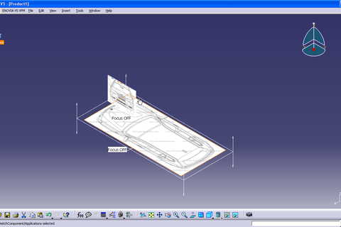

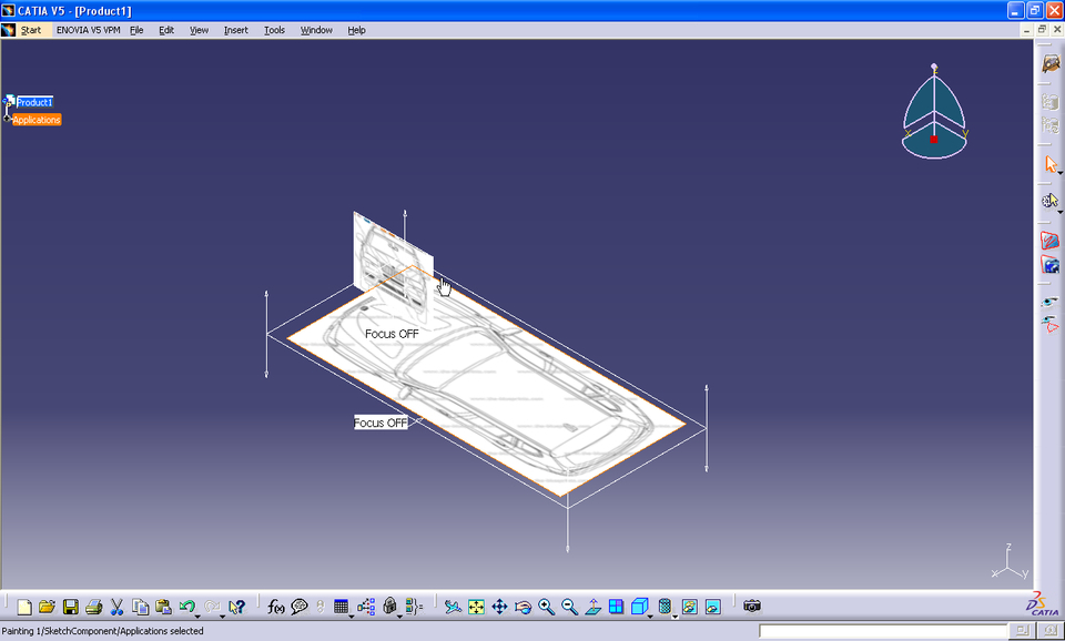

    8. Step 8
      Now get back to isometric view. From there click on the different views. You will get the arrows as shown in the figure. Drag the arrows to reposition the sketch according to your requirement.
      Medium
