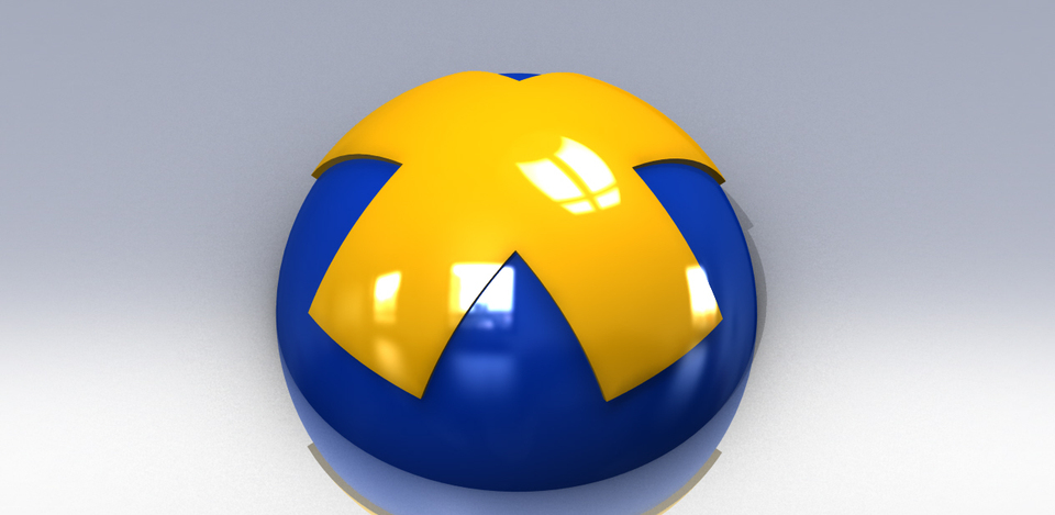

  • Aaron
    Aaron over 1 year ago
    It was really nothing. I was trying to wrap an X over a sphere and months ago I was trying to "wrap" it and make it harder than it needed to be. I just made two revolves to make the X. It was one of those DUH moments.
    Added images

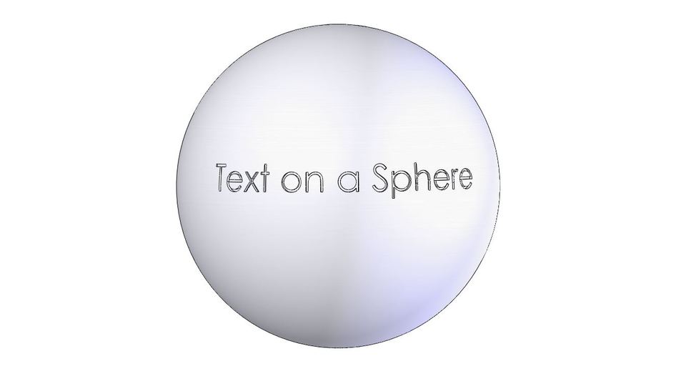

  • Don Anneken
    Don Anneken over 1 year ago
    Please see if this is what you want...
    Text (Wraped) on a Sphere. SolidWorks 2011
    Added images
    Square
    Text on a Sphere.SLDPRT, 1.13 MB
    Download

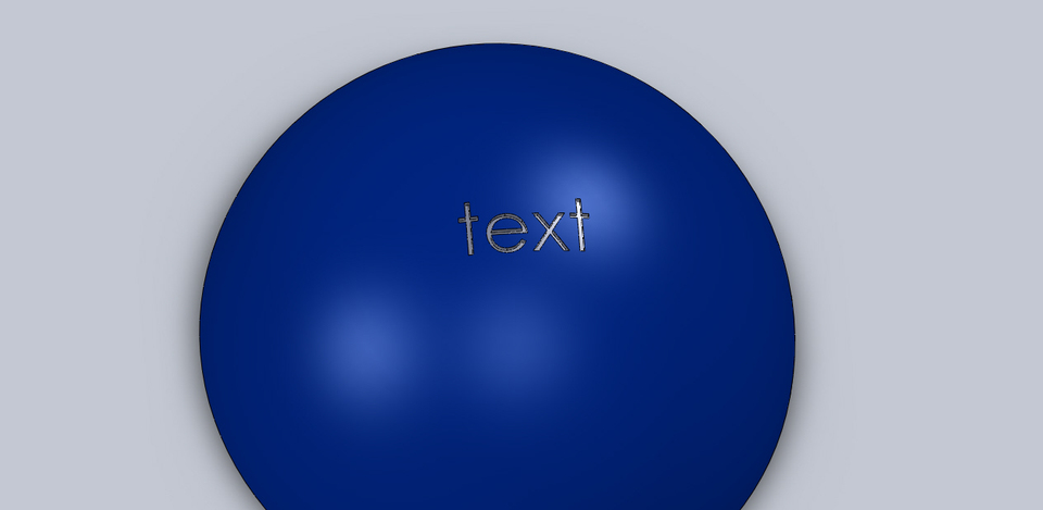

  • Aaron
    I did just do this method, maybe the same as what Don did? Can someone verify?
    Added images
    Square
    wrap test sphere.SLDPRT, 334 KB
    Download
