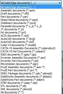

  • marek
    marek 12 months ago
    SE ST4 can open next files. This can be done in assembly or part enviroment.
    Added images

  • Dominic Banister
    Dominic Banister 12 months ago
    Thanks very much everyone. I got hold of a trail version of SE and it's opened the SolidWorks files fine
