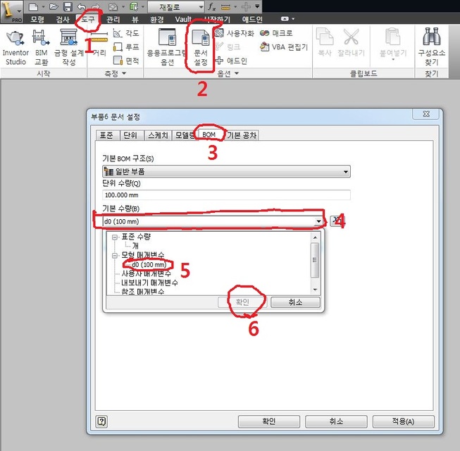

    see the attach file..
    my inventor is korean ver.
    follow number
    Open your part(not ass'y)
    1. Tools
    2. Document setting
    3. BOM
    4. click box
    5. choose one dimension
    6. OK
    You must using 'user parameter'
    Added images
    Square
    SAMPLE.ipt, 71 KB
    Download

    It works, but is their a way that I can set this up to always be read with out me having to assign it on every part? I am working with casework all the time and the parts are mostly panels and hardware... I just need to the panels called out for production and also for material purchasing.
