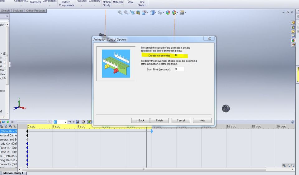

    You can set the duration of the exploded view in the dialog box that opens once you click on animation wizard. You can also set the start time of the exploded view video.
    Added images
