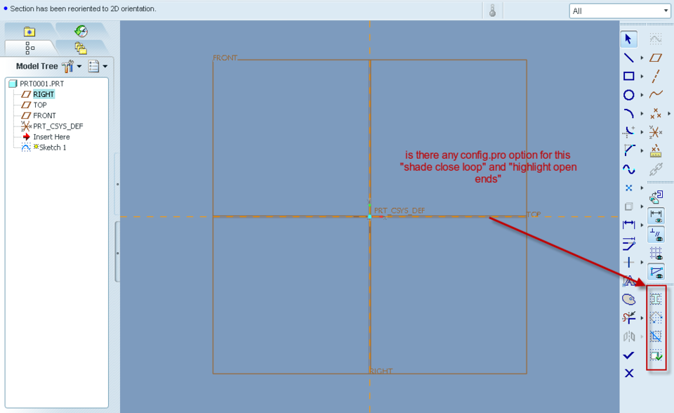

Is there anything config.pro option for "shade close loop" and "highlight open end" in pro/engineer sketch environment ?
By e19 on 14 Jun 22:14 1 answer 365 views 2 comments
i try searching for it,but in vain,these are quite powerful option,it does remain active for entire session,but better if there is config.pro option.
i have attached image as for what i am asking.
http://i.imgur.com/mHNXV.png
Added images

    It should always be present if you are using (what I believe to be) Wildfire 5.0.
    If it is not there, you do not need to touch the config.pro file, but rather look at your config.win settings. You can do this by going to Tools >> Customize Screen whilst you are in sketcher.
    You then need to go to the Toolbars Tab and Check the box that says Sketcher Diagnostics. Make sure the "Automatically save to ... " box is checked as well, then click OK.
    You shouldn't be missing the sketcher diagnostics box after that.
