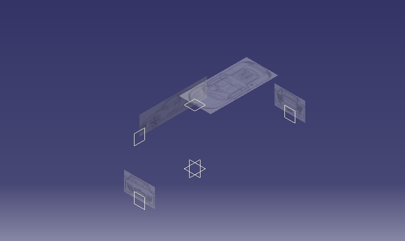

I am new in car modelling and i am learning it from this tutorial- http://www.dicksonsham.com/free/Tut08_e_audiR8.zip
I have given a image of my work progress after that i stuck there because i am new in freestyle so i am unable to understand next steps .so friends pls help me.

after looking at your progress as seen in the above image i believe you got stuck here "creating curves in the respective views (top,side,front) using free style.let me know that i'm right about it i'll help you
Yes you are right. Now I am learning freestyle and also I am practicing other dicksonshams tut. I found that in previous (other than audi )tutorials he explained tools in details like mouse, p51 plane etc.so I am learning it by tutorial Sequence . :)
k all the best. here is the link to 13 min video demo hope it will give you a boost
