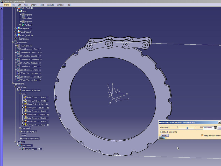

hi,
i am working on how to make chain to simulate around a gear but im not sure how to, can someone pleases help me accomplish this. i am a newbie in catia

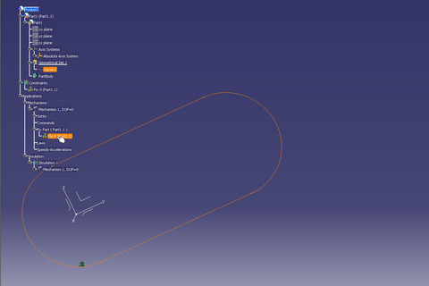

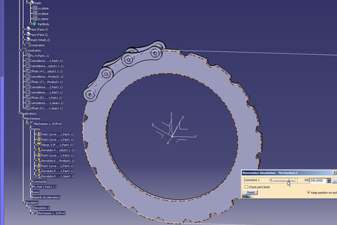

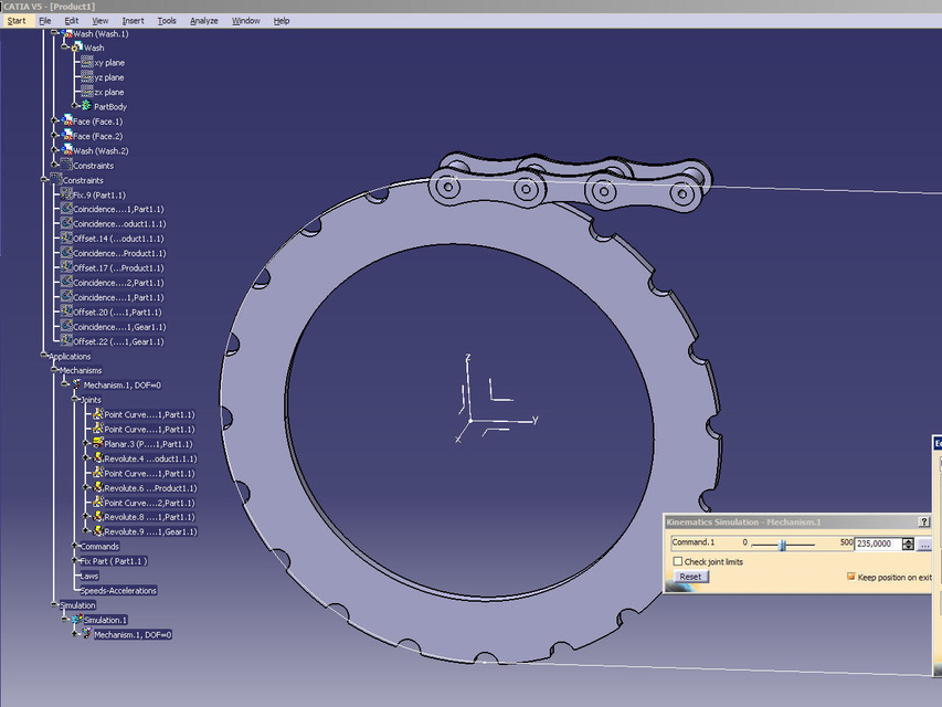

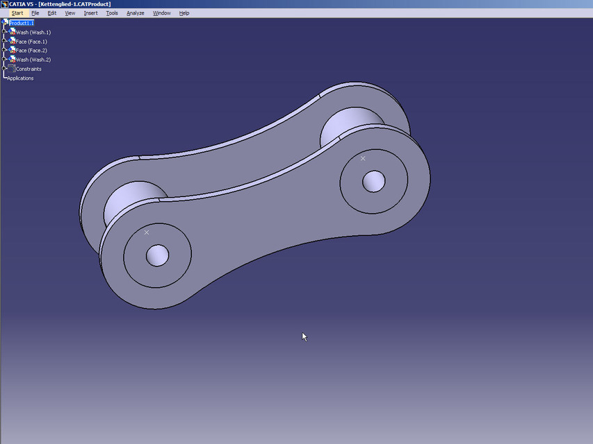

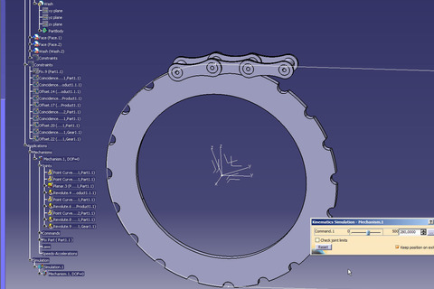

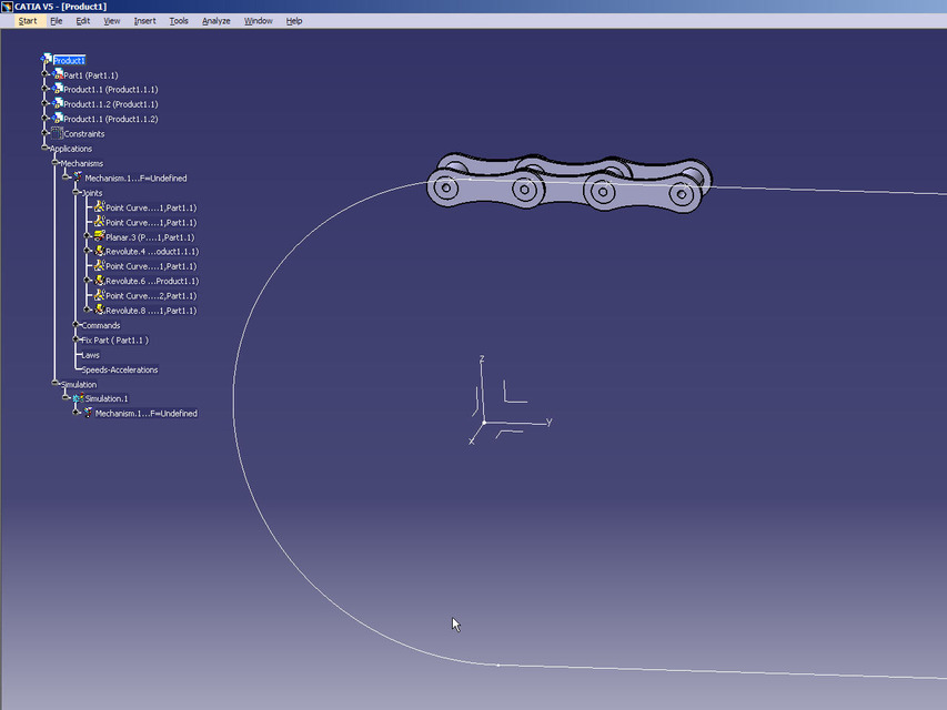

  • KFZ-Schule
    KFZ-Schule about 1 year ago

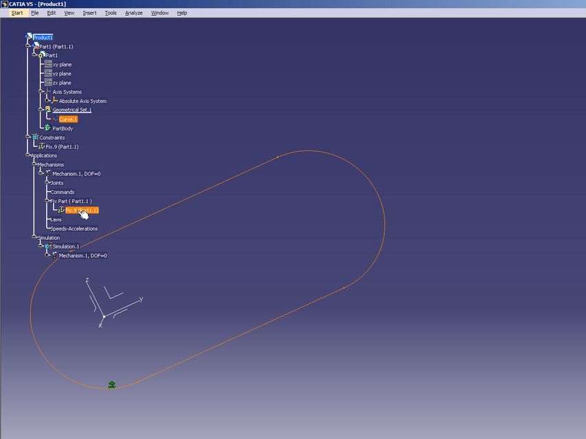

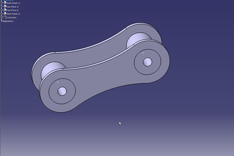

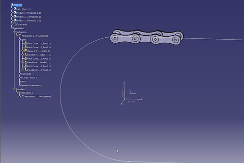

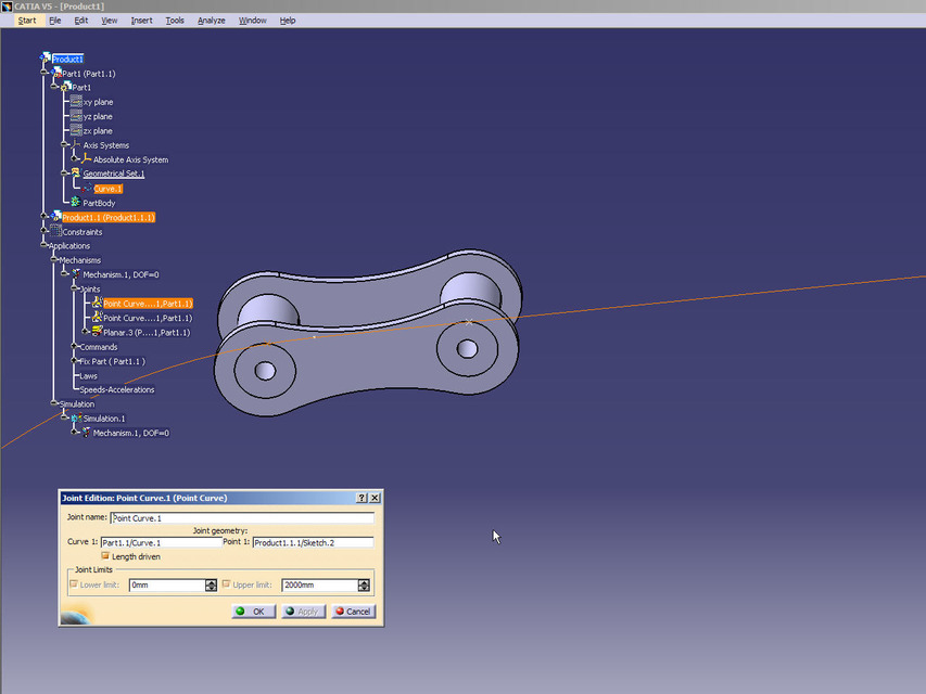

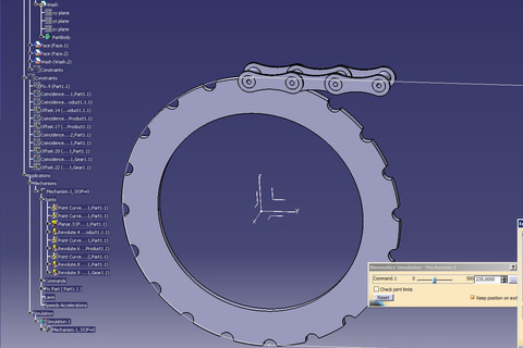

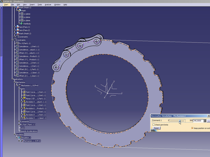

    It is not a real tutorial (because if you are a student you should train your skills ;-)
    1. Step 1
      1. matingpart must be fixed
      Medium
    2. Step 2
      2. Subassemblies will help
      Medium

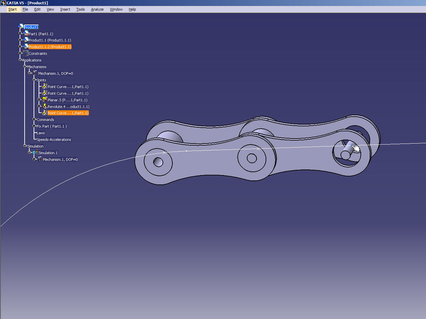

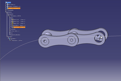

    3. Step 3
      3. make the three joints and you can simulate. move the part around the chain
      Medium

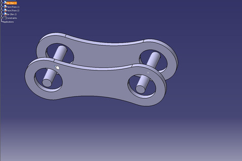

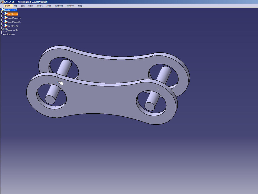

    4. Step 4
      4. another assembly
      Medium
    5. Step 5
      5. the revolute fixes to asm-1, point curve fixes to mating part
      Medium
    6. Step 6
      6. - 129873.
      some stupid work ...
      Medium
    7. Step 7
      7. I am not realy shure about the gear, what happens when a chain part "leaves the gear"?
      Medium
    8. Step 8
      8.
      Medium
    9. Step 9
      9.
      Medium
