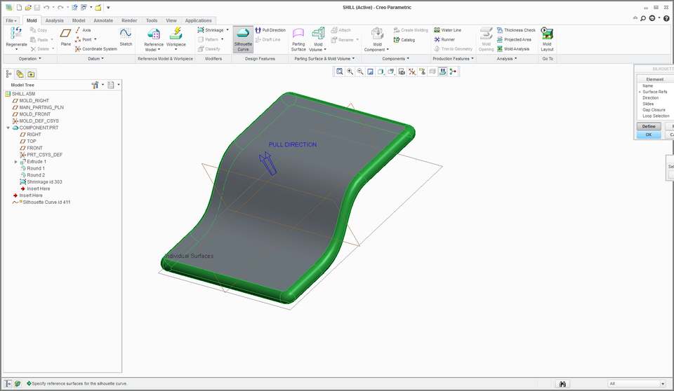

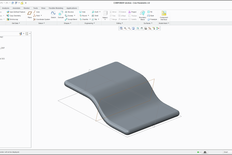

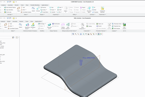

      Generally shelhoutte curve type of parting surface are used for splitting 3D shapped pipes, and components with full round edges. I took a simple plastic component with full round edge as shown in the image

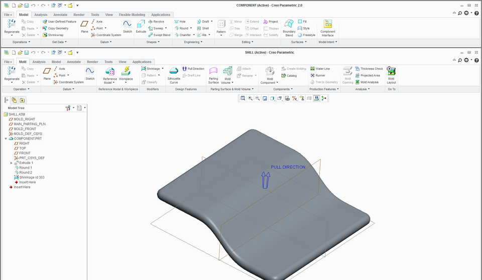

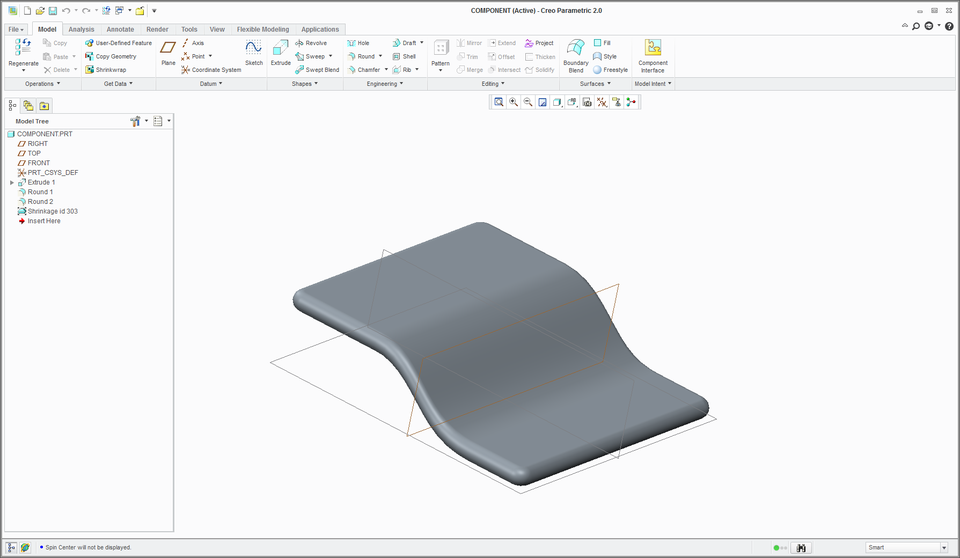

      Refer previous tutorial to assemle the component . else follow these steps
      1-file-new-manufacturing then click mold cavity
      2- Assemble the component as shown in the image

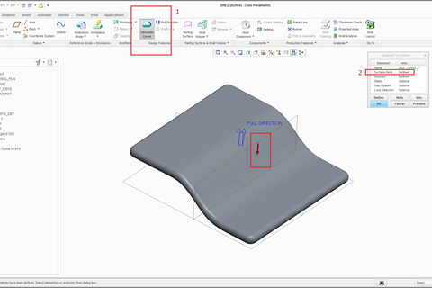

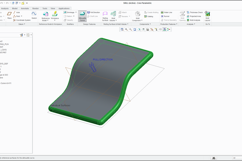

    3. Step 3

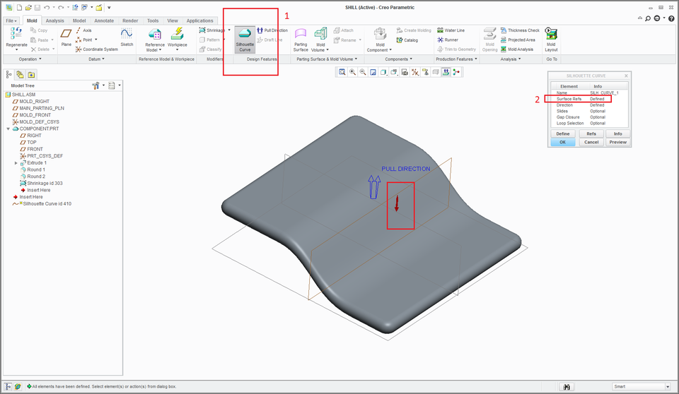

      Once you assebled the component properly , you can click "silhoutte curve" and select the surface. You should select all the full round surfaces as shown in the image
      Medium
    4. Step 4
      Image shows the selected surfaces, for complicated components you need to define the direction plane also
      Medium

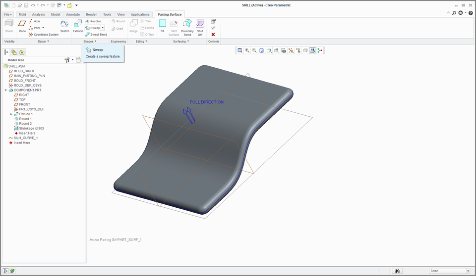

    5. Step 5

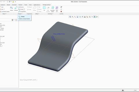

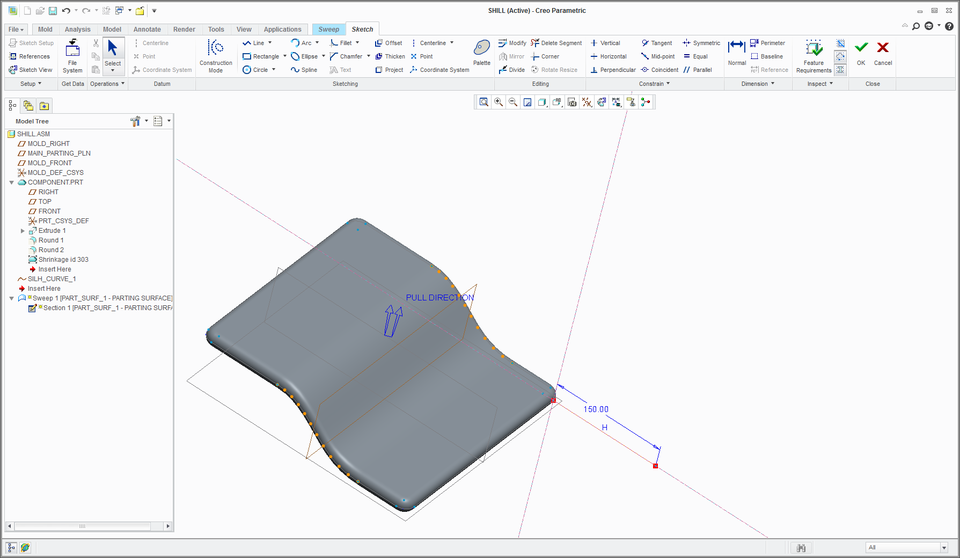

      Now you need to create a parting surface from the created silhoutte curve using sweep feature as shown in the image
      Medium

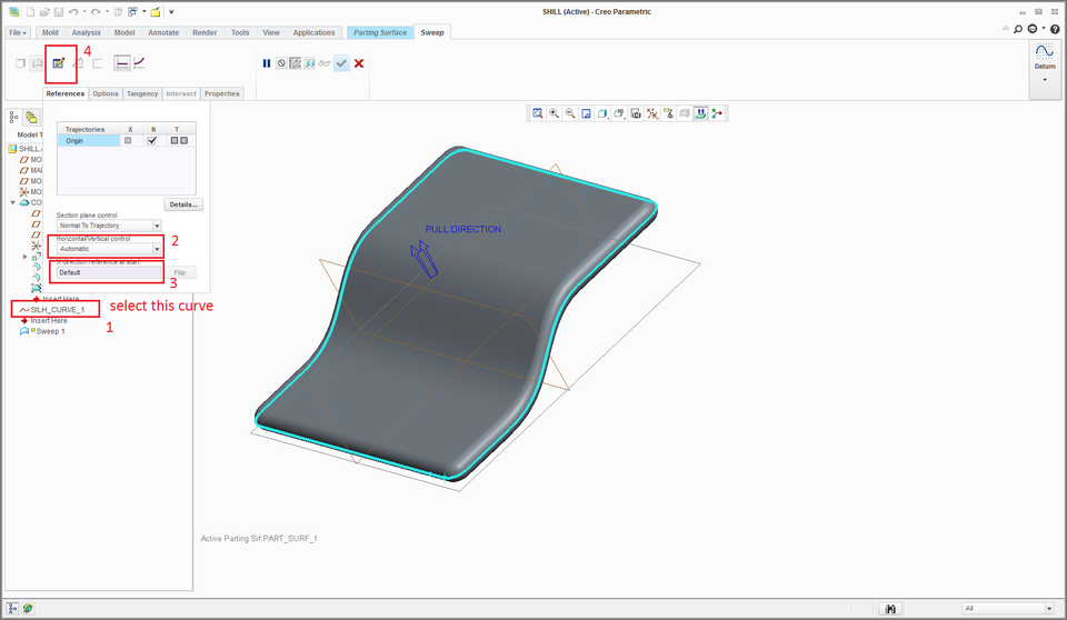

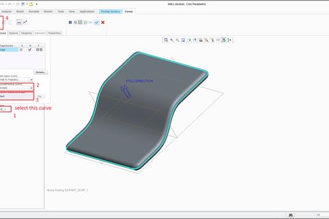

    6. Step 6
      You need to select that silhoutte curve and follow the steps as shown in the image and next you need to create a sketch (sweeping profile)
      Medium

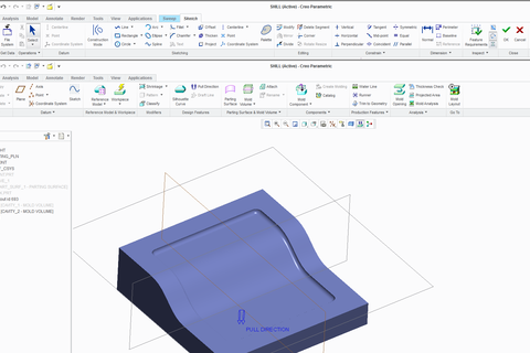

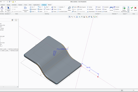

    7. Step 7
      Just create a straight line of required length as shown in the image. We should keep in mind that this surface should cut the work piece which we will create in coming steps
      Medium

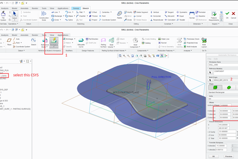

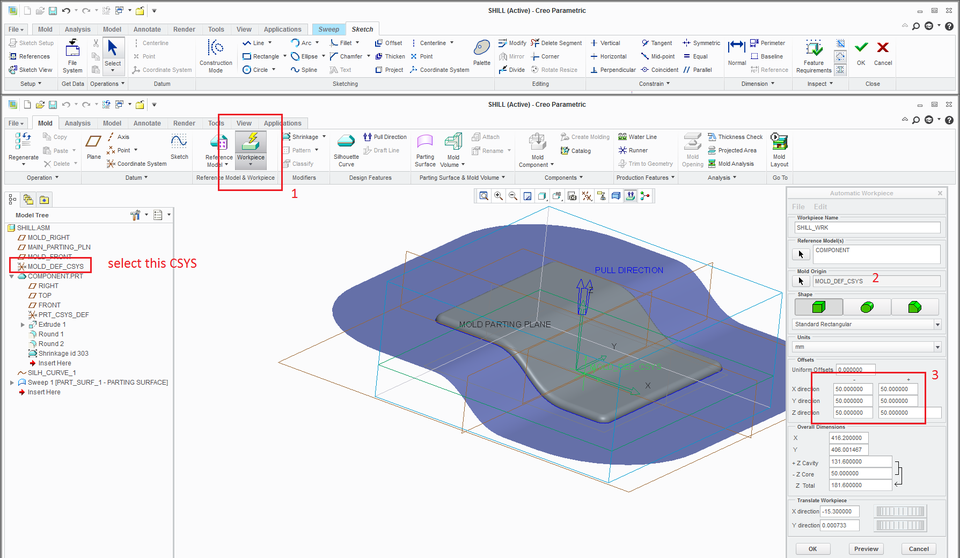

    8. Step 8

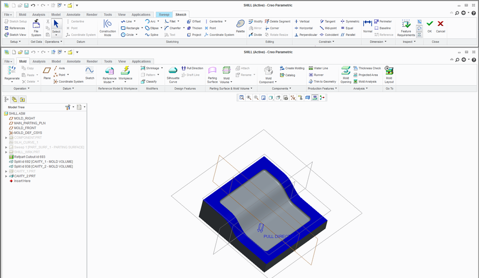

      Create a workpiece using automatic workpiece as shown in the image (you can also refer previous tutorial )
      Medium

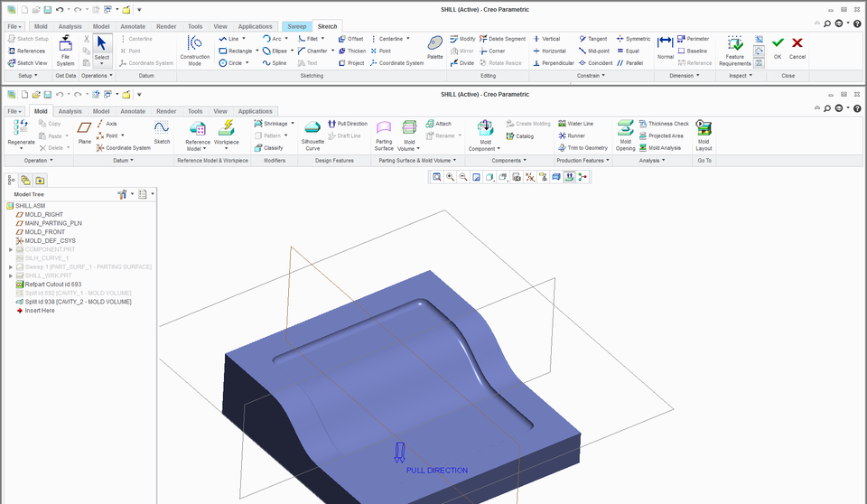

    9. Step 9
      You can now do the core cavity splitting , Please refer previous tutorial for splitting core cavity
