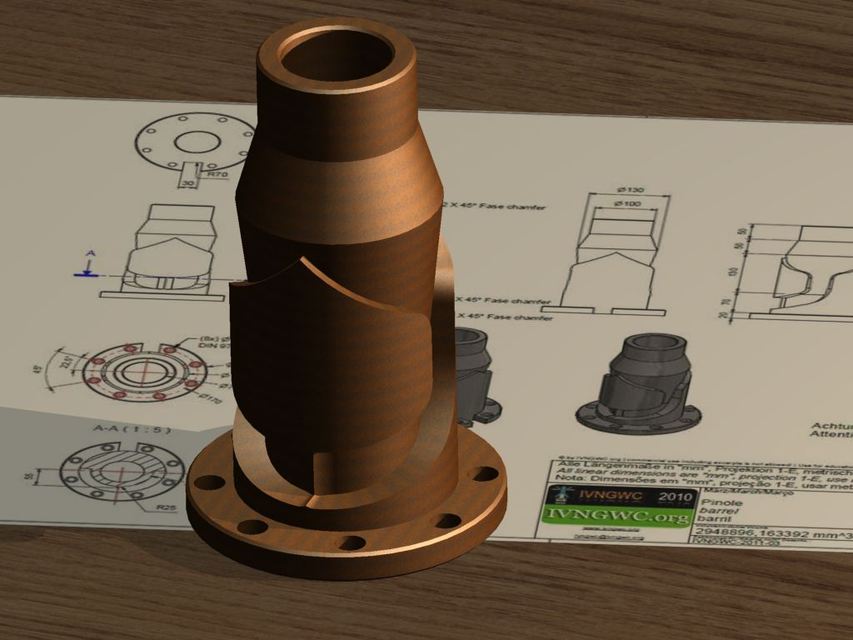

hello friends grabacad as you see I'm new to the site and Verda very good, also new to cad.
usteden want some help as I could put the plane of a 3D solid piece below I hope I understand what I mean, here I leave a prevention image to see what I learn
regards

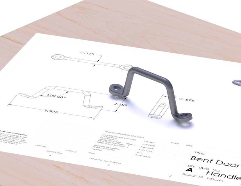

    You are wanting to place a 2D drawing of a part under the 3D version of that part? If so, this is done in Photoview360 usually in a rendering. The 2D drawing is a screen shot of the drawing that is placed as a decal on the surface below the 3D model.
