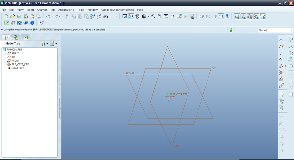

    1. Step 1

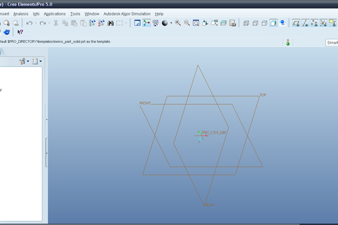

      Start Creo Elements/Pro in Part mode.
      Medium

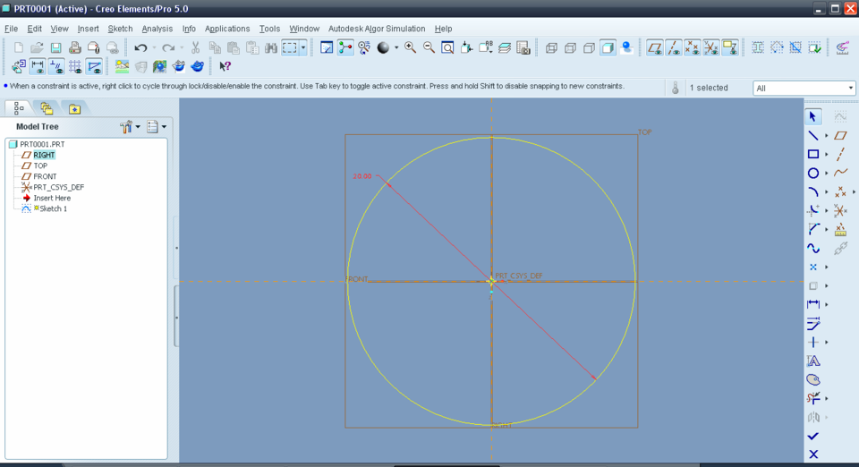

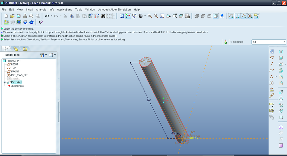

    2. Step 2

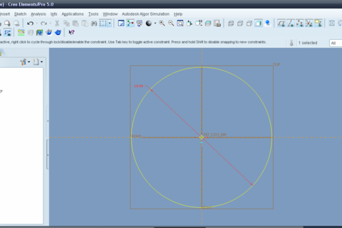

      Sketch>>Top Plane and draw a circle of 20mm diameter.
      Medium

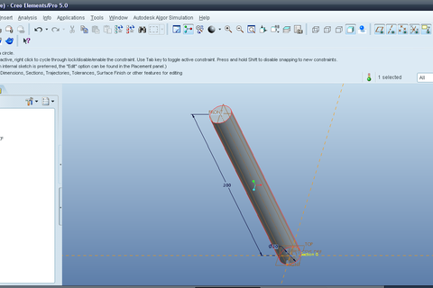

    3. Step 3
      Extrude it by 200mm.
      Medium

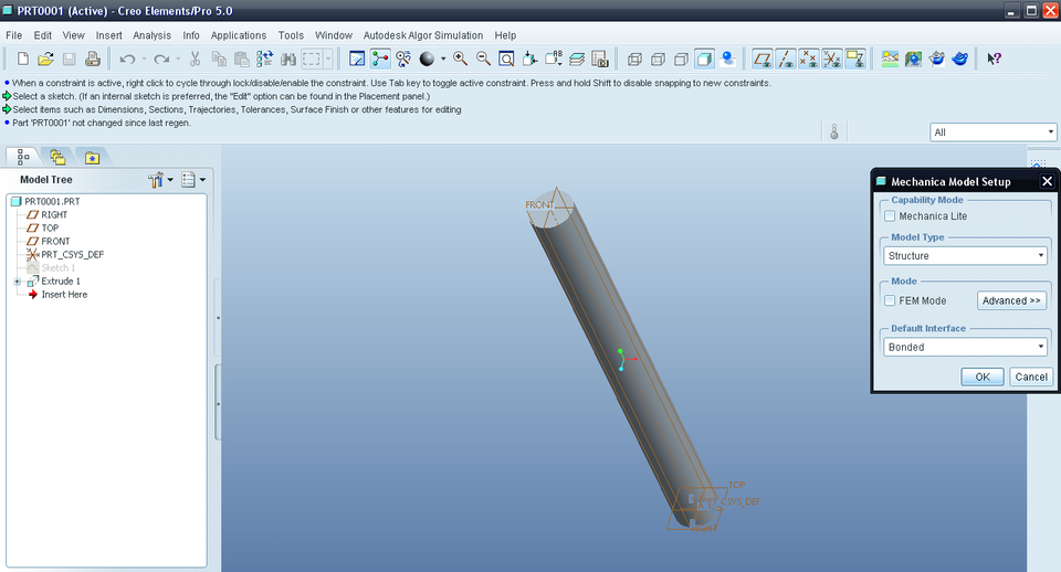

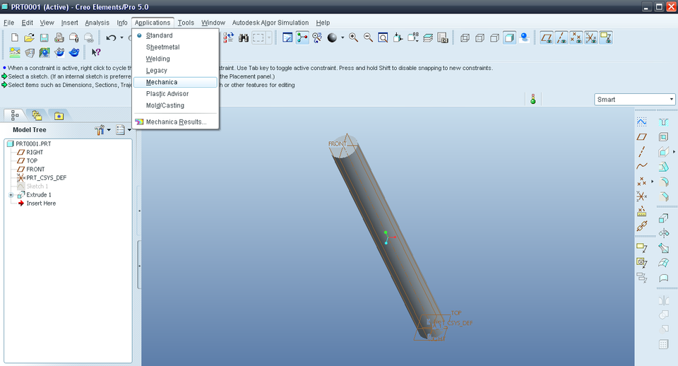

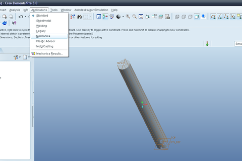

    4. Step 4

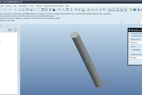

      Applications>>Mechanica.
      Medium
    5. Step 5
      Click OK with default settings.
      Medium

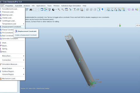

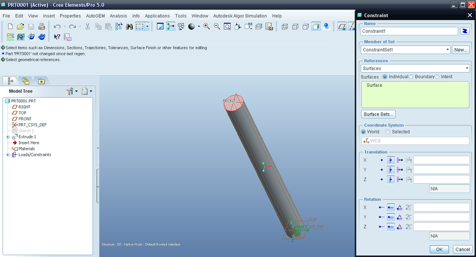

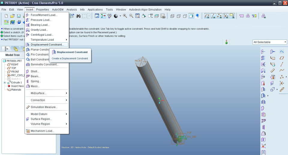

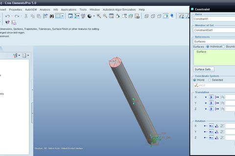

      Insert>>Displacement Constraints.
      Medium
    7. Step 7
      Select front face and click OK. This will fix all the DOFs of the front face.
      Medium

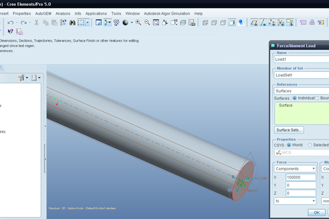

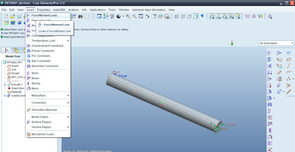

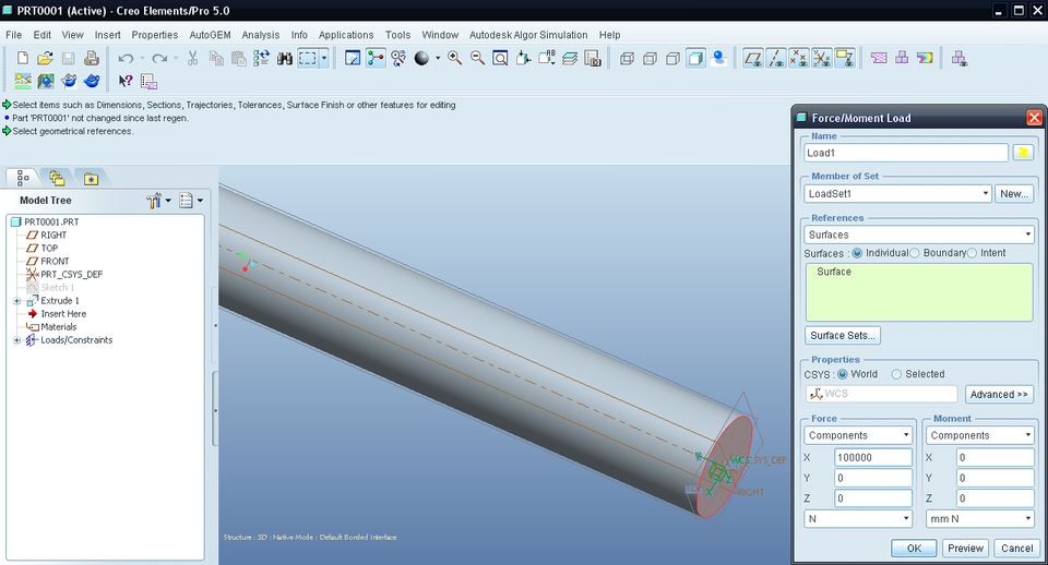

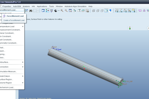

      Insert>>Force/Moment Load.
      Medium
    9. Step 9
      Select the other face of the rod. And Enter an value of 10000 in X at Force and click OK.
      Medium

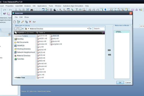

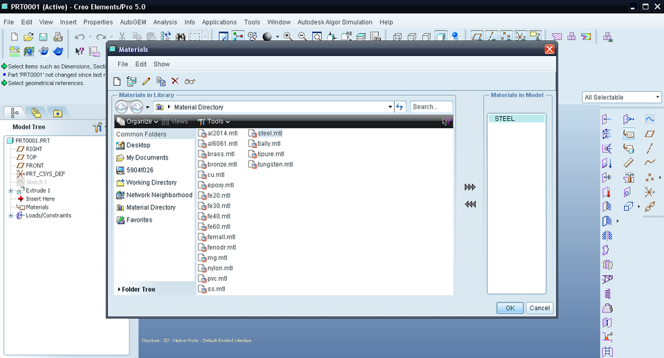

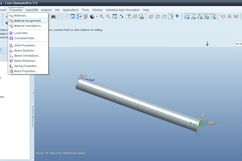

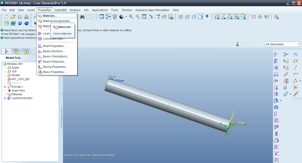

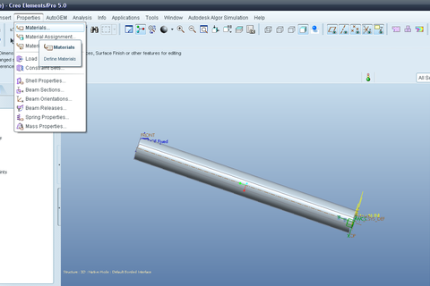

      Properties>>material.
      Medium
    11. Step 11
      Select Steel and Click >>> button.
      Medium
    12. Step 12

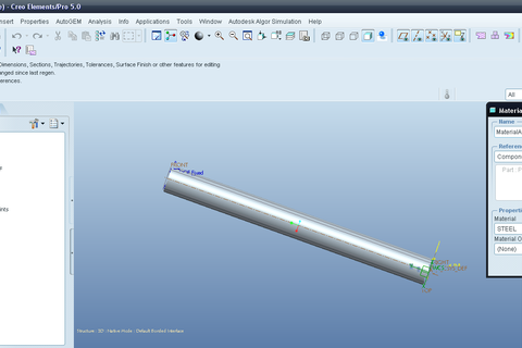

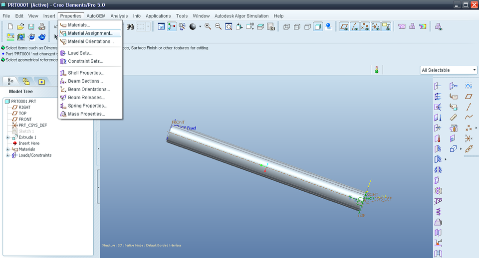

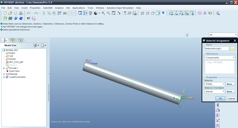

      Properties>>material assignment.
      Medium
    13. Step 13
      Keep default settings and click OK.

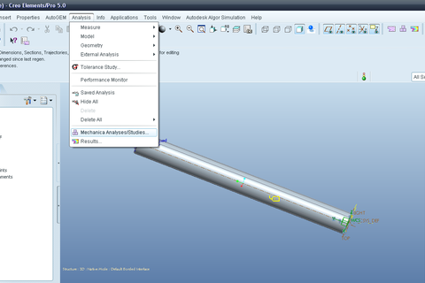

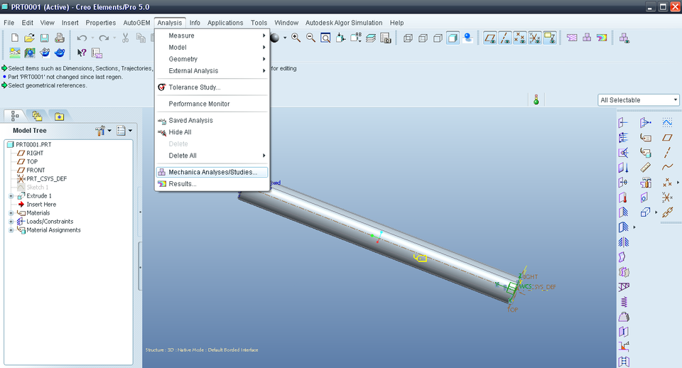

    14. Step 14

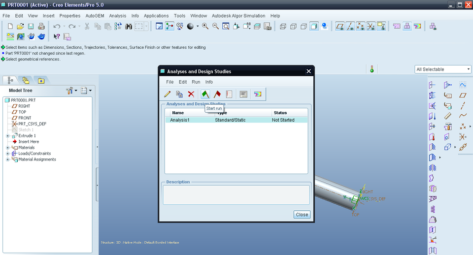

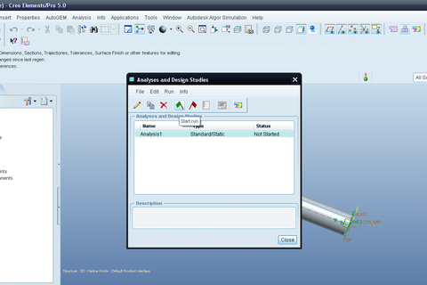

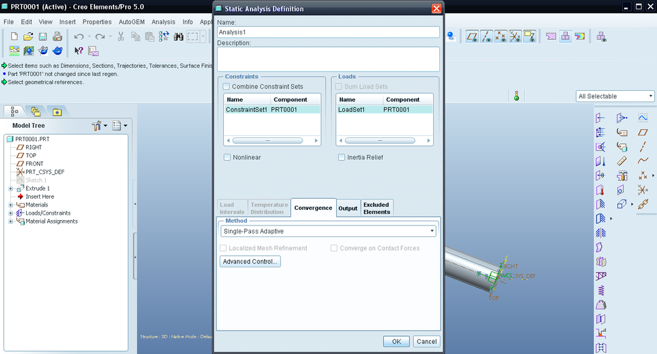

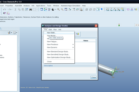

      Analysis>>Mechanica Analysis/Studies.
      Medium

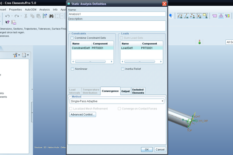

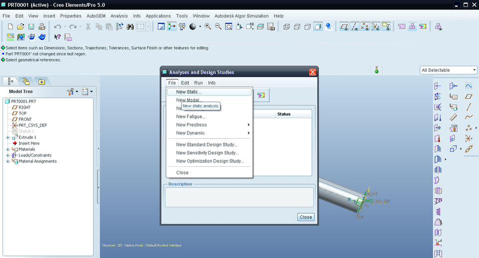

    15. Step 15
      Click File Menu and then New Static.
      Medium
    16. Step 16
      Keep the default setting for now and click OK.
      Medium
    17. Step 17
      Click the green flag to run the analysis. OK.

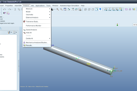

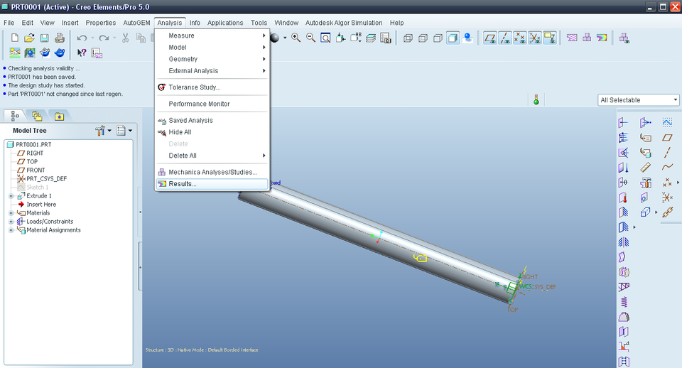

    18. Step 18
      Click Analysis menu and then Results.
      Medium

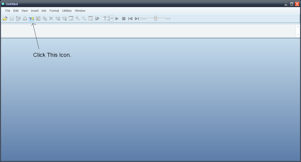

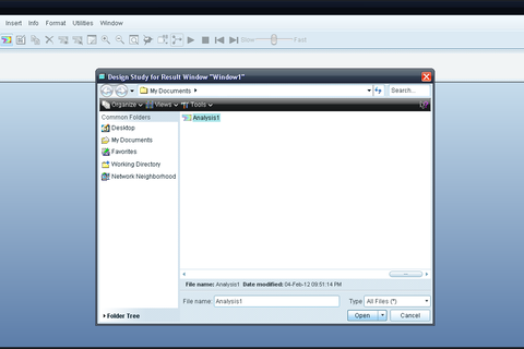

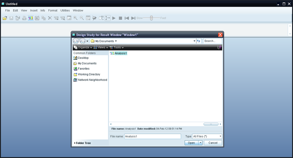

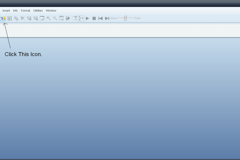

    19. Step 19
      Click this icon.
      Medium
    20. Step 20
      Select the analysis1 file just created and Click Open. A dialogue window will appear click OK and Show.
      Medium

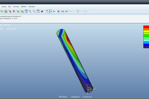

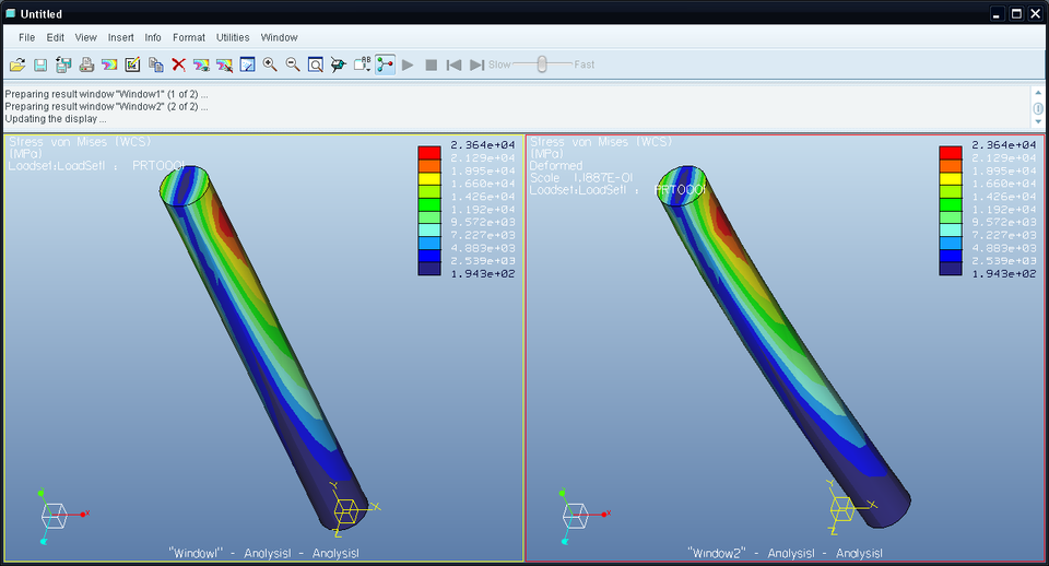

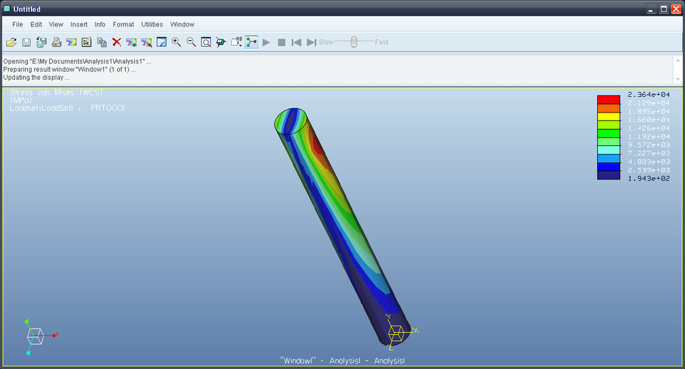

    21. Step 21
      The von-mises stress distribution is shown.
      Medium

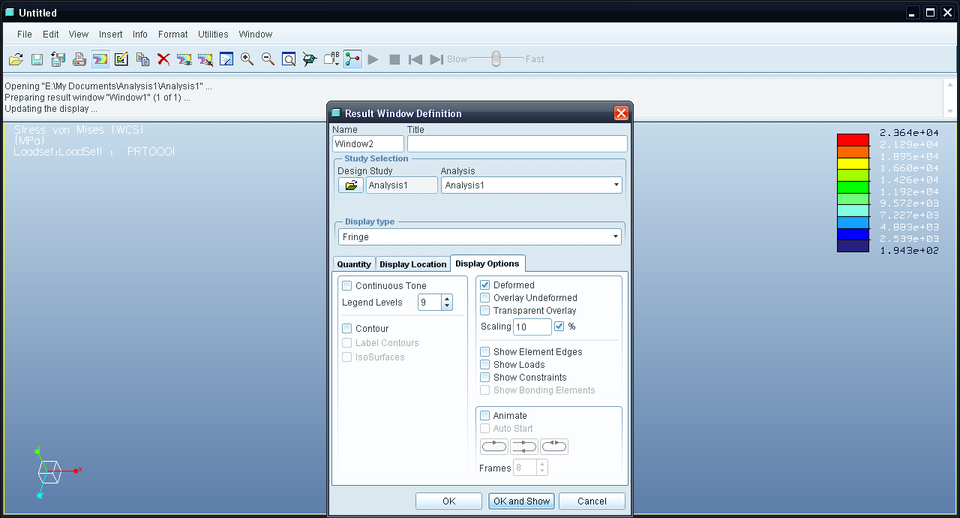

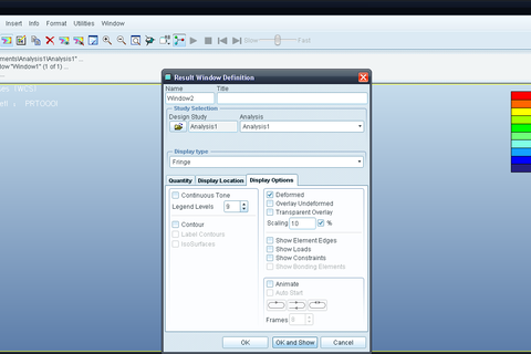

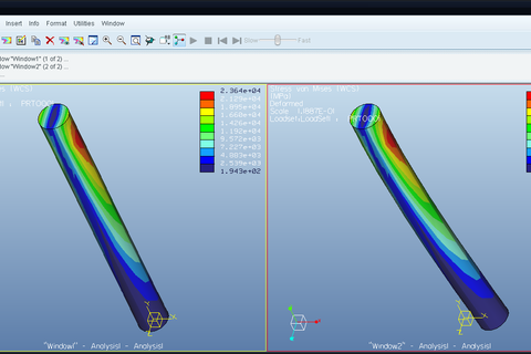

    22. Step 22
      Click that icon again and under display options check deformed and click OK and Show.
      Medium
    23. Step 23
      Now we can see the deformed and undeformed state of the rod under load.
