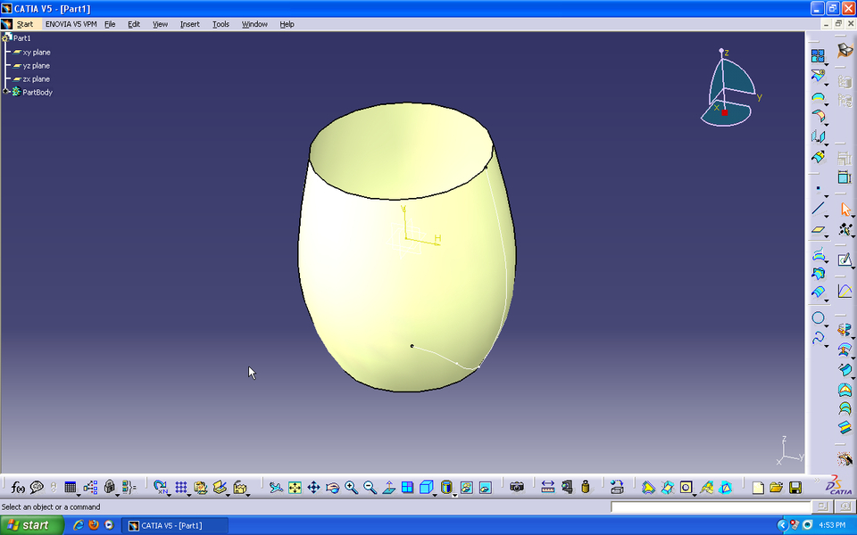

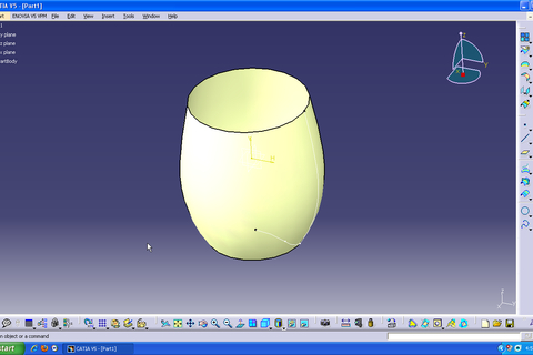

    1. Step 1
      Make a part as shown in the image using revolve feature in surfacing or in part modeling.

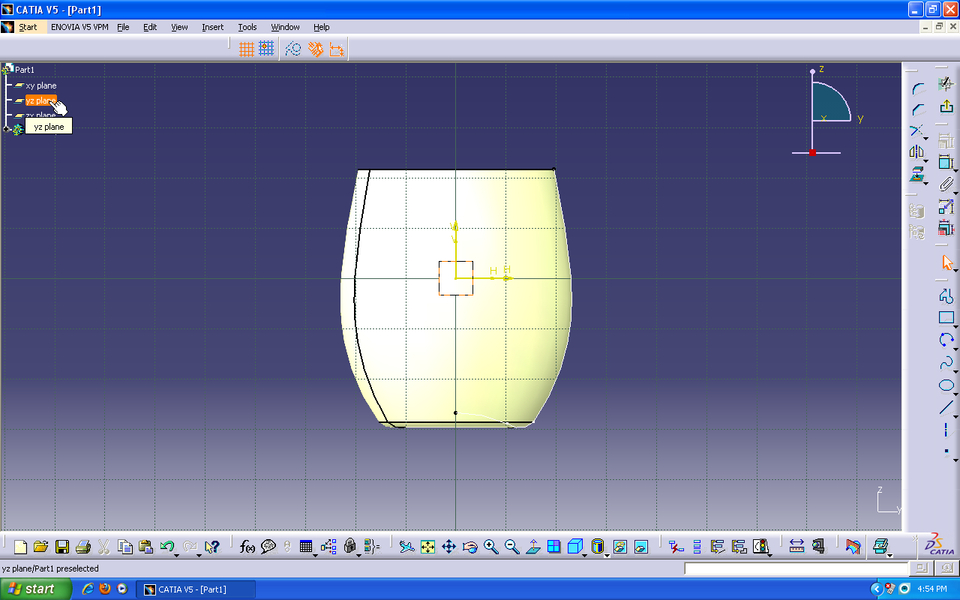

    2. Step 2

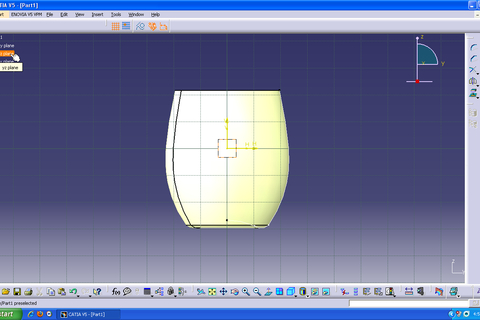

      Invoke a sketch on yz or xz plane
      Medium

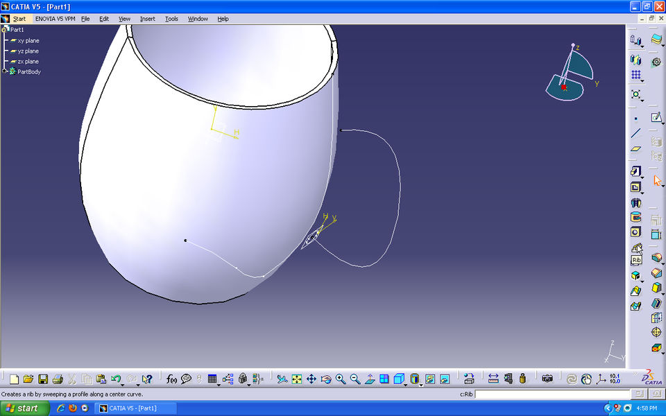

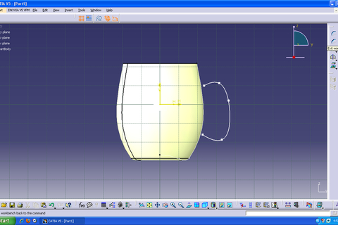

    3. Step 3
      Sketch a spline as per your required handle.
      Medium

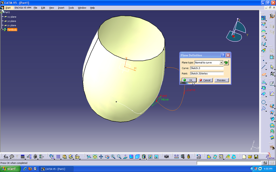

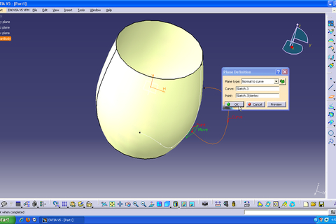

    4. Step 4
      Insert a plane at the tip of the spline and click ok.
      Medium

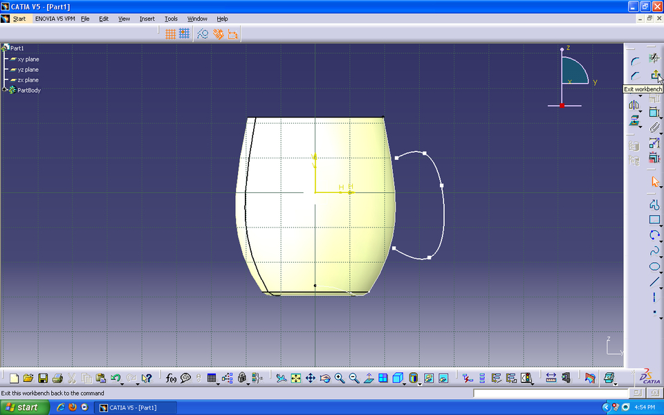

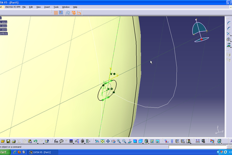

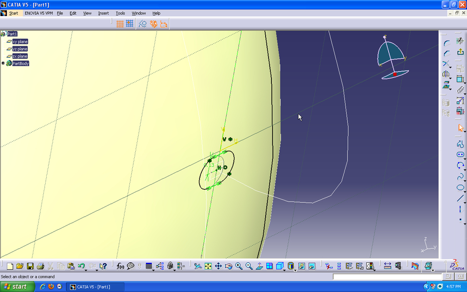

    5. Step 5
      Draw your handle's profile and make it coincident with the spline in the center.
      Medium

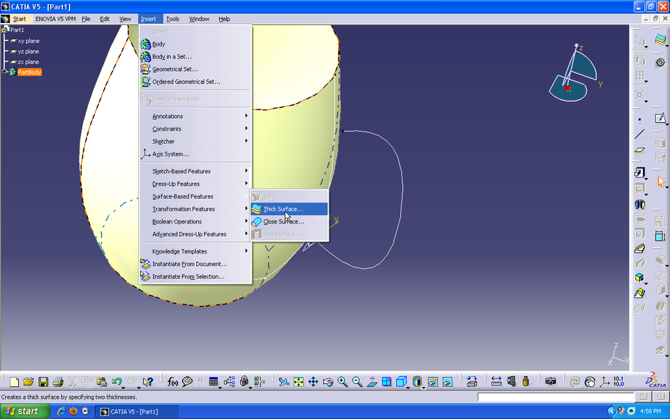

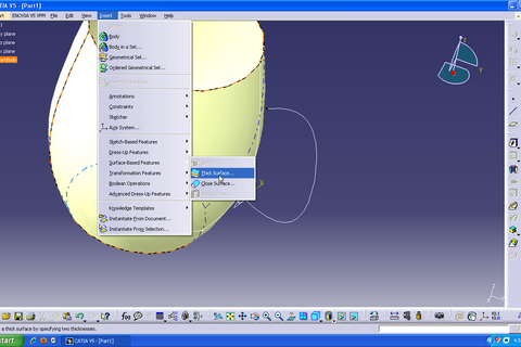

      If you were in GSD then go to part design workbench
      insert->surface based feature->thick surface.
      Medium

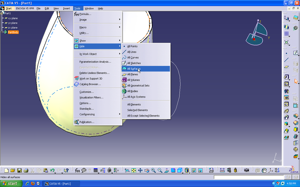

    7. Step 7
      hide all the surfaces

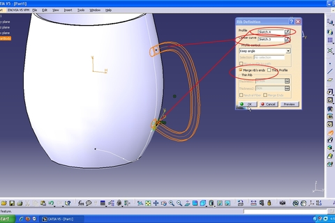

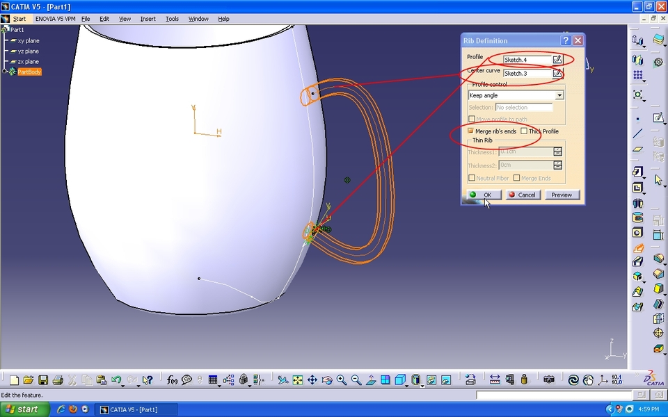

    9. Step 9

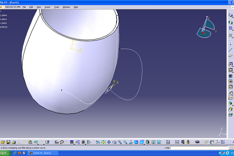

      Now use "rib" feature. Invoke it from the main menu by using insert->features->rib definition or find it in the tool bar.
      Select the profile as made in step 5, center curve as the spline and check "merge rib" option.
      Medium

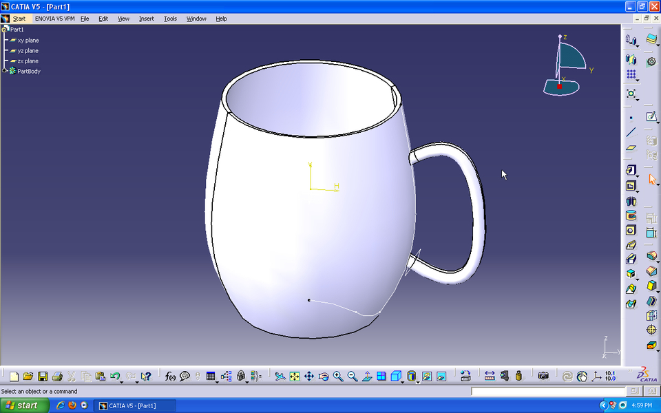

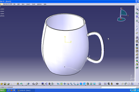

    10. Step 10
      Here's you mug ready to use.
