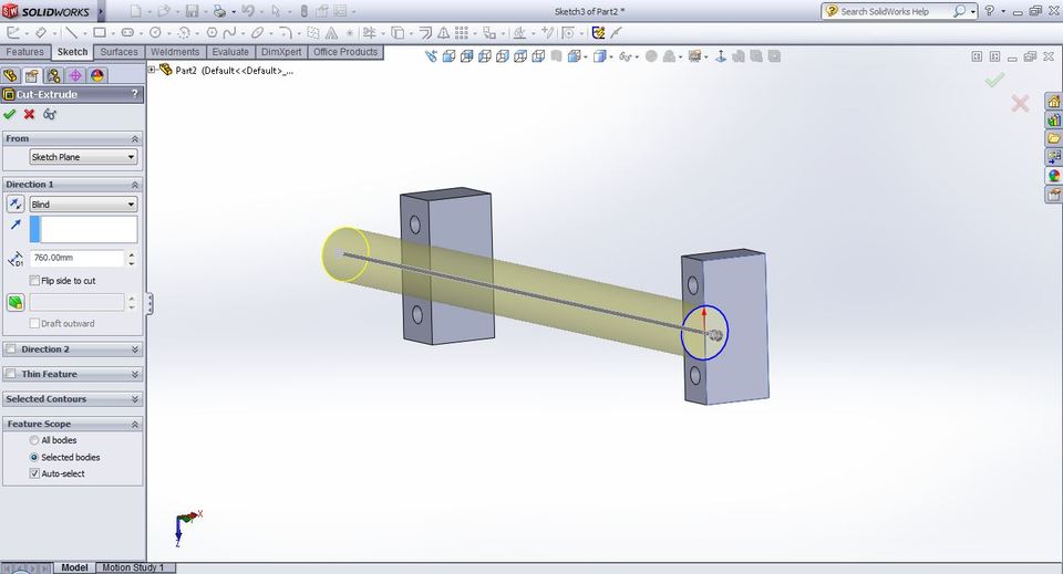

    Crankshaft endpoints connecting parts

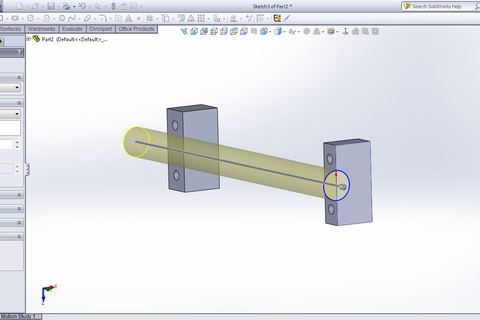

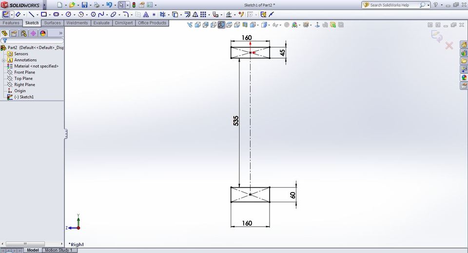

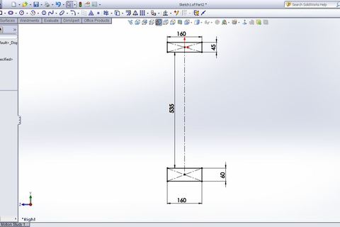

    1. Step 1
      draw shown sketch
      Medium
    2. Step 2
      extrude the sketch 60mm
      Medium

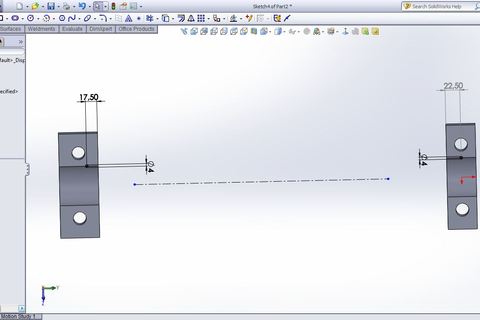

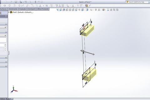

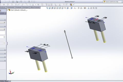

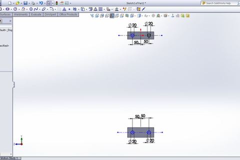

    3. Step 3
      open a sketch on the body and draw shown circles
      Medium

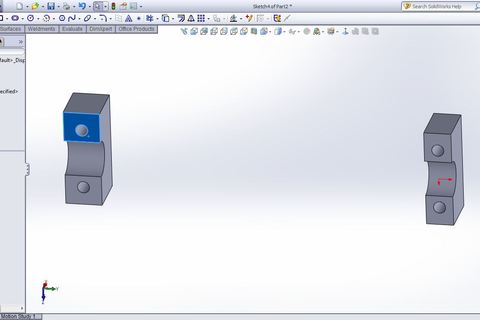

    4. Step 4
      cut the body
      Medium

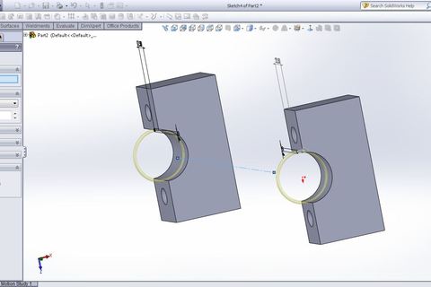

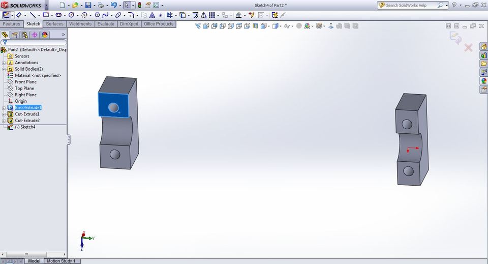

    5. Step 5
      draw a 30mm radiused circle like this and use cut extrude command
      Medium

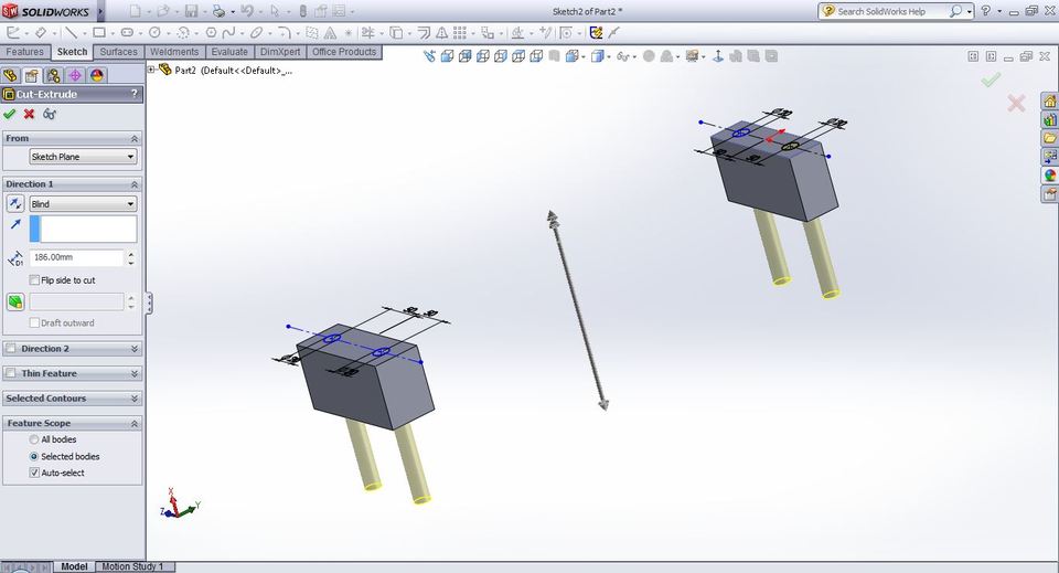

    6. Step 6
      open a sketch on the blue surface
      Medium

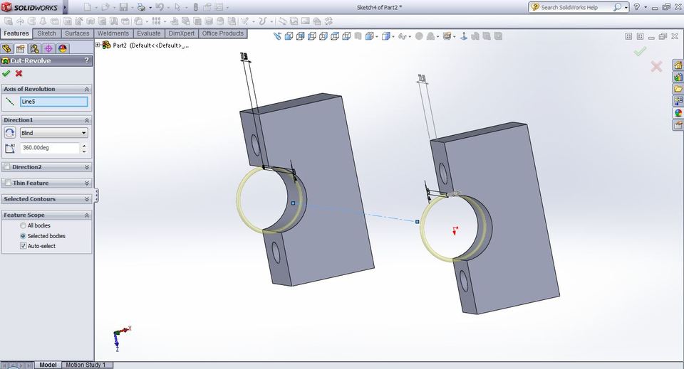

    7. Step 7
      draw shown two circles and centerline
      Medium
    8. Step 8
      use cut revolve command. that is all for now
      Medium
