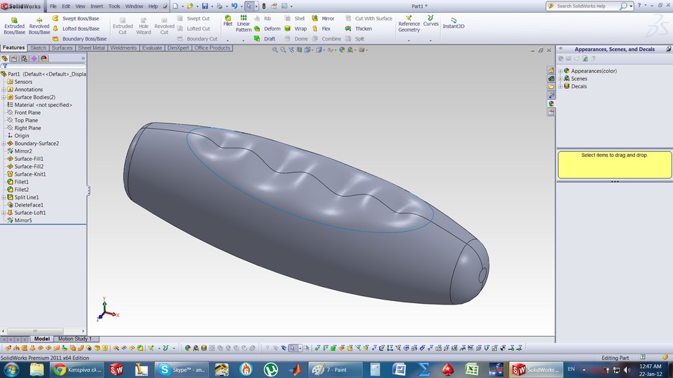

When we model a handle, it is preffered to have a curve on the one side, so that the fingers can hold it better... this is how we do that..
3 answers
  • Andreas Gkertsos
    Andreas Gkertsos over 1 year ago
    These are the steps....

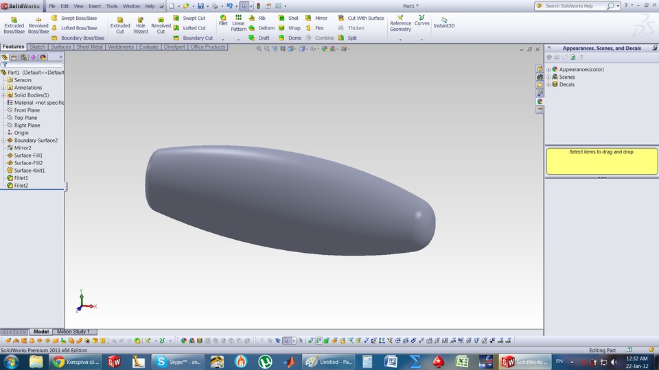

    1. Step 1
      first of all we take a handle that we need to model the grip...
      Medium

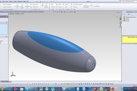

    2. Step 2

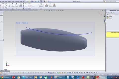

      then we go to the "right" plane (it depends on how you have modeled your part) and we create a spline to determine tha area that the grip will be...
      Medium
    3. Step 3

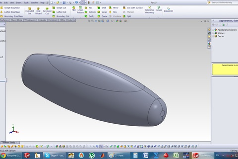

      Next we split line it to all faces...
      Medium

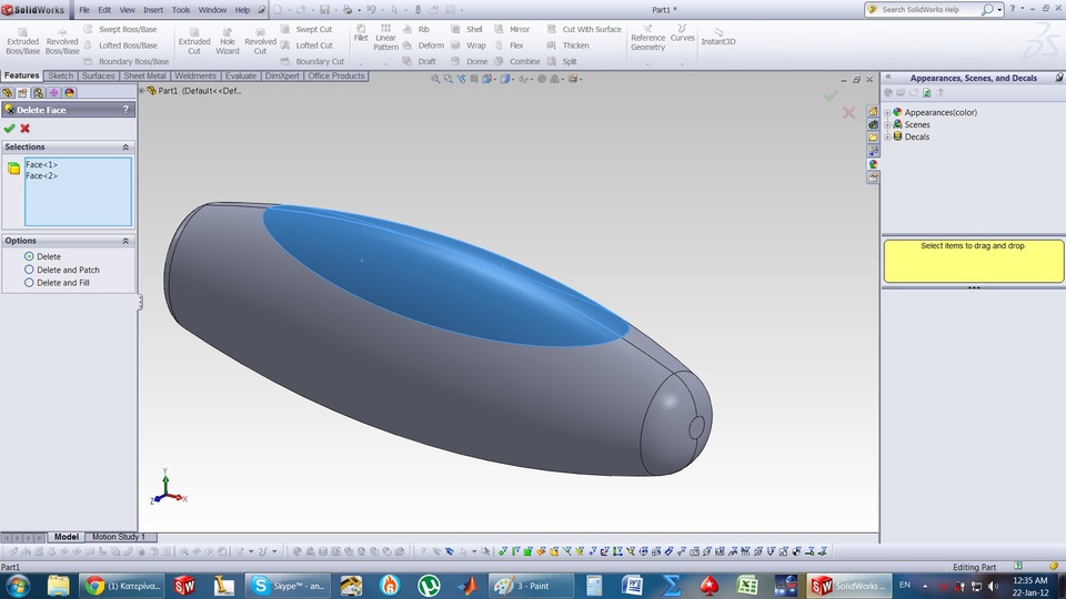

    4. Step 4

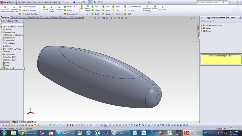

      then we delete the split line faces.... like this...
      Medium

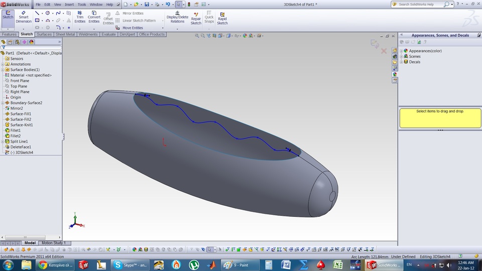

    5. Step 5

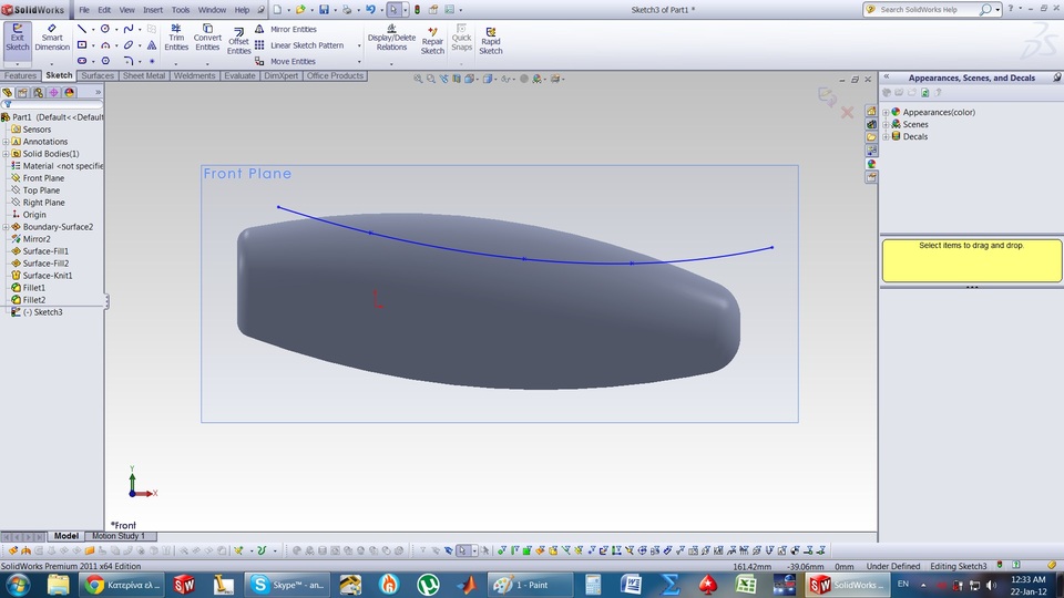

      Next we draw a sketch like how we want the grip to be...
      Medium

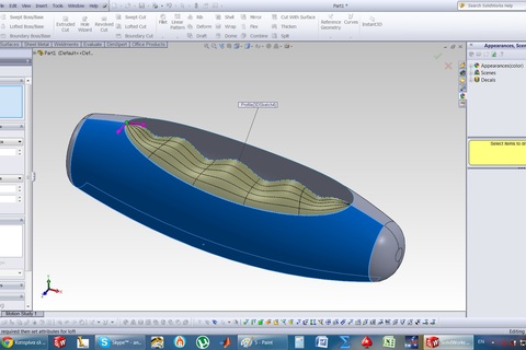

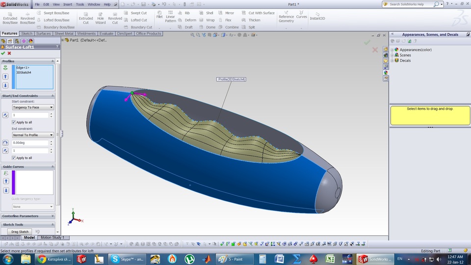

    6. Step 6
      We create the surface using the loft surface feature (please note the constraints... tangent and normal to)
      Medium

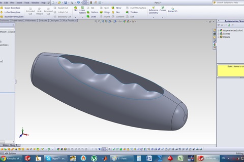

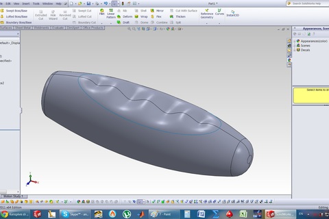

    7. Step 7
      this is the result...
      Medium
    8. Step 8
      mirror surface...
      Medium

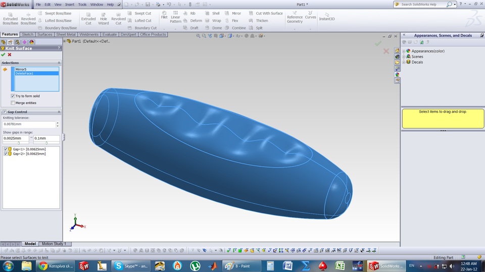

    9. Step 9
      Knit surfaces (creating a solid body)
      Medium

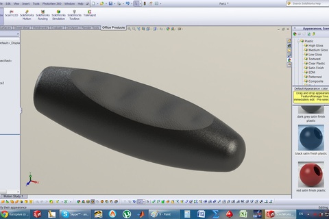

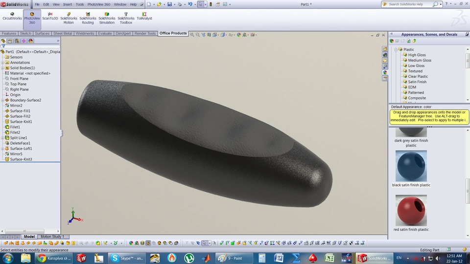

    10. Step 10

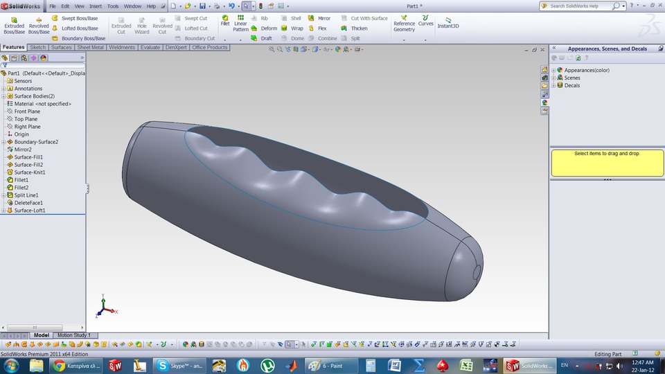

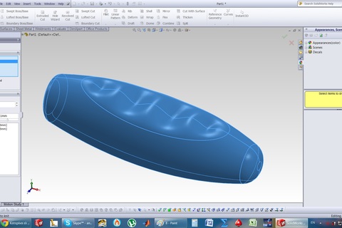

      This is tha final result...
      Medium
