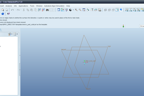

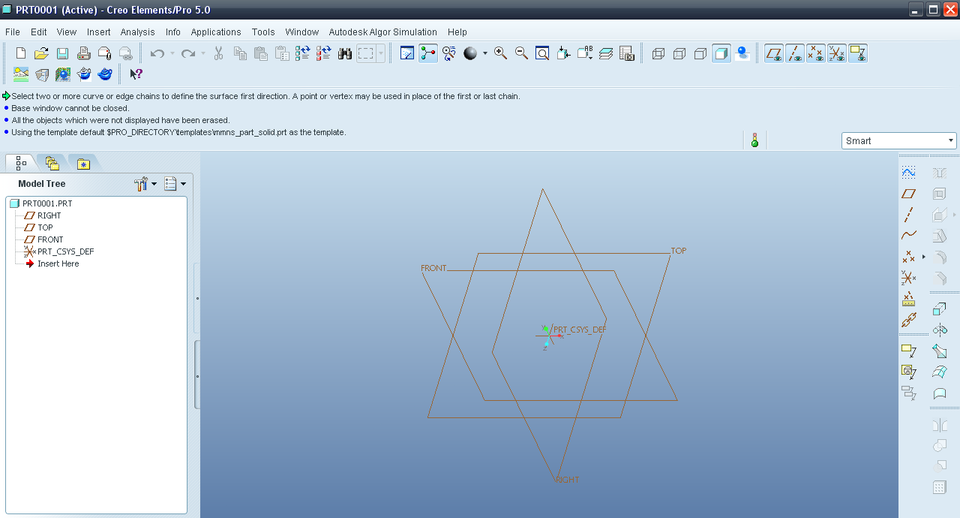

    1. Step 1
      Start Creo.
      Medium

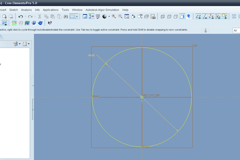

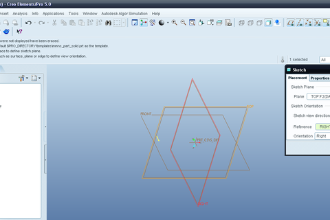

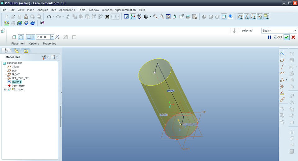

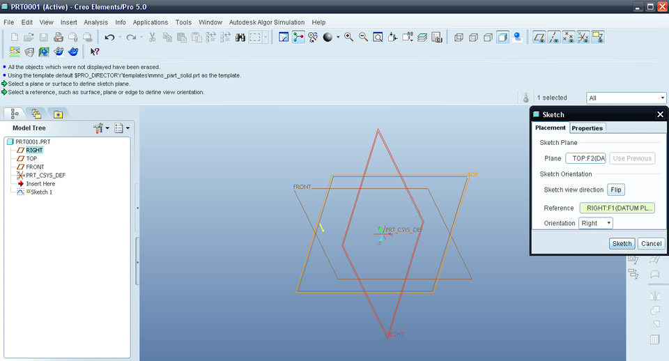

    2. Step 2

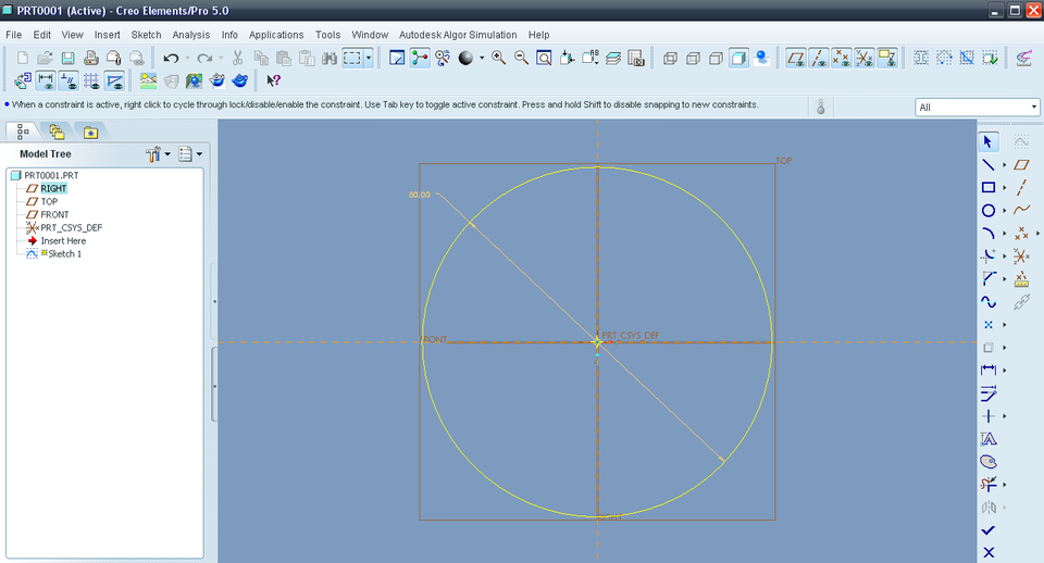

      Sketch >> Top plane.
      Medium
    3. Step 3
      Draw a circle of 80mm diameter.
      Medium

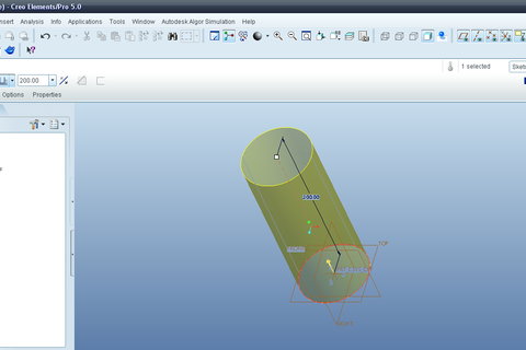

    4. Step 4
      Extrude it as surface by 200mm.
      Medium

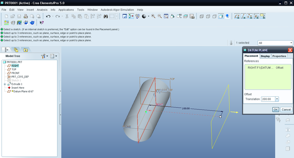

    5. Step 5
      Offset the right plane by 200mm.
      Medium

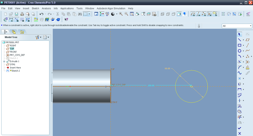

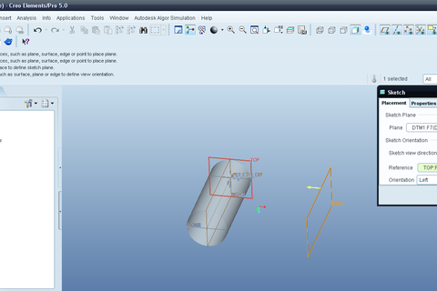

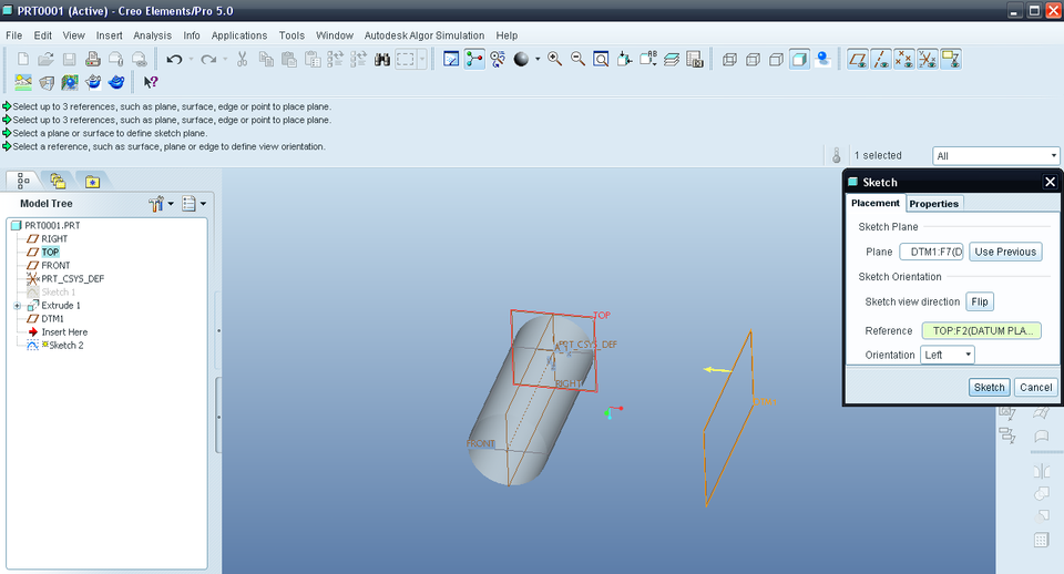

    6. Step 6
      Sketch >> DTM1.
      Medium
    7. Step 7
      Draw a circle of 80mm at 200mm to the origin.
      Medium

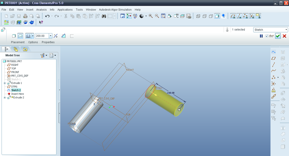

    8. Step 8

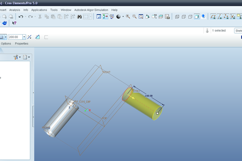

      Extrude it as surface by 200mm away from origin.
      Medium

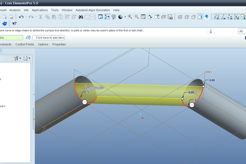

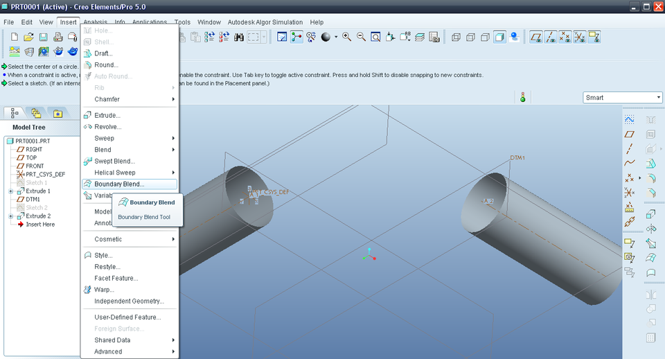

    9. Step 9

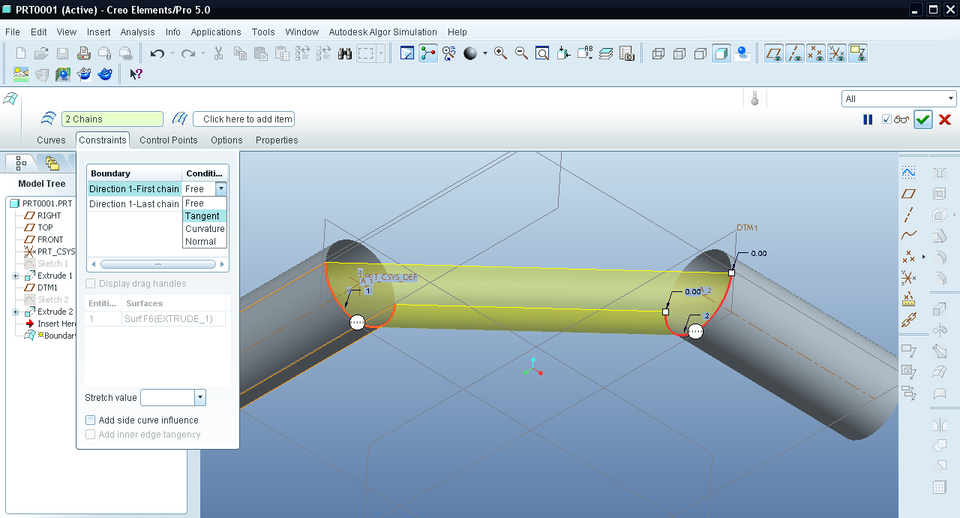

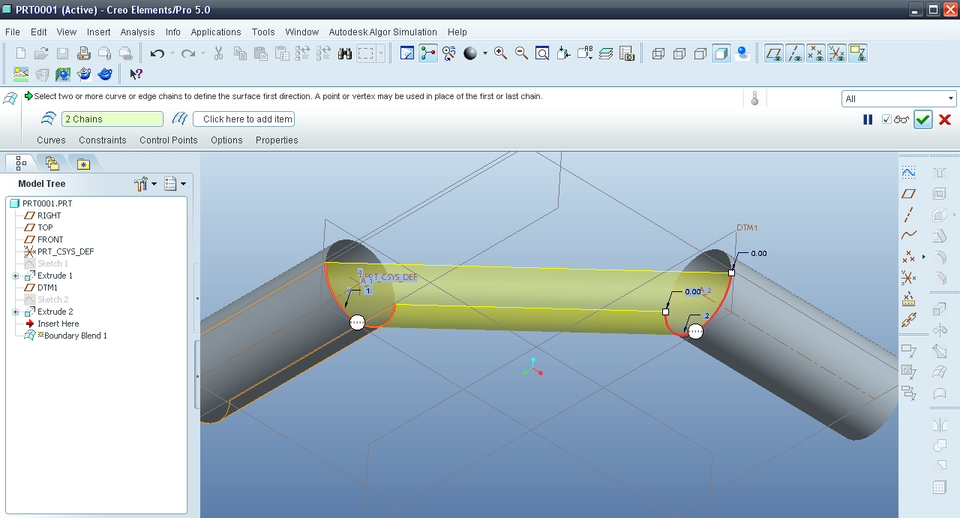

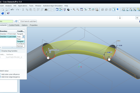

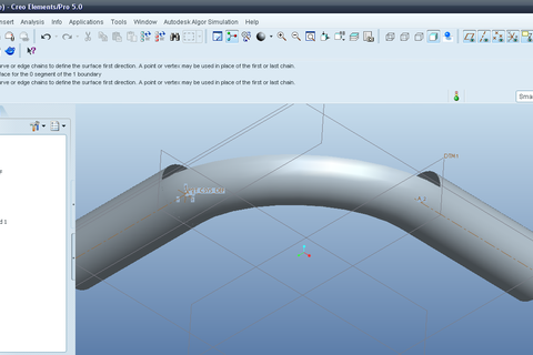

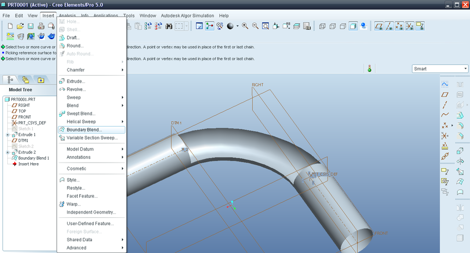

      Insert >> Boundary blend.
      Medium
    10. Step 10

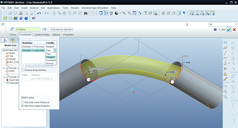

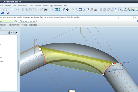

      Select both edges of the pipes while holding down control key.
      Medium
    11. Step 11
      Under constraints change boundary conditions to Tangent for First chain.
      Medium
    12. Step 12
      Same for Last Chain.
      Medium

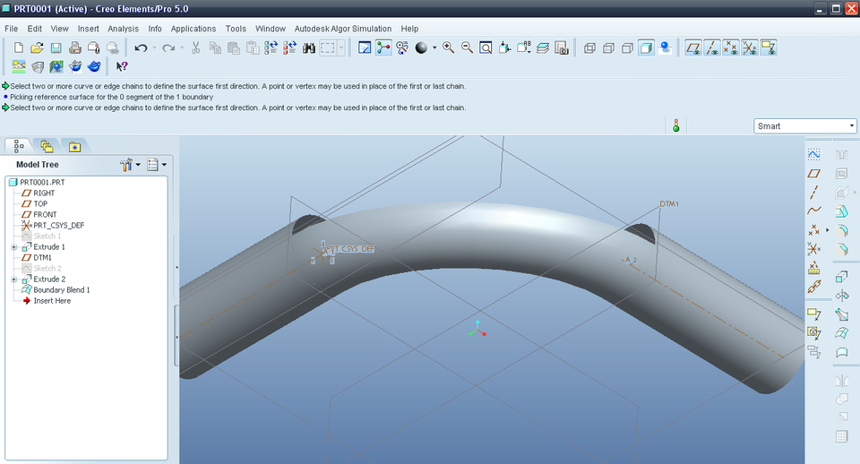

    13. Step 13

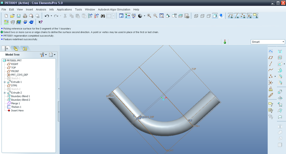

      Click OK and the surface is generated.

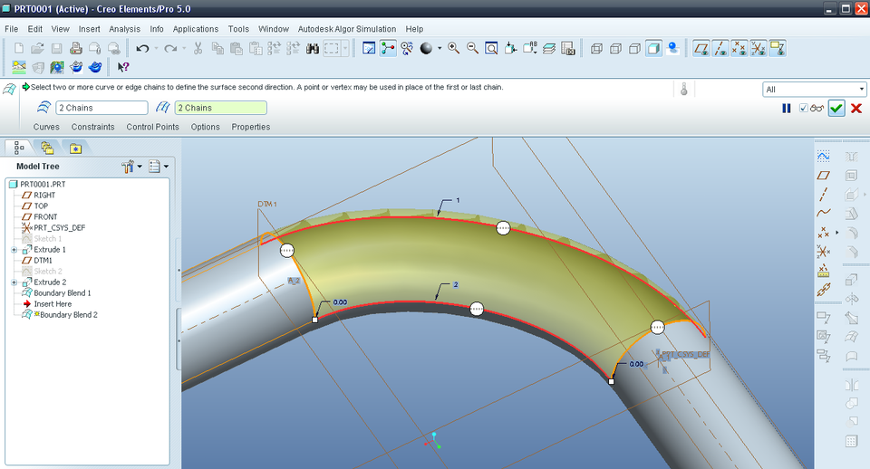

      Medium

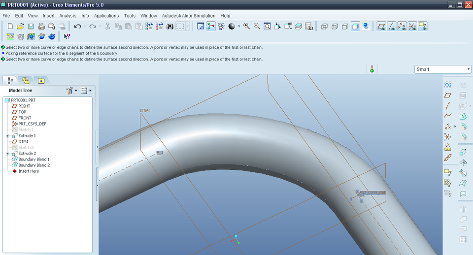

    14. Step 14

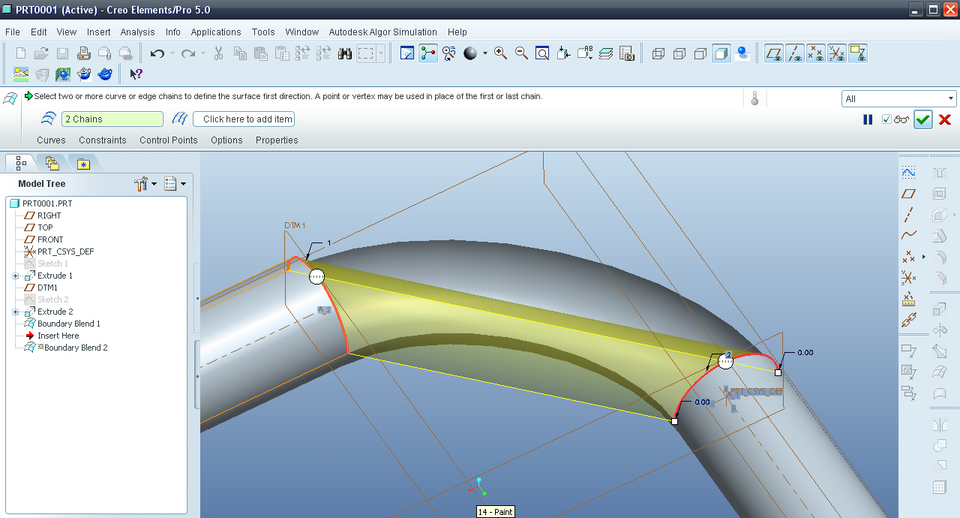

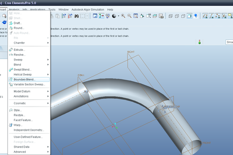

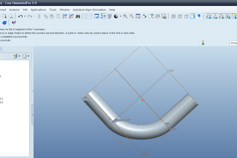

      Insert >> Boundary Blend.
      Medium
    15. Step 15
      Again Select both edges while holding CTRL key.
      Medium
    16. Step 16
      For direction 2 select the edges of the boundary blend 1 while holding CTRL key.
      Medium
    17. Step 17

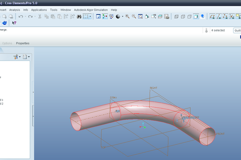

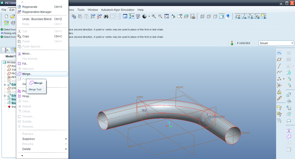

    18. Step 18

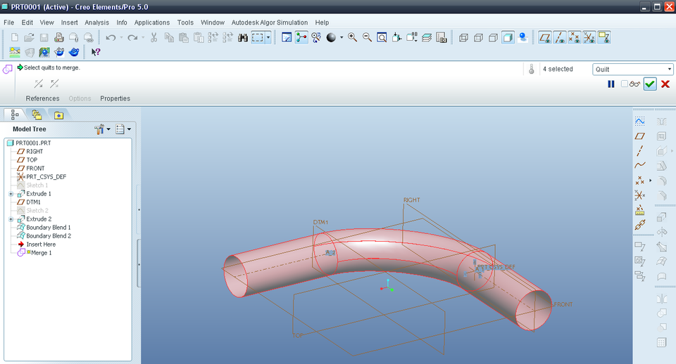

      Select all surfaces and then Edit >> Merge.
      Medium
    19. Step 19
      ClicK OK and the surfaces are merged into one.
      Medium

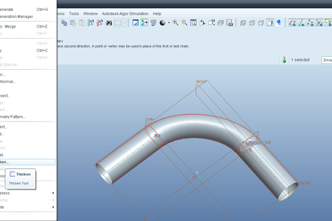

    20. Step 20

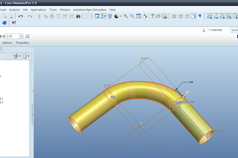

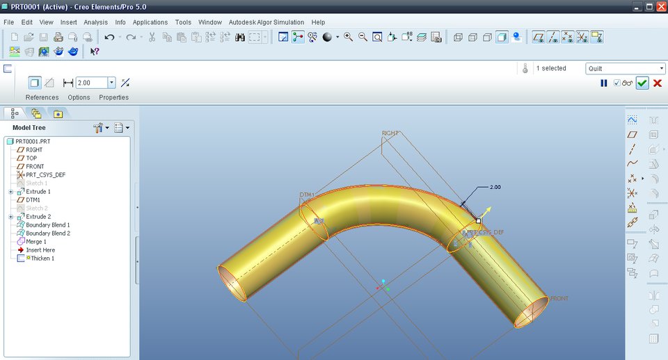

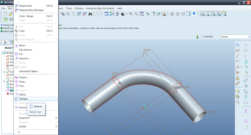

      Select the merge1 and then Edit >> Thicken.
      Medium
    21. Step 21
      Input thickness 2mm outside. Click OK.
      Medium
    22. Step 22
      Now the pipe joint is created using Boundary blend.
      Medium
