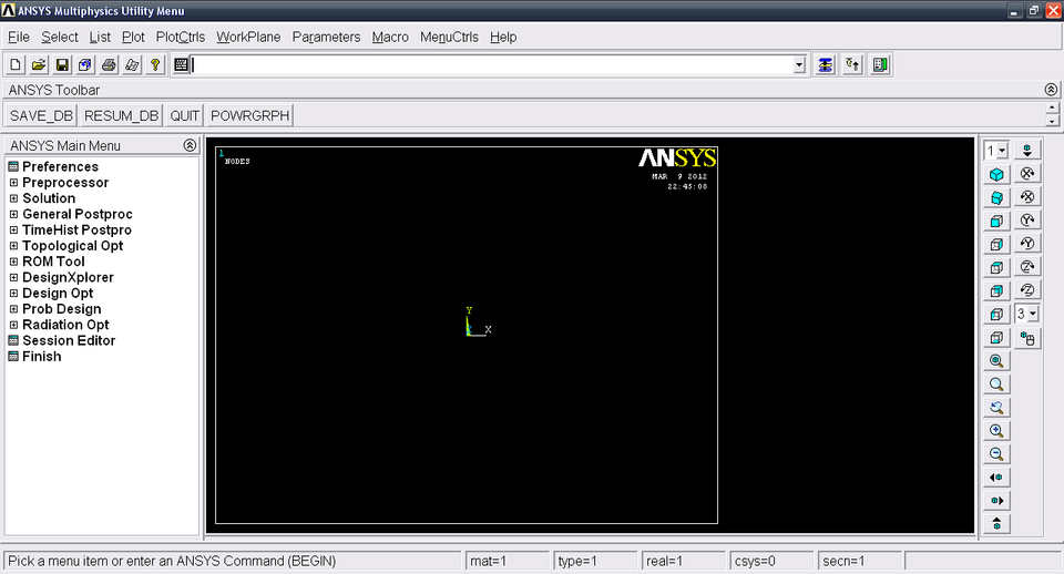

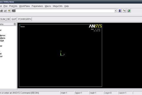

    1. Step 1
      Start Mechanical APDL.
      Medium

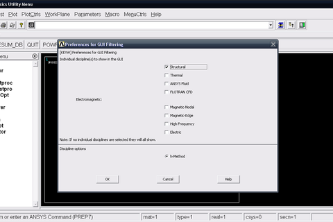

    2. Step 2

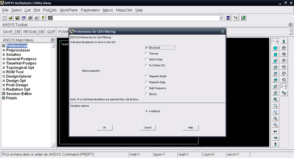

      Click Preferences and select Structural. Click OK.
      Medium

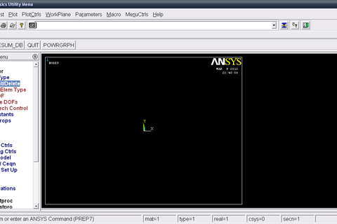

    3. Step 3

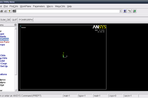

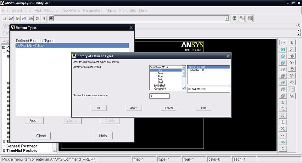

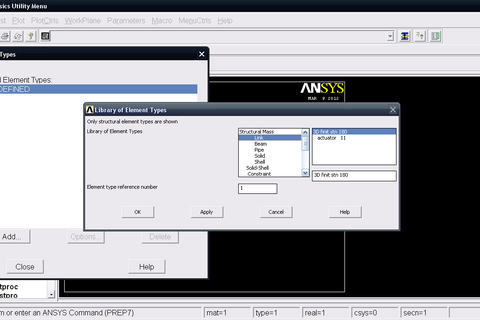

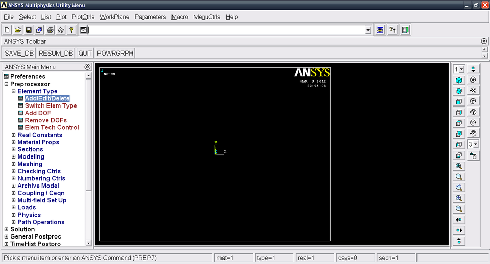

      Under Preprocessor goto >> Element Type >> Add/Edit/Delete.
      Medium
    4. Step 4
      Click Add and then select 3D finit stn. Click OK and then close.
      Medium

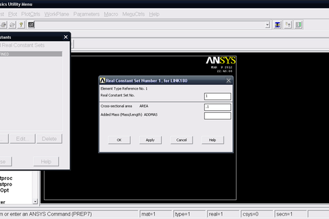

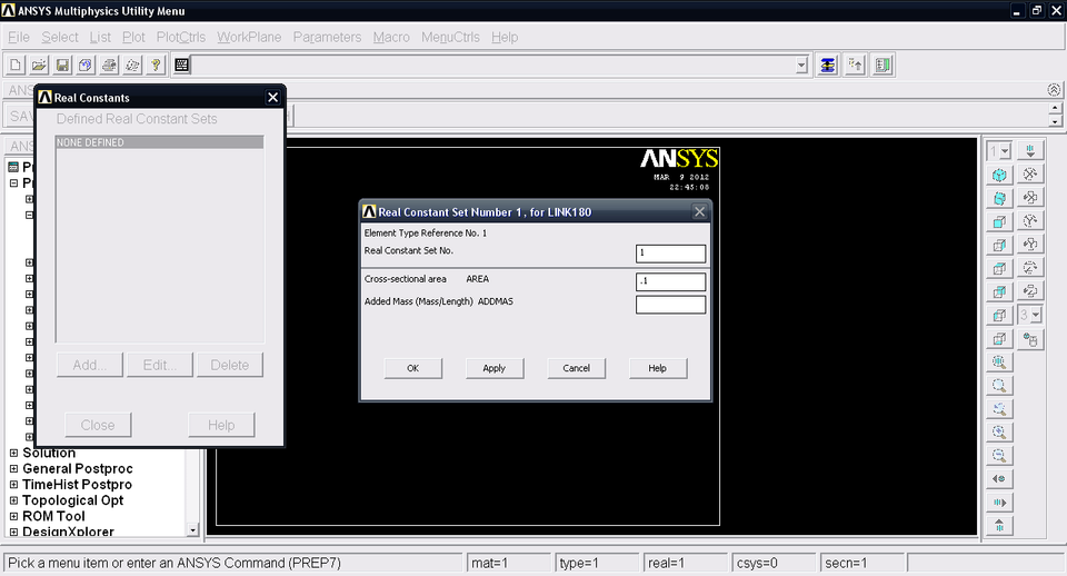

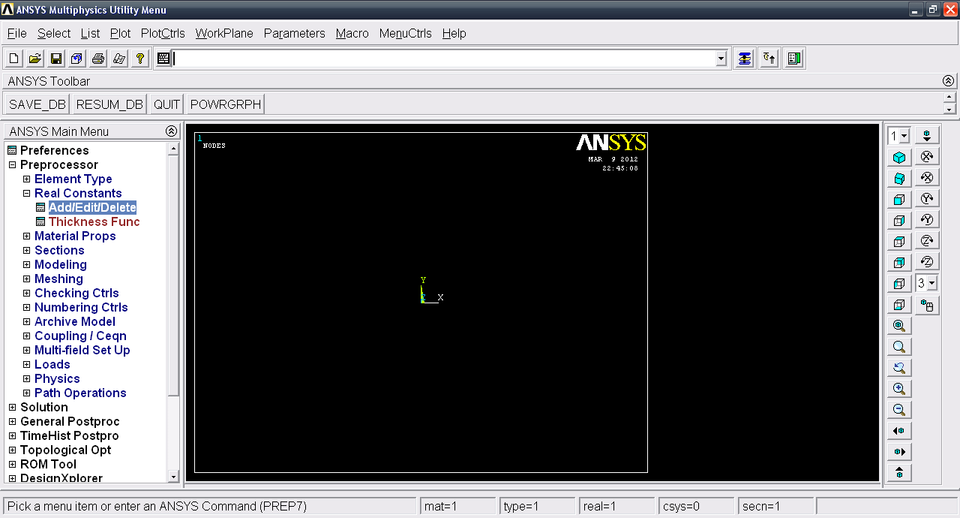

      Under Real constants click Add/Edit/Delete.
      Medium
    6. Step 6
      Click Add and then define Area = .1. Click OK and Click Close.

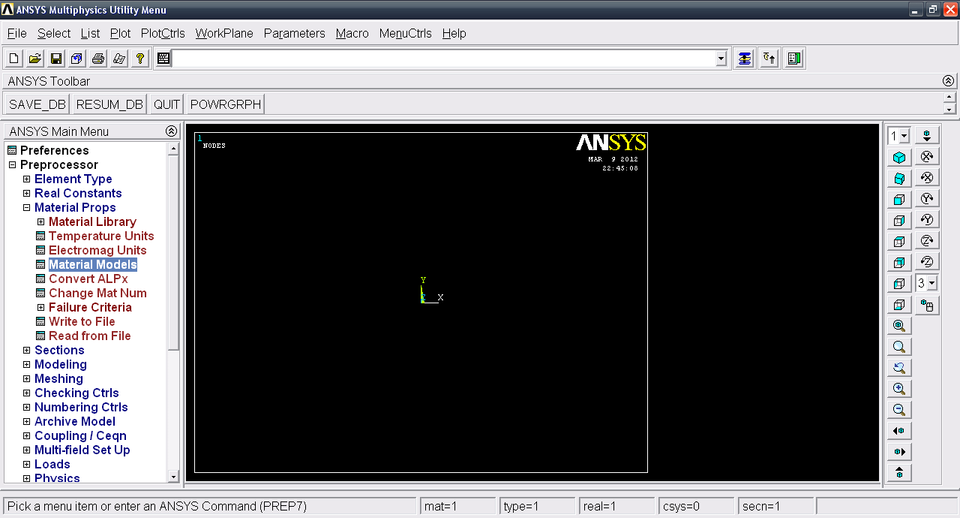

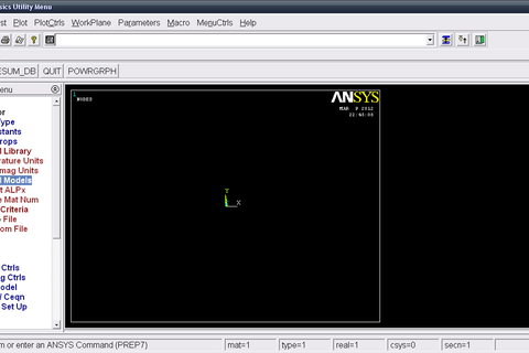

    7. Step 7

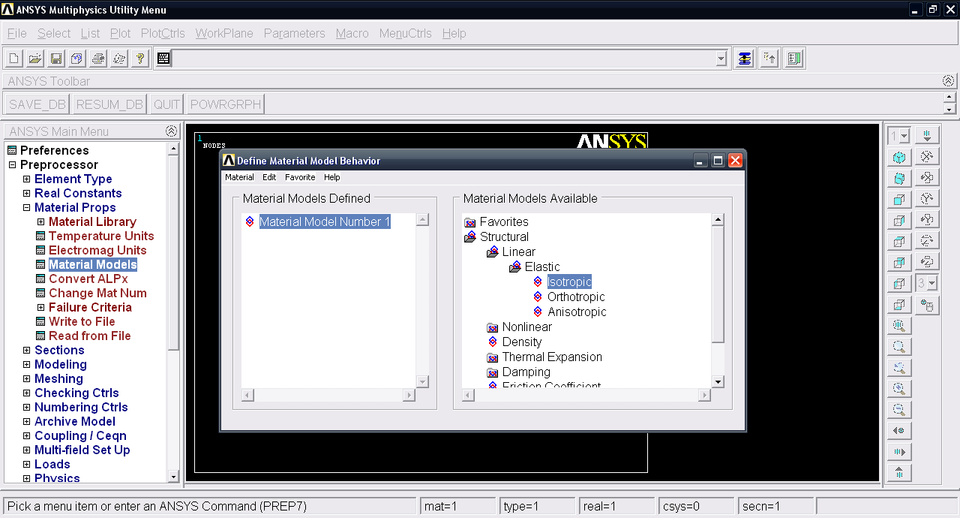

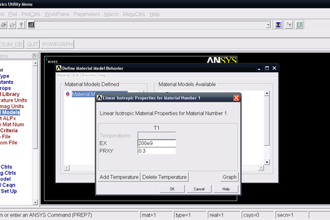

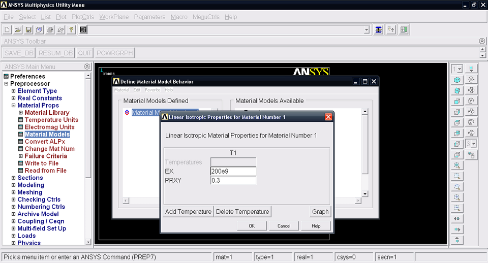

      Under Material Props >> Material Models.
      Medium

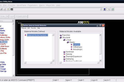

    8. Step 8
      Under Structural >> Linear >> Elastic >> Isotropic.
      Medium
    9. Step 9
      Input EX=200e9 and PRXY=0.3. Click OK and then close Material Model window.
      Medium

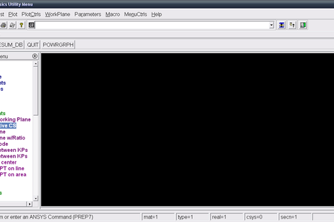

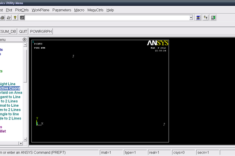

    10. Step 10

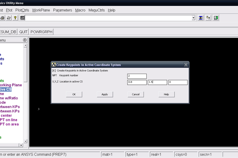

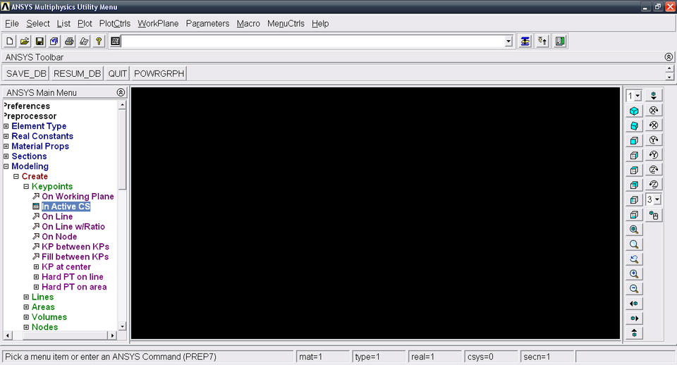

      Goto Preprocessor >> Modeling >> Create >> Keypoints >> In Active CS.
      Medium

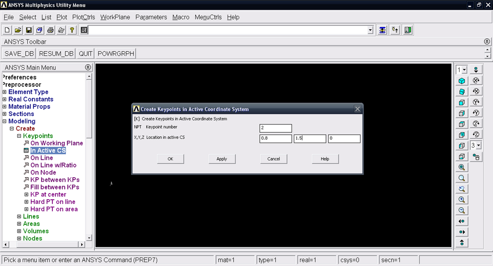

    11. Step 11
      Input Keypoint 1 = (0,0,0)
      Medium

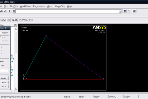

    12. Step 12
      Input Keypoint 2 = (0.8,1.5,0) & 3 = (2.8,0,0)
      Medium

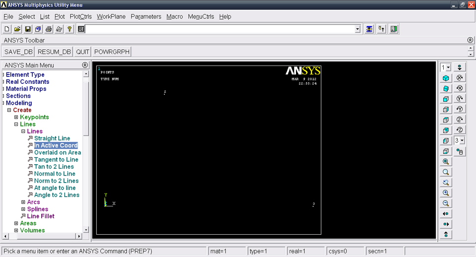

    13. Step 13

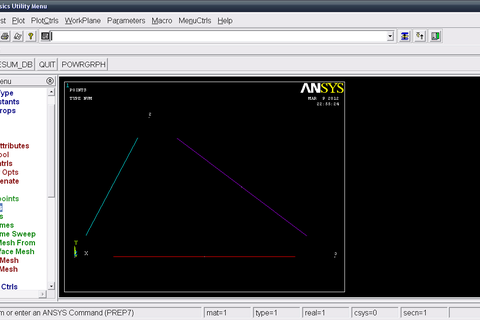

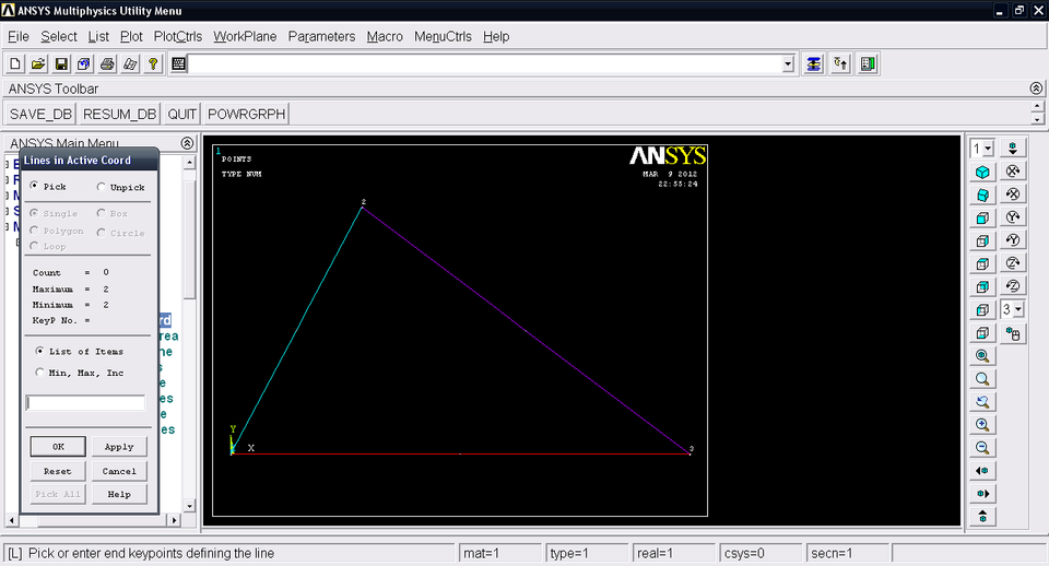

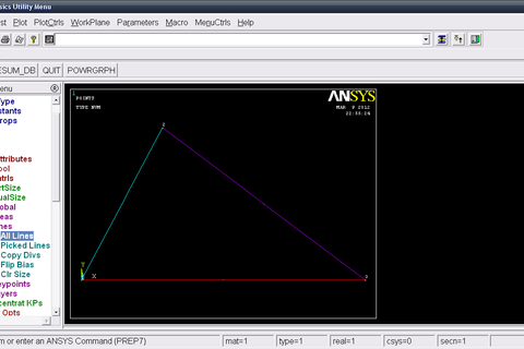

      Goto Modeling >> Create >> Lines >> Lines >> In active Coord to create lines.
      Medium
    14. Step 14
      Select keypoints and create lines. Click OK after done.
      Medium

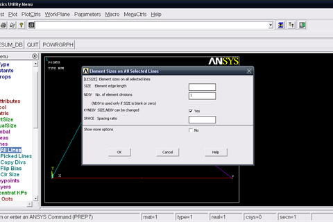

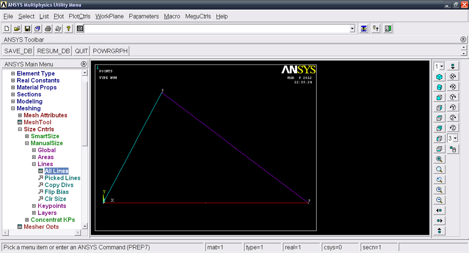

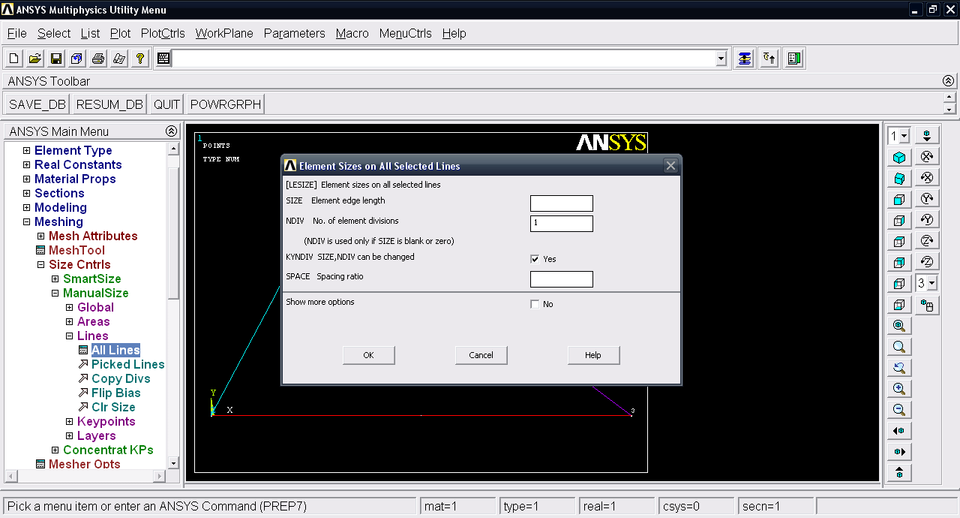

    15. Step 15
      Goto Meshing >> Size Controls >> Manual Size >> Lines >> All lines.
      Medium
    16. Step 16
      Input No. of element divisions = 1. Click OK.
      Medium

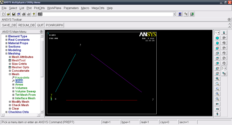

    17. Step 17

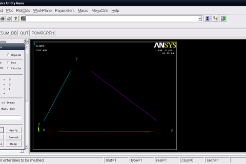

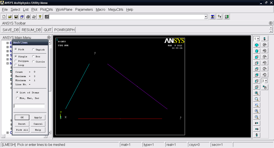

      Goto Meshing >> Mesh >> lines.
      Medium
    18. Step 18
      Click Pick all.
      Medium

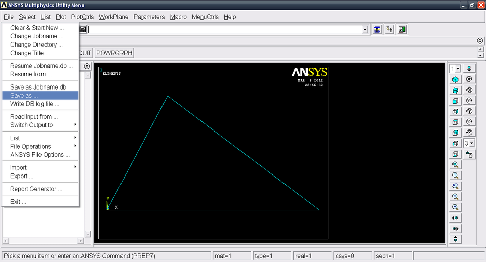

    19. Step 19

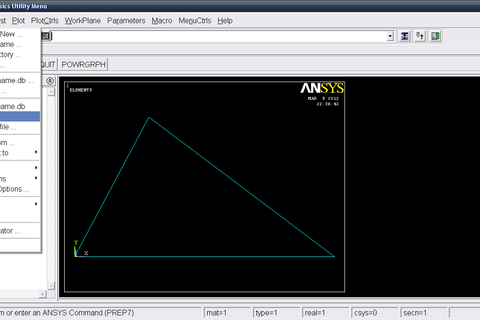

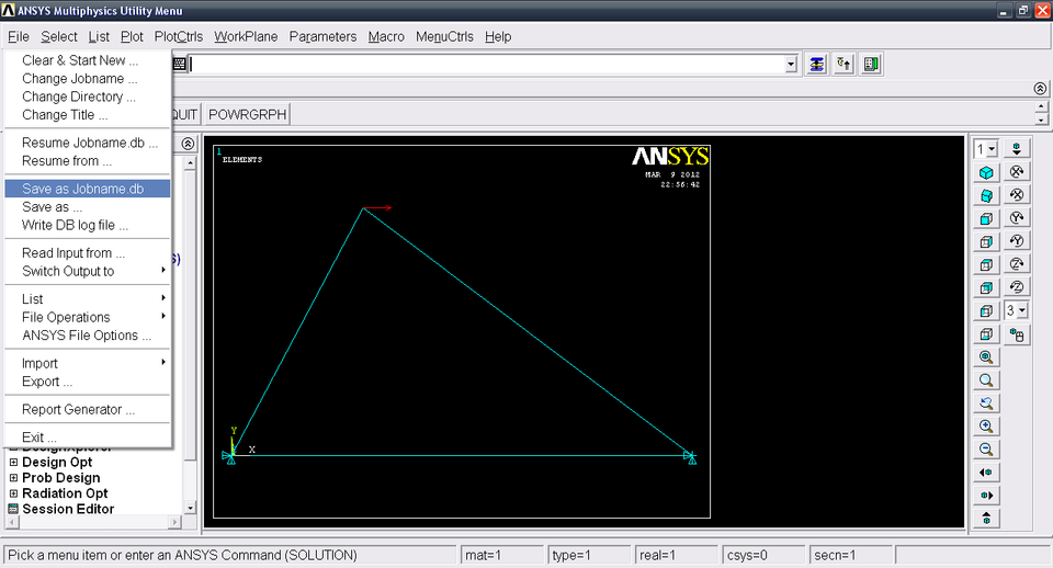

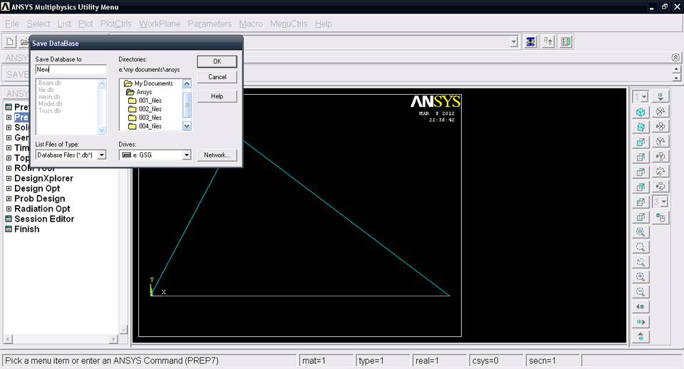

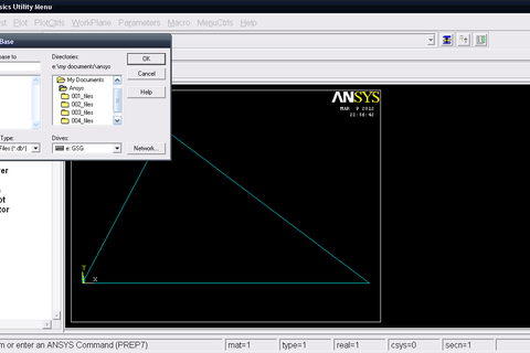

      Now save the job. Click File >> Save as.
      Medium
    20. Step 20
      Save the job.
      Medium

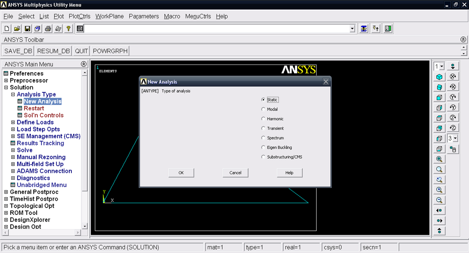

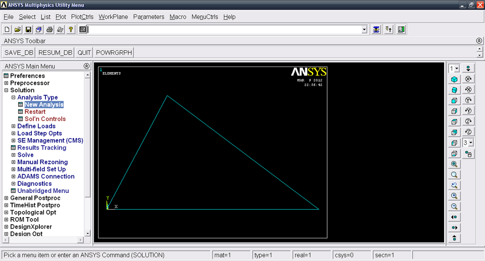

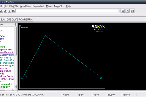

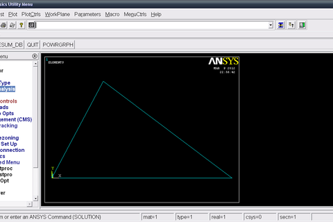

    21. Step 21

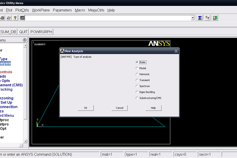

      Under Solution select Analysis type >> New analysis.
      Medium
    22. Step 22
      Select Static and click OK.
      Medium

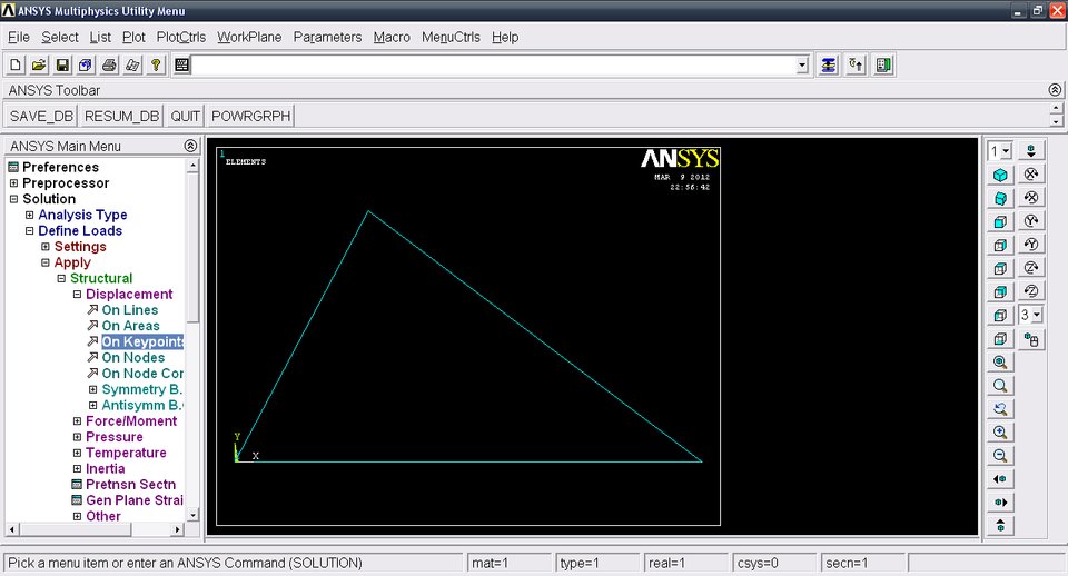

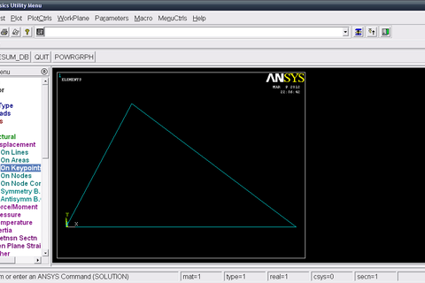

    23. Step 23

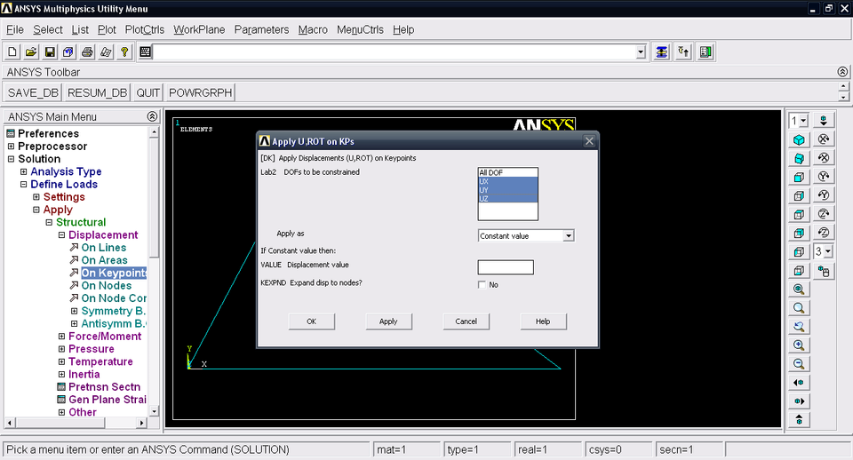

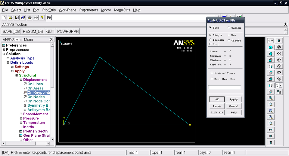

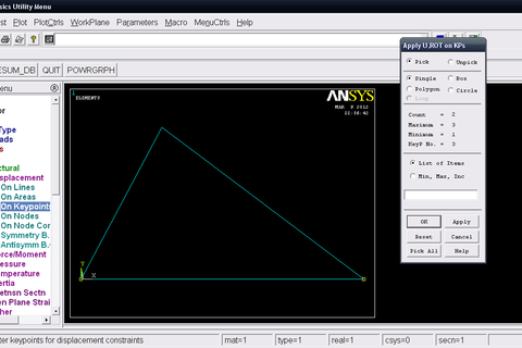

      Goto Define Loads >> Apply >> Structural >> Displacement >> On Keypoints.
      Medium

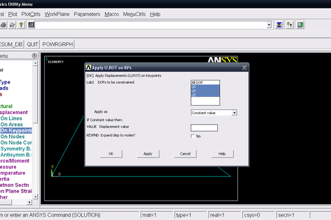

    24. Step 24
      Select both keypoints.
      Medium
    25. Step 25
      Select All UX,UY and UZ. Click OK.
      Medium

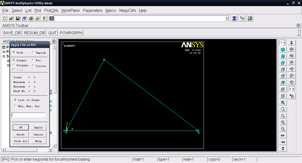

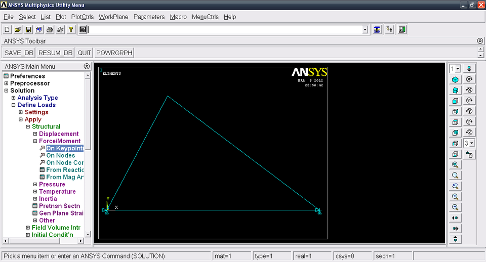

    26. Step 26

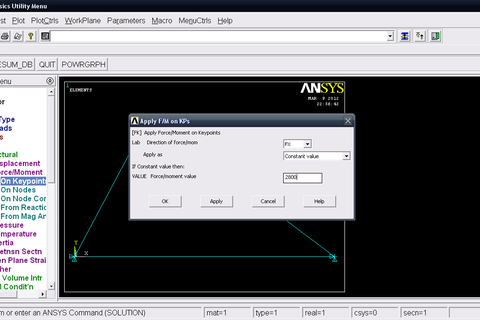

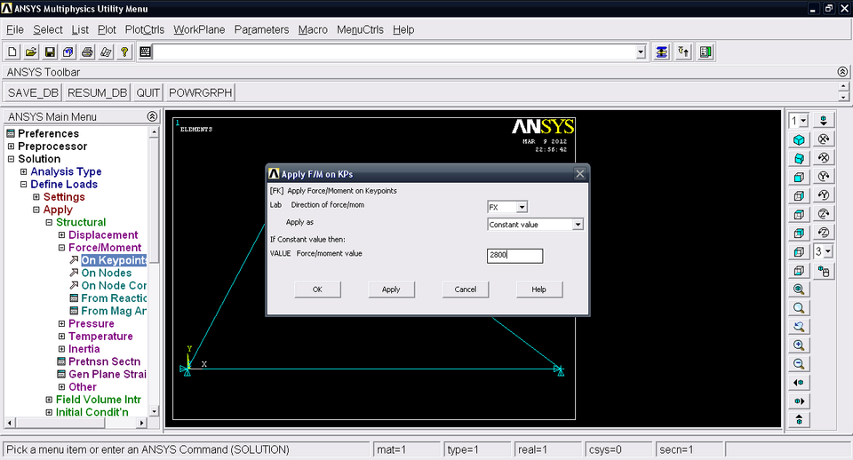

      Goto Define loads >> Apply >> Structural >> Force/Moment >> On Keypoints.
      Medium

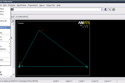

    27. Step 27
      Select the top Keypoint. Click OK.
      Medium
    28. Step 28
      Input Force = 2800. Direction be FX. Click OK.
      Medium
    29. Step 29
      Now save the job.
      Medium

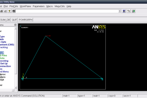

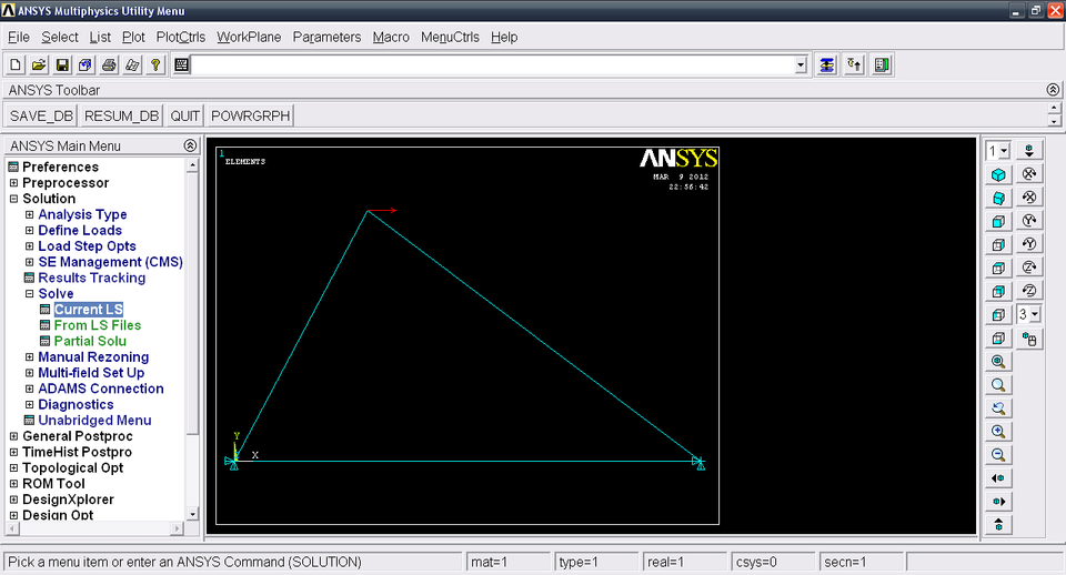

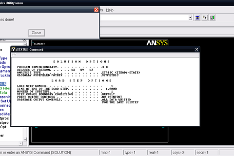

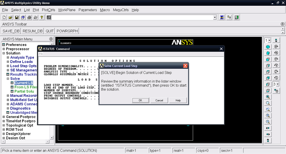

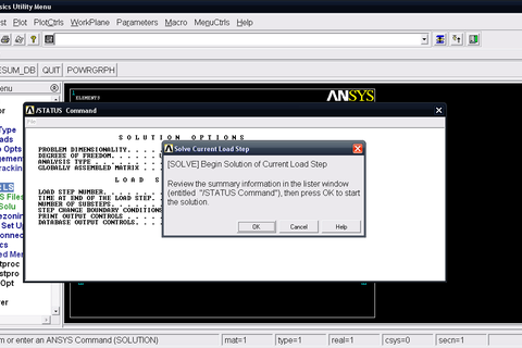

    30. Step 30
      Goto Solution >> Solve >> Current LS.
      Medium

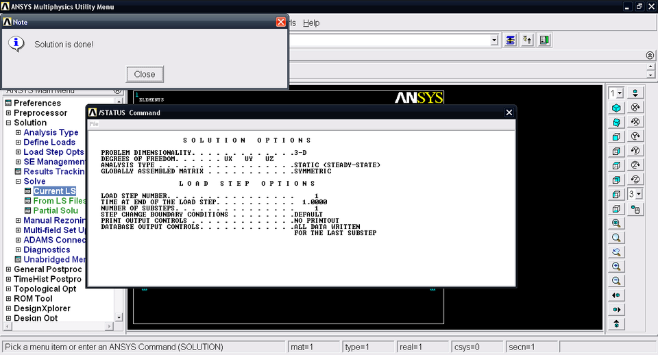

    31. Step 31
      Click OK.
      Medium
    32. Step 32
      Click Close.
