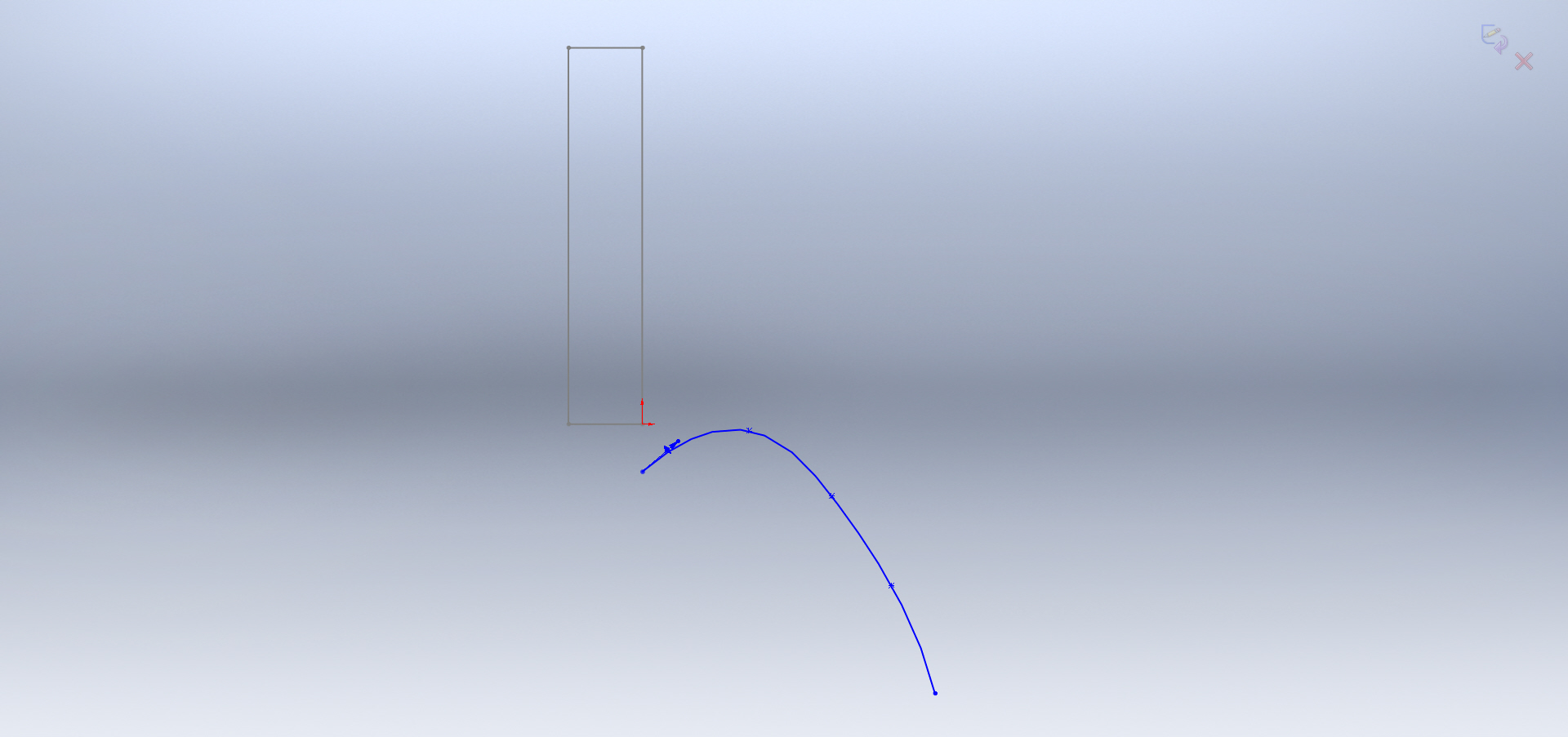

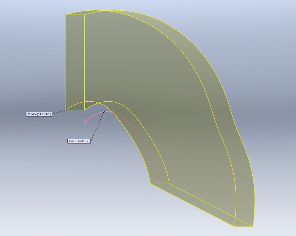

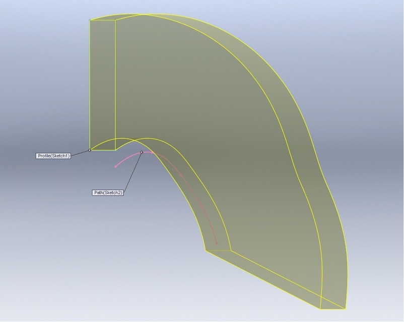

    I disagree somewhat. I've made plenty of sweeps where the profile and sweep do not physically intersect. They do have to have a similar starting point such as a plane. I'm not sure what is being described as "perpendicular", but you certainly don't have to have the profile and sweep perpendicular at the start. The only time I know that it is critical to have your profile and path coincident is when you have a 3D sketch as your path.
    Added images
    Square Square
