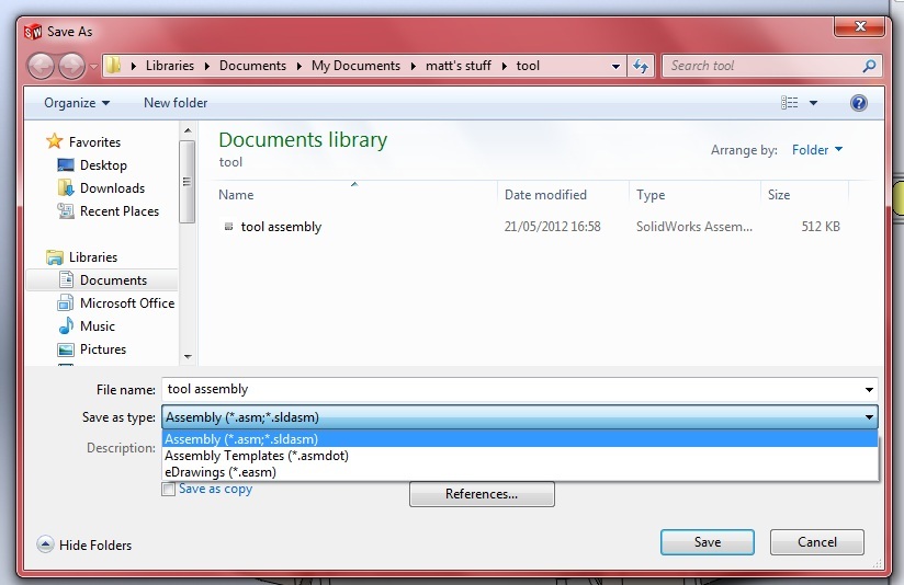

im currently making a model on solidoworks 2011 and would like to save it as an stl file but it isnt coming up when i click "save as type". i was just wondering why this isnt working? anybody got any clues?

    It might be that you're running a limited version of SW?
    Or I know that you can't stl a file if its not a solid body (i.e. a surface model), but I think it will still give you the stl option in the save as menu.

    thanks for the help guys but its still not working, ill add a print screen to what i see in the save box
