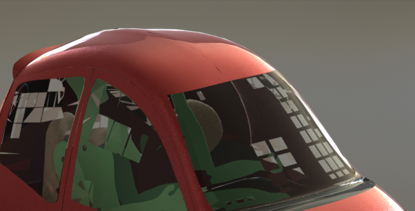

I'm getting bad results with photoview 360 (solidworks rendering tool) on glass materials. It comes with a mosaic view. What can i change on it?

    increase rendering quality
  • Sudhir Gill
    Sudhir Gill over 1 year ago
    these are reflections...try changing scenes...(for eg. 3 point faded...)
    as you can also see there are some reflections on these glasses...

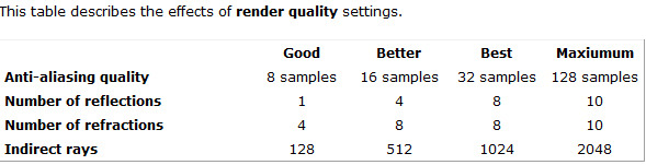

  • Arthur Young-Spivey
    Arthur Young-Spivey over 1 year ago
    Also here is something I posted as a stand alone but can just as easily be helpful here...it gives a direct understanding what each setting changes
