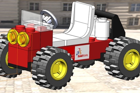

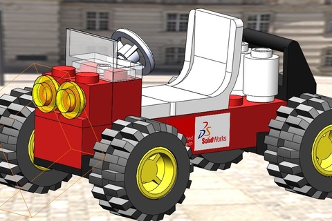

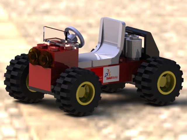

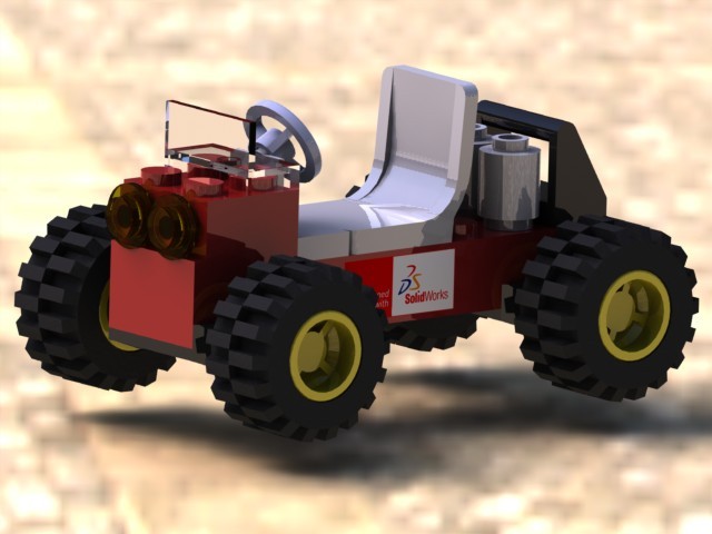

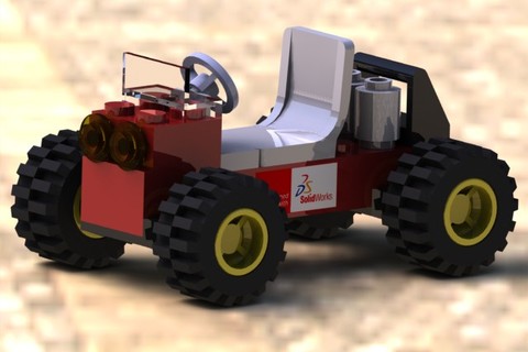

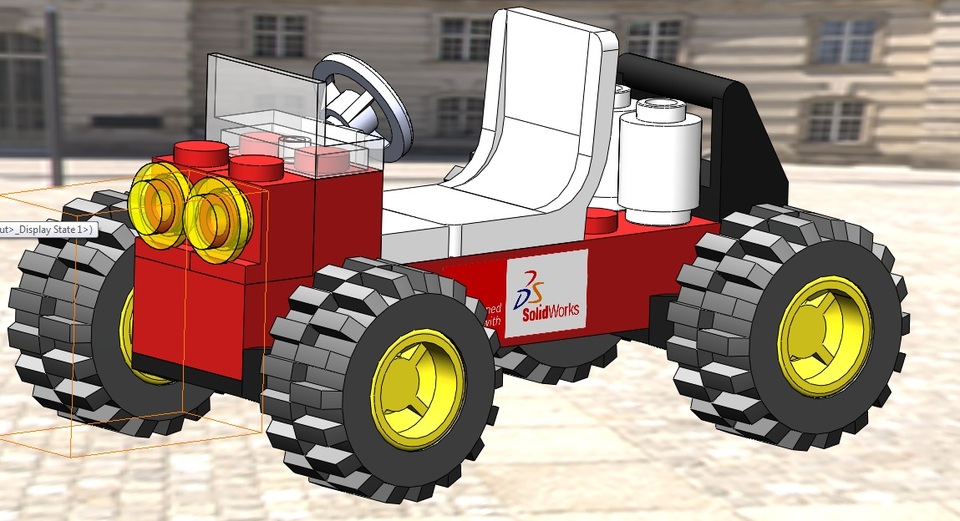

Why when I try to make a render of a car it looks like it's floating?
2 Answers

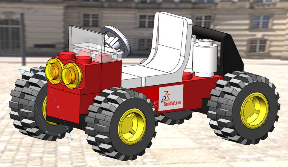

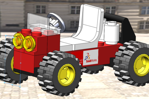

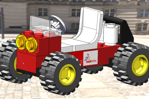

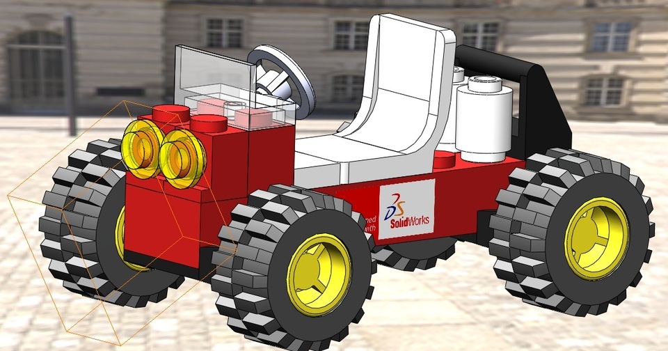

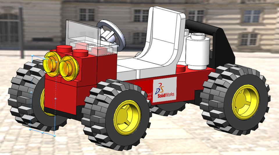

When you select a part, it turns blue (or green or orange) but that's not only what happens, if you check closer you'll see, that ther is a orange wireframe cube around it, and that's it, that's why your floor looks below the part.
