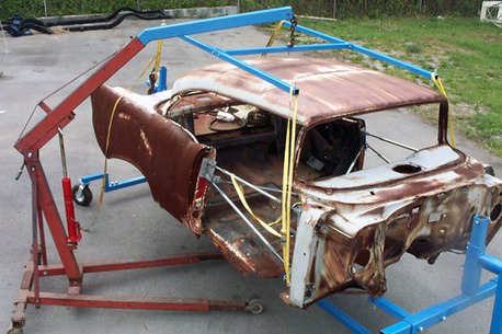

Body Lift to fit engine hoist.

    Thanks. Some more photo's at
    http://www.accessiblesystems.com/bl.php

    Cheers that's great, how accurate does it need to be? Nice idea btw!

    The boom piece is 2" x 4" - 4' each .25" thick wall. The H part is 2" x 2" - 3/16" tube. The two side peieces are about 6' long and the center peice is about 5' long. The center piece uses angle iron weld to the ends about 5" long, to bolt to the side peices. 3/8' bolts. I'm guessing the boom pieces are welded at about 45 degrees angle. The chain is 3/8"+ links. There are eylet bolts 3/8" on all four corners.
    Thanks.

    Hi Rich, had a go at a model for you, hopefully this is helpful to you:
    Car Body Lifter
    If you let me know what you think and any mods you want and I can do you a final version. Cheers, Andy.
