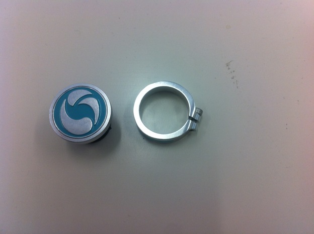

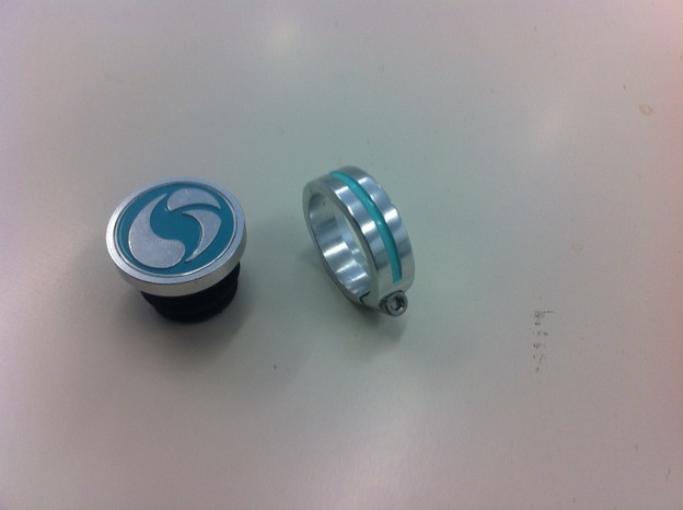

Refer to current drawings for the designs of the two existing parts.
The real challenge is the end plug/cap which currently has 2 issues. The existing solution is a standard bar tape end plug with a CNC cap glued to it. The whole plug can be knocked and come loose or be lost, and the outer cap can also be knocked off the inner plug and similarly become loose and get lost. Any type of glue fixing between the two parts will not work long term. Our initial thought for the new solution was some kind of expander inner plug to lock the tape into the bar with a cap that threads on over the top. Entries can either work on a refinement of this theme or a completely differant approach.
The finishing ring at the other end of the bar tape has less technocal issues but needs to be aesthetically matching the end plug and needs to both securely fix the end of the bar tape in place and its self to the bar.
Requirements
  • The End Plug holds the bar tape in place and should be able to be both locked and unlocked
  • The End Plug has an outer cap concealing the internal plug and locking system which must be removeable but not come off under use
  • The End Plug has the ability for laser etched logos on the outer cap face
  • Finishing ring to fix end of bar tape in place and its self to the bar
  • Both parts are to be seen as parts of a singular solution and be aesthetically matched
  • Material aluminium
  • We need versions for 2 different handlebar diameters 22.2mm and 23.8mm
  • Please see cad files attached
