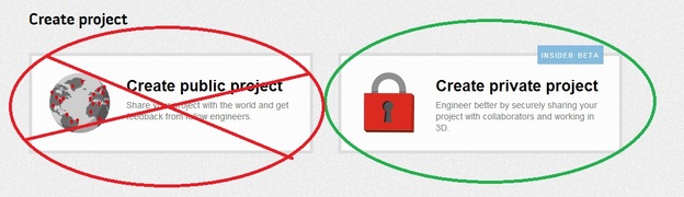

PLEASE NOTE THAT ALL THE ENTRIES HAVE TO BE PRIVATE. SEE RULES AND PICTURES BELOW FOR MORE INFORMATION.

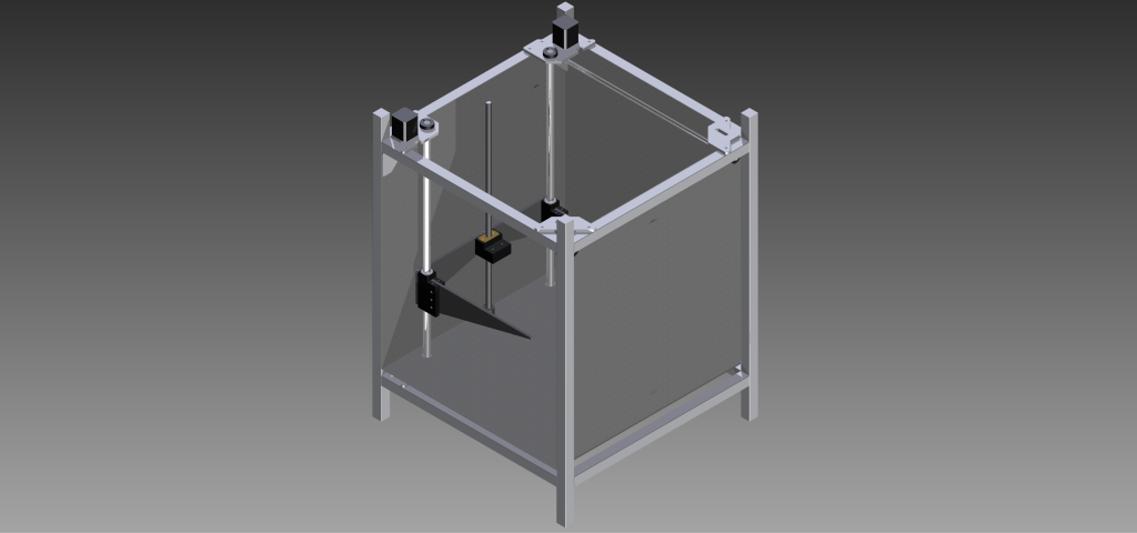

  • The STEP file shows a prototype version of the machine with mounted panels that are bolted onto aluminum extrusions. The ENTIRE design needs to be CHANGED from a bolt-together chassis to an elegant stamped and folded SHEET METAL design with good structural characteristics and manufacturability kept in mind.
    PLEASE SEND AN E-MAIL TO challenges@grabcad.com for getting the STEP file.
  • The holes for the linear rods, the stepper motors, and channel cutouts inside of the inner shell must be maintained, and a spacing of 25mm from the internal shell of the machine, to where the outer panels mount, is needed for routing wires inside the machine. The linear rods and motors are load bearing, so the mounting points need to be able to withstand up to 100lbs force without issue.
  • The electronics will be housed at the bottom of the machine, and power will be brought in from the rear - a shelf 125mm tall and comprising half the length of the machine is needed for mounting everything.
  • There need to be four chambers for filament spools, that are accessible from the outside of the machine, that are environmentally sealed. The filament will feed through a tube to an extruder motor of which a STEP file of a mockup is included, which needs to be mounted inside of the machine close to the filament chambers. The filament spools need to be able to rotate easily inside the chambers - resting atop ball bearings is recommended.
  • The machine needs to have a large door with a viewing window to be able to see the model while it's being built. It needs to be weather sealed so the interior environment is fully isolated from the exterior during printing. An exhaust fan 80mm to 120mm needs to be included on either the top of side of the machine with room for a 6mm thick air filter to slide in tightly.
  • The front of the machine will also have an LCD, and on/off switch. The rear will have a standard computer power inlet. The design should focus on stamped sheet metal, with consideration given to cost when choosing metals (IE: Brushed stainless steel is nice, but fairly expensive in comparison to aluminum or powder coated steel). Covers for the filament chambers can be made from injection molded plastic, if desired.
  • The machine is equipped with a 4.3” Diagonal LCD. The LCD module is 67.3 x 105.34 x 4.15 mm^3, with a 53.86 x 95.4mm^2 viewing area, and should have 20mm of clearance behind it for mounting electronics.
    There is a standard ATX Power Inlet at rear of the machine.
    Spools are 200mm OD, 51mm ID, and 73mm thick, and weigh about 2.5 lbs. Take this into account when designing your mounting point so you don't warp or bend the metal.

  • Only private entries are accepted in this Challenge. Send an e-mail to info@grabcad.com and request for an access to upload private models.
    Uploaded models must be shared with kaspar@grabcad.com, sara@grabcad.com
    and challenge@layeredlabs.com

  • bj
    bj almost 13 years ago
    In the model I see support arms, but no tray or nozzle etc. It would be nice for rendering to add these but you dont want to give away too much detail of your product? What are the sizes of the filament spools and where to they go approximately? Where is the STEP model of the extruder motor?
    bj has uploaded 75 CAD models & has left 128 comments.

  • Igor B
    Igor B almost 13 years ago
    The step file I received contains only two nema17 motors and one nema23 motor. I guess those three are for x, y and z movements. In that case the extruder motor is missing. Is it in a separate STEP file and if it is can you please share that file as well? Are we supposed to position the extruder motor and thus the chambers anywhere we want? Do you permit changes to the inner shell? Is the inner shell made out of sheetmetal?
    Igor B has uploaded 7 CAD models & has left 29 comments.
  • Layered Labs
    Layered Labs almost 13 years ago
    Hello Everyone,
    You should be receiving some updated files here soon. The answers to the questions posed so far are below:
    The placement of the extruder is up to the contestants. Filament from it is delivered via a 4mm OD tube to the top center of the machine to a mounting point that cannot be shown currently, but is on level with the horizontal rods. The length of that tube needs to be minimal (so don't mount the extruders at the bottom of the machine and send a tube all the way to the top). You can see the tubing in the actual photograph of the part.
    Filament spools are 200mm OD, 51mm ID, and 73mm thick. There are four of them on the machines. We leave the mounting point flexible to the contestants, though we originally envisioned two spools on each side of the machine inside isolated canisters that functioned more or less like a Nikon lens cap, or being behind a sealed door. The filament tube would extend into the canister for loading, up to the motor drive, and then from the motor to the top middle of the machine.
    The inner shell of the machine can be modified (And should be! We want a stamped sheet metal design, not a bolt-together open frame, after all!). The only important portions there are the relative positioning of the holes and motors from one another (where rods, motors, etc. mount), and the build envelope to be maintained. The key with the mechanical design is manufacturability - something that's relatively easy to create by machine and isn't heavy on manual labor during final assembly.
    If anything is unclear do let us know!
    Layered Labs has uploaded 0 CAD models & has left 15 comments.

  • Layered Labs
    Miguel Riego: Naturally we're only at liberty to discuss things related to the design challenge directly.
    I don't understand your question regarding the filament housing - the spool dimensions are posted above, and you can choose were to place them, be it on one side (or sides).
    The 25mm gap is for routing wires out of the bottom of the machine to the motors - provided that you have a means of doing this, you'll be OK.
    The larger motor can stick down into the electronics shelf.
