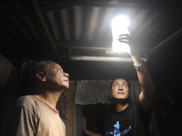

LED Light Bottle Design Challenge
Medium
Millions of people around the world live in darkness without access to lightbulbs and power. Within dense city-slums, windows are few and far between so people often open up a skylight in the roof to allow light in. A clever trick has been to place a 2L Bottle with water to disperse light and a little bleach to discourage microbial growth. Yet what about nighttime? What then? Perhaps an even better solution is a waterproof LED within the bottle, connected to a small solar panel and a battery system.
We have 4 LEDs, a single 7.5V 220mA Solar Panel, two NiHm batteries and a 2L Coke bottle. Using these components, design the casing for the LEDs so it can be inserted into the bottle, as well as the case for the panels and batteries. The designs will be made by our custom 3D Printer, a massive machine measuring 600 mm x 400 mm x 600 mm which uses similar extrusion techniques to the Makerbot.
For a deeper explaination of this project, read our blogpost on the project here - http://blog.grabcad.com/2012/09/new-challenge-design-an-led-light-bottle
For guidelines on designing for FDM 3D Printing, read this - http://wiki.makerbot.com/design-guidelines-for-makerbots
Requirements
  • Design around 4 to 6 Standard White LEDs, 2 batteries and one solar panel.
  • Don't design it with the solar panel above the bottle - it will block the light during the day! Design it so that it sits next the light bottle on the roof.
  • Don't worry about a light switch - we will likely be using whatever standard light switches that are locally available.
  • The best design would have the batteries underneath the solar panel in one case. Remember to leave space for wiring.
  • Design the screw cap for the bottle and the plastic case for the LEDs as one, 3D printed piece. The specs for the mouth of the bottle are in the specifications sheet.
  • The LEDs should be in the centre of the bottle, pointing downwards and to the sides.
  • Design for 18 Gauge Wire, which has a diameter of 1 mm.
  • We want to be able to assemble it easily by hand with an Allen key. Design around M4 socket screws and inserted nuts.
  • Remember that whatever you design has to be waterproof - we don't want anything shorting out!

    hey everyone i had a question after going through my design and going over the information given. take a look at the first picture in the blog article:
    http://blog.grabcad.com/2012/09/new-challenge-design-an-led-light-bottle/
    doesn't the cap look like it's glued onto the bottle? cement or grout perhaps? and if it is then is this the 'normal' way it is done? which then begs me to ask if replacing the bottle cap with the new assembly is the way to go?
    Ibrahim Sanih Ahmed has uploaded 12 CAD models & has left 86 comments.
  • JF Brandon
    JF Brandon over 5 years ago
    @Ibrahim Ignore that picture - its not what it will look like...its just one of the highest quality pictures I could find for the blog entry. We likely wont need to seal it with with anything...
