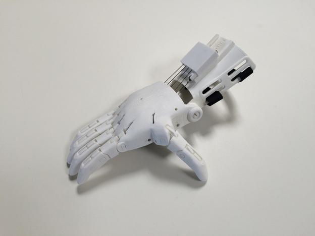

Below, please find a photo of The Phoenix Hand, designed by e-NABLE Community member Jason Bryant, as well as ICRC wrist units in three skin tones.
