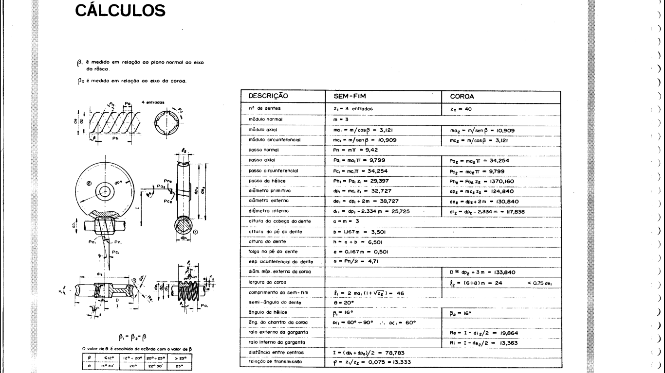

Hai, Is their a Standard formula to Calculate the Centre to Centre Distance between Worm and Worm Wheel in Worm Gear Setup.
 I have Tried by Calculating the sum of Pitch Dia of Both Worm and Worm Wheel Divided by 2, but I observed some interference between the worm and worm wheel. Is their anything else to add.
