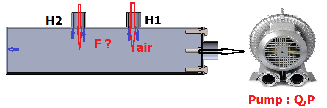

Hello i have a problem , i have an empty tank that include 3 Holes , 1 hole is for the pump and the two other are the entrys of aire ( see attached photo ) the pump have to aspirate the air on the tank , the pump have a depressure in bar and a rate of flow in l/min
I want to know the forces values created by this pump in the region of the two holes of air entry ( see the attached photo )
How to do this please thank you
I have attached the part also in this link : https://filebin.net/0yxhwkeb4fkkd94k
PS : I dont have a cad file of the pump i just want to simulate it by putting the depressure and the flow as simulation entries
You may calculate pressure on the surface in the tank. Pressure multiply on the square, and you have force
CREATE SEPARATE PARTS IN THE OPENINGS (ROUND AND A LITTLE OVERLAPPING THE DIAMETER) THESE ARE NOT THE LIDS YOU NEED FOR INTERNAL ANALYSIS.
IN COMPONENT CONTROL DISABLE CREATED PARTS AND THEN SET SURFACE GOALS ON SURFACES WHERE YOU NEED TO MEASURE FORCE.
