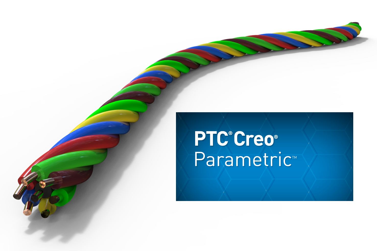

Creo 3.0 tutorial: How to create a Rope and Wires
By Vladimir Palffy on 11 Dec 20:40 2 answers 5241 views 0 comments
If you need to create a Wire or Cable you can use a lot of nice features with Creo Parametric 3.0 (Sweep, Curve from equation, Intersect etc.)
Here you can find the short video tutorial ...

  • sumanth  mandava
    sumanth mandava almost 2 years ago
    By using swept blend feature you can create a twisted rope but remember you can create more number of divided points for circles to get twist .
