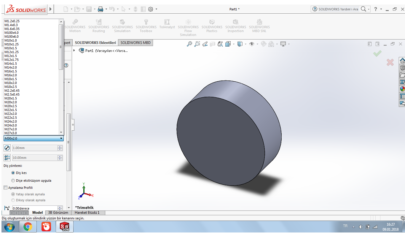

how ı can indenture metric 7x0,75 fine thread.In hole wizard,thread minimum size M10 .But ı need M 7.How ı c an adjust my solidworks ? thank you
3 Answers
Your list shown in your screenshot is not showing thread values from smallest to largest but by the number after the M... M1.2 then M100, M10, M12... M2.2, M20...
Scroll down.
The bottom is M30 so M7 would be blow that.
Comments 0
there isn't M7x0,75. there is only M7x1
Comments 0
there is the custom option, but you need to first calculate its size in mm unit
