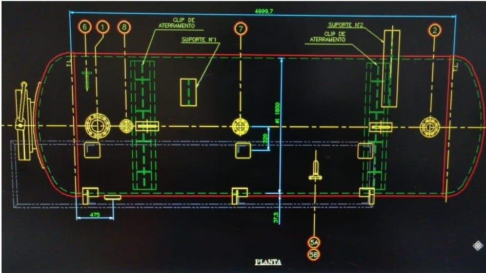

How to build a pressure vessel with elliptical heads using AUTOCAD?
I need to model a pressure vessel for caustic soda solution with a concentration of
10%, as per the drawing provided. The head is elliptical 2: 1. A design temperature is 70oC. The left flange is the manhole and has a diameter of 24”. Connections 1 and 2 are 8” in diameter. Like sets 5A, 5B and 6 and 8 are 2” in diameter. A 7 connection is 4” of diameter.
If you are looking for designing the curvature on the end caps I suggest:
https://www.engineersedge.com/calculators/Elliptical_Head_Design_Tool/pressure-vessel-elliptical-head.htm
or
https://www.pveng.com/home/reference-information/elliptical_head_design_tool/
Attached is a dimensional guide for SE Pressure caps. Other then that research building codes in either ASME or Boiler plate design.
As for drafting it in AutoCAD: Draft it the same you would in any drafting 2D software. I personal prefer Draftsight due to the low cost.
