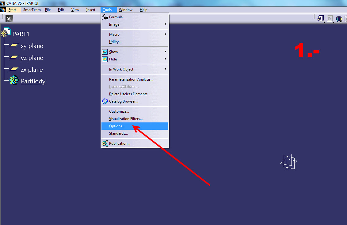

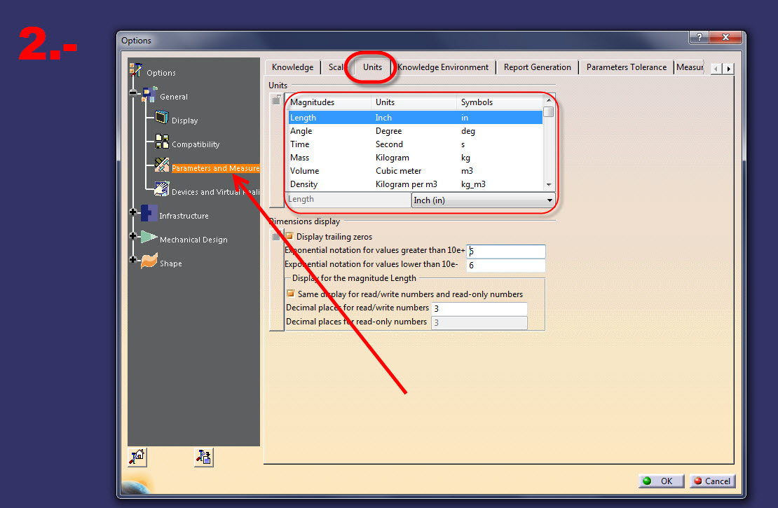

Hi friend good morning, I attach you some pictures, I hope with your issue, and if you can't just let me know.
Thanks so much, have a good day
https://www.youtube.com/watch?v=8lt9wNgsqOw
in this video you can learn how to change unit and other required settings for catia.
it is not possible to change unit without changing value.
