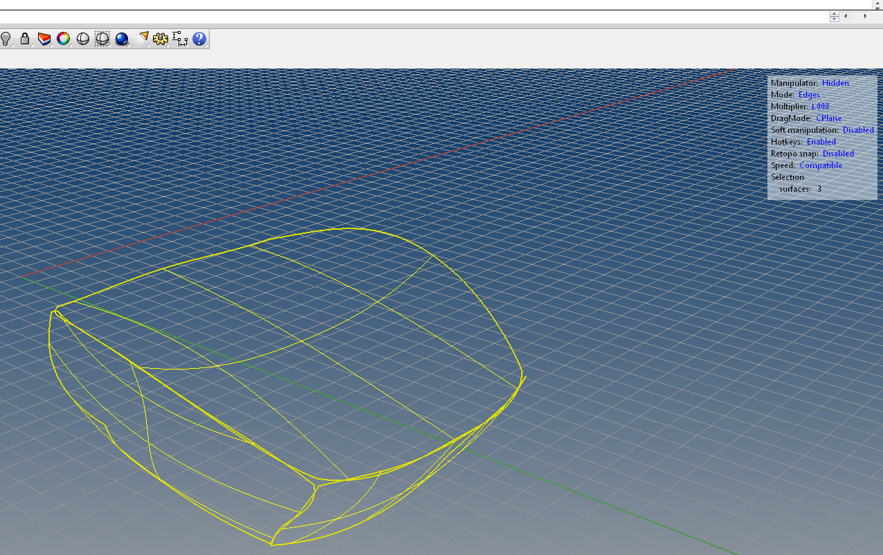

Whenever i want to smooth a corner containing 3 or more than 3 surface edges , it always gives some uneven fillet and leave a small gap between the surfaces..
How should i fix it.......????

Hi Prashant, this is quite an irritating problem that I actually learned how to deal with from imported surfaces with bad edges in SW.
Steps are as follows (numbering of pictures is sequential):
1.) Add your three fillets with Extend and Trim set to yes
(the last fillet will not extend like the first two)
2.)Turn on 'Int' snap and turn off 'End' snap
3.) Use 'geodesic curve' ( _shortpath) to make trim curves on the first two fillets ( the fillets that extend). Beware that the geodesic curve tool can sometimes be a little temperamental so check your output curves before continuing.
4.) Trim away the overlap such that you are left with a three sided gap
5.)Use Surface from Curve Network (_Networksrf) to fill the gap ( select the edges not the curves) with edge matching set to curvature
6.) Join the surface together to form a polysurface
